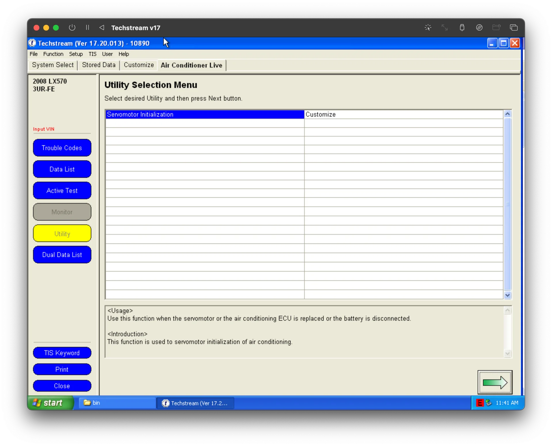

I think you still have a problem with the cabin filter door mechanism if you’ve had to fix that 3 times. I wonder if there is a crack or even a part missing you can’t see. I suggest going in there with the fix created by @Oakleyguy and repair it permanently. Then disconnect the battery for a few minutes and then do the HVAC servo reset in this thread.
Thanks for the information. I did disconnect the battery but I don’t have techstream. I guess I need to get it.

So I took it all apart and I can tell you the door and arm are in good working order. I can cycle the servo 5 time or more with it hanging loose and works perfectly. Then I reattach it and it works 4-5 times then stops working.
I disconnected the battery then did the servo reset with techstream but still isn’t working and the passenger side is still blowing cold on heat hi.

Pull the HVAC codes, then reset the HVAC codes. See if that fixes the issue. Sometimes even after fixing physical HVAC problems on Toyota/Lexus platforms you still have to do a reset before things start acting normal. It's super easy to do, see video below:
Codes are 42,45,46. I tried to clear it but the codes stay. Also I’m 99.99% the door and arm are not the problem. I have completely disassembled it and looked it over and it’s not broken.
