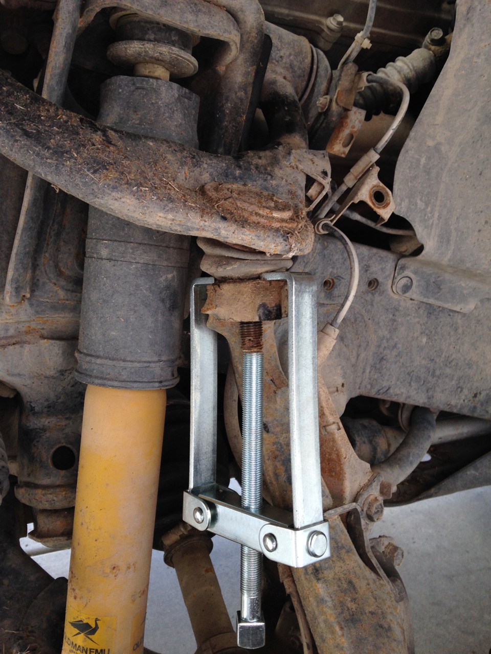

Out of laziness, I tried this one which I found at the hardware store within a mile of my house. No bueno. Bent beyond recognition quickly and caused more than a bit of swearing.

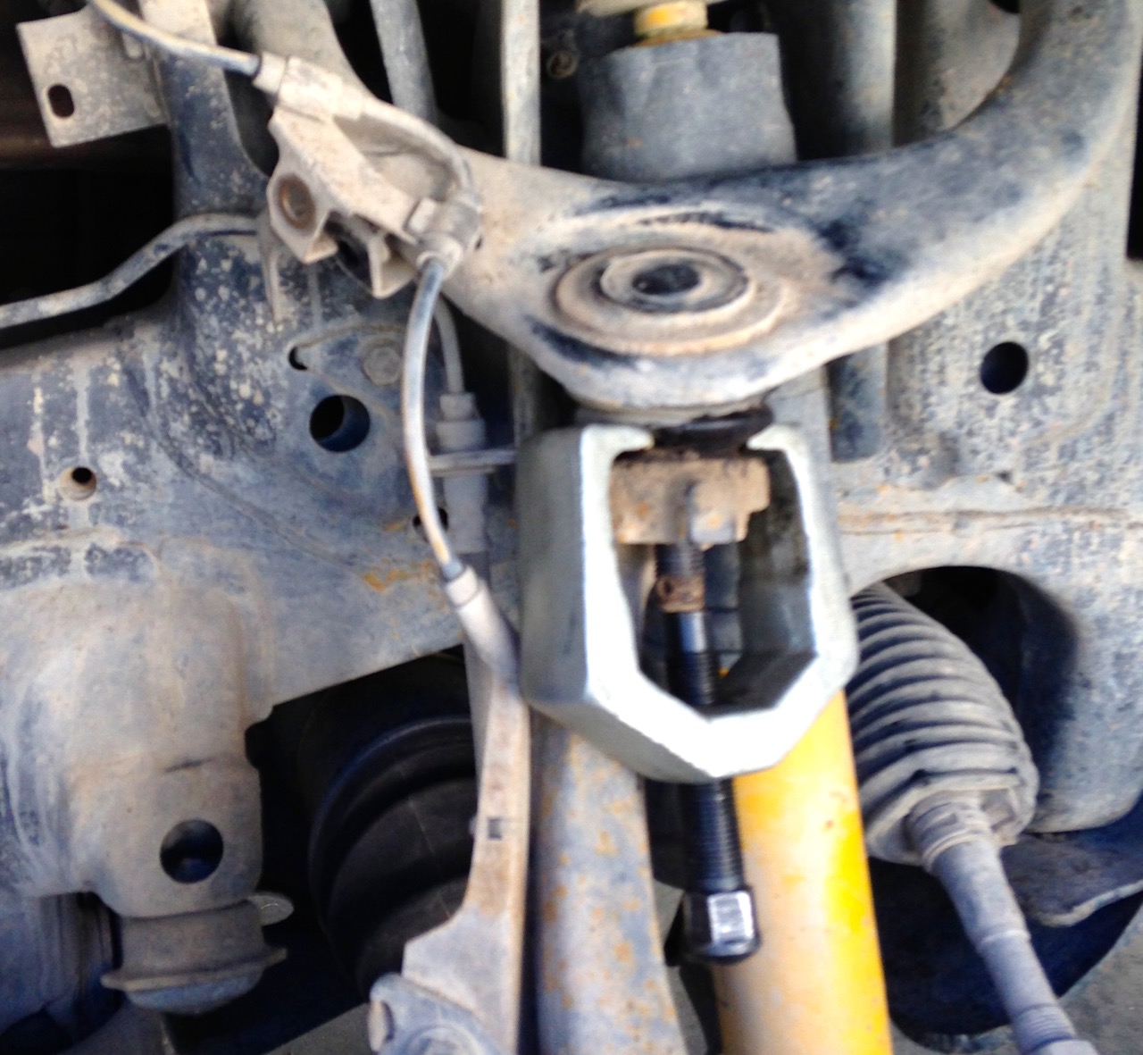

Then, I drove a few more miles to the nearest auto parts place that loans tools and got this one that did the trick easily. Sorry about the blurry pic. Not sure what brand it is, but I'm sure any of this style will work. Full disclosure: I also tried hammering, prying, fabbing up my own "tool", and other techniques that didn't work at all and cost me a bunch of time.

I i . . . .The hardest part was taking multiple trips to the auto parts store to get the right ball joint removal tool. . . . .
NO! No ball joint tool required. Special tool: BFH. The UCA is designed to separate with a hammer - see the lugs around the knuckle? Big hammer will drop the knuckle with 3-4 whacks (keep the nut on loosely).
When removing the adjustment bolts/washers, mark them so you can get the alignment back 'roughly' - then head to alignment shop first thing after replacement. Some of the bolts are easily accessible from the top.
^^^Not true for every 15yr old 100 that grew up in michigan at least. For me one side popped quick and easy, the other fought the puller/BFH/PB combo for at least 2 days of on again off again tensioning, banging, spraying, and cursing.
My 2-pound brass hammer worked perfectly for me - Just back off the nut, eat your Wheaties, and whack the side of the knuckle. My upper balljoint popped out on the third hit. Of course, my LC100 is a Socal rust-free model. Not sure how to follow the hammer method? Then check out this video.
