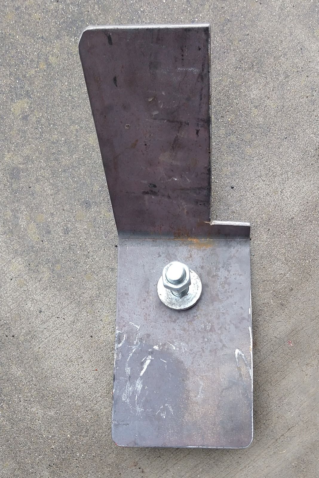

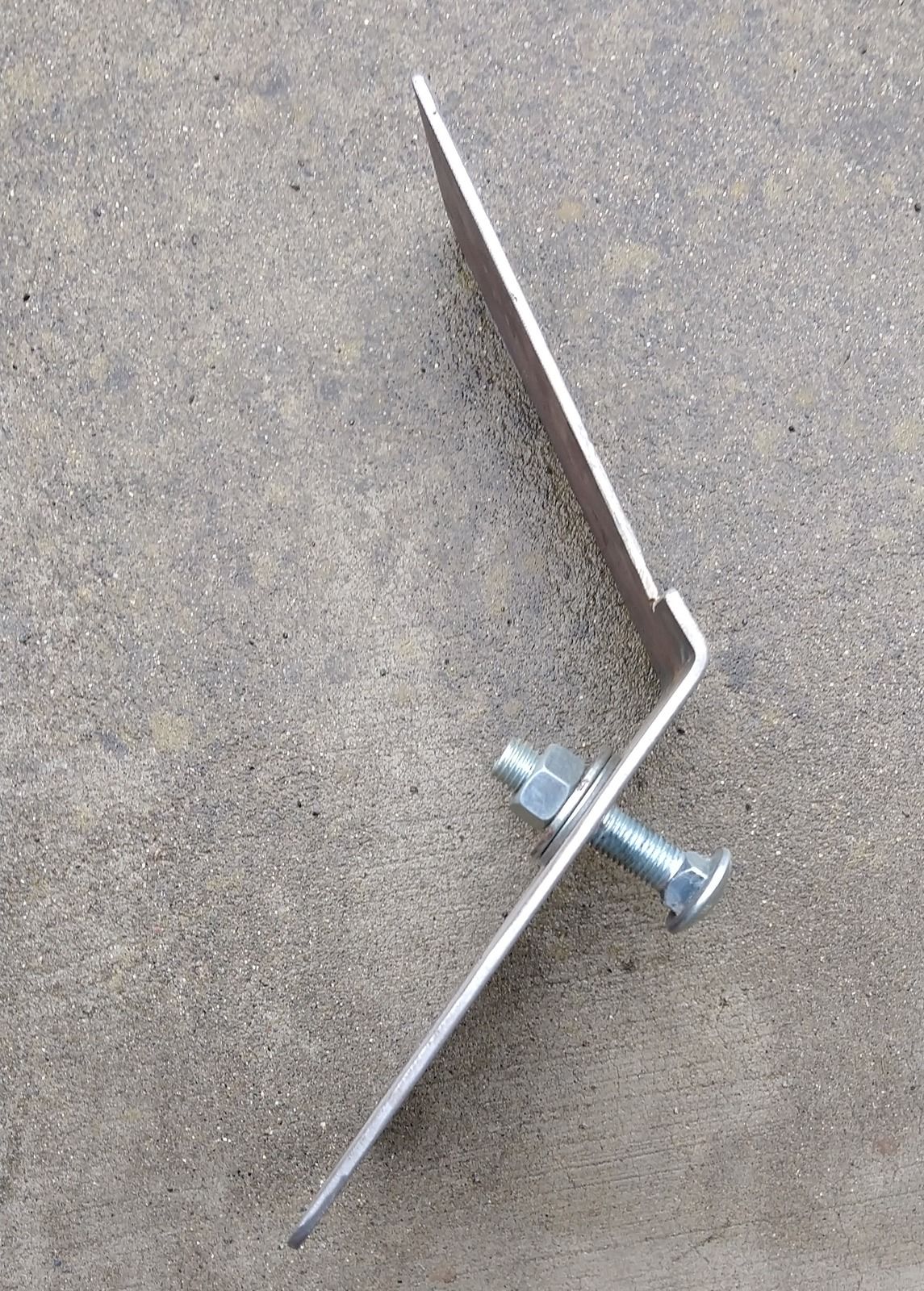

If you do decide to pull it, you can not balance it on the tcase flat bottom surface, the center of gravity is off to one side. Also it will torque over and bind making it very hard to pull off the transmission. I happen to have access to a press brake so bent some 3/16" steel to make a bracket for my floor jack. With it bolted to the floor jack and a ratchet strap around it and the tcase makes it pretty easy to handle. I think some transmission jacks could adjust to do the job also.
If you have means of supporting the tcase I like that way, if not doing on the truck is better.
