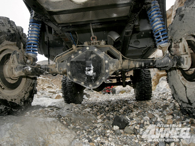

STOCK LAND CRUISER GROUND CLEARANCE
8.9 inches
Yes, because it's a SRA! Measured from the lowest point, which will always be the rear differential on a SRA vehicle. With a SRA, ground clearance is simply a measure of the size of the tires. I could put a crappy truck on 38's with a puny undersized differential and have 12+" of ground clearance. Doesn't mean ANYTHING.
See this heavily modified 1974 Ford Bronco with a 14-bolt??? Want to take a gander to what its measure ground clearance is???
But it sure is capable!!!
