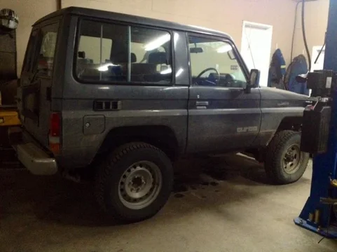

As near as I can tell The 70/73/74 are the same distance from the wheel opening to the back of the quarter. I believe the BJ70 wheel base is ~11 inches shorter than a 73/74.
If the 3 " is between the back of the door and the wheel arch---that is not a 73. That is the 70. the 73/74 is much longer
I do not have a 70 but this photo is a pretty good side view.

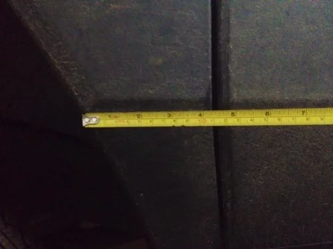

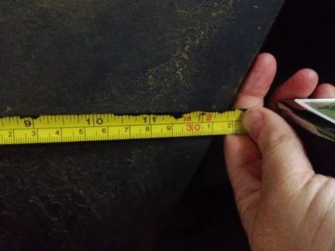

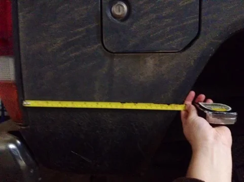

Just got outta bed to take these for ya. Hope they help. Truck is an 89 BJ71. I've been told it's the same as a 70.
1987 BJ74. ......... 15-1/2" ( measured along body crease )
If this isn't what you want just let me know and I can take additional photos.
We will be in the low 70's (F) by the weekend so weather isn't a factor. : )
