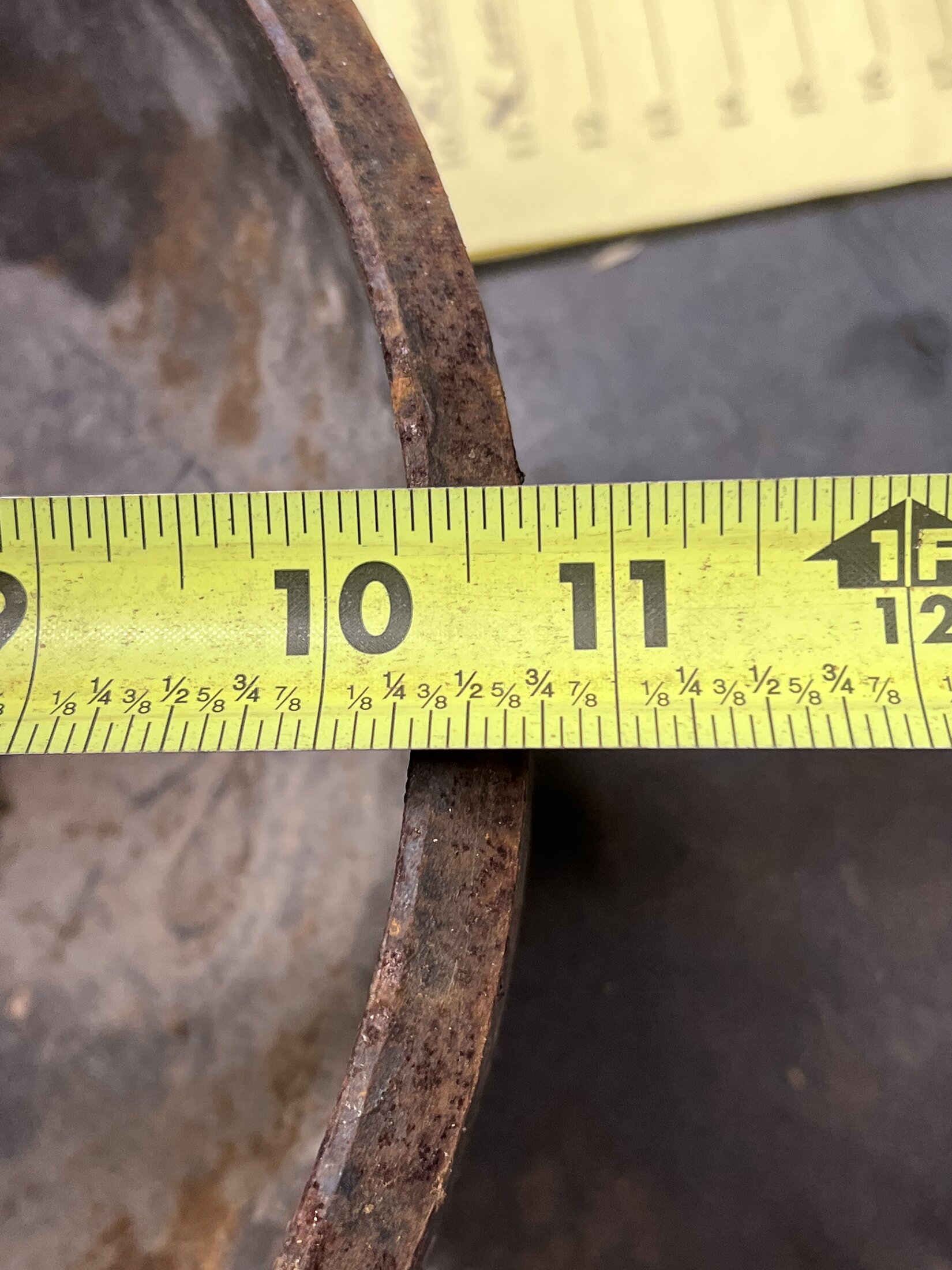

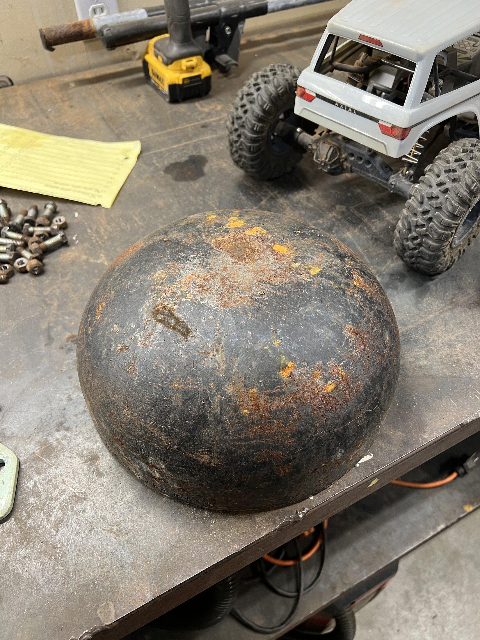

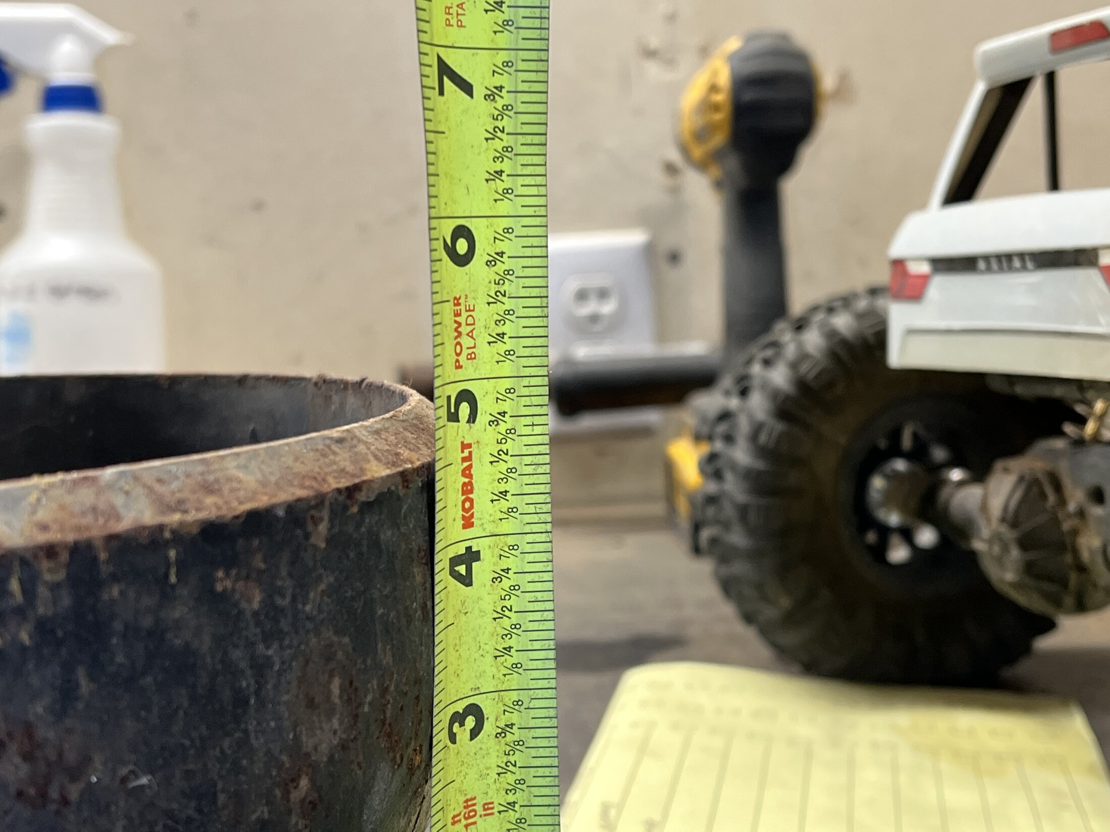

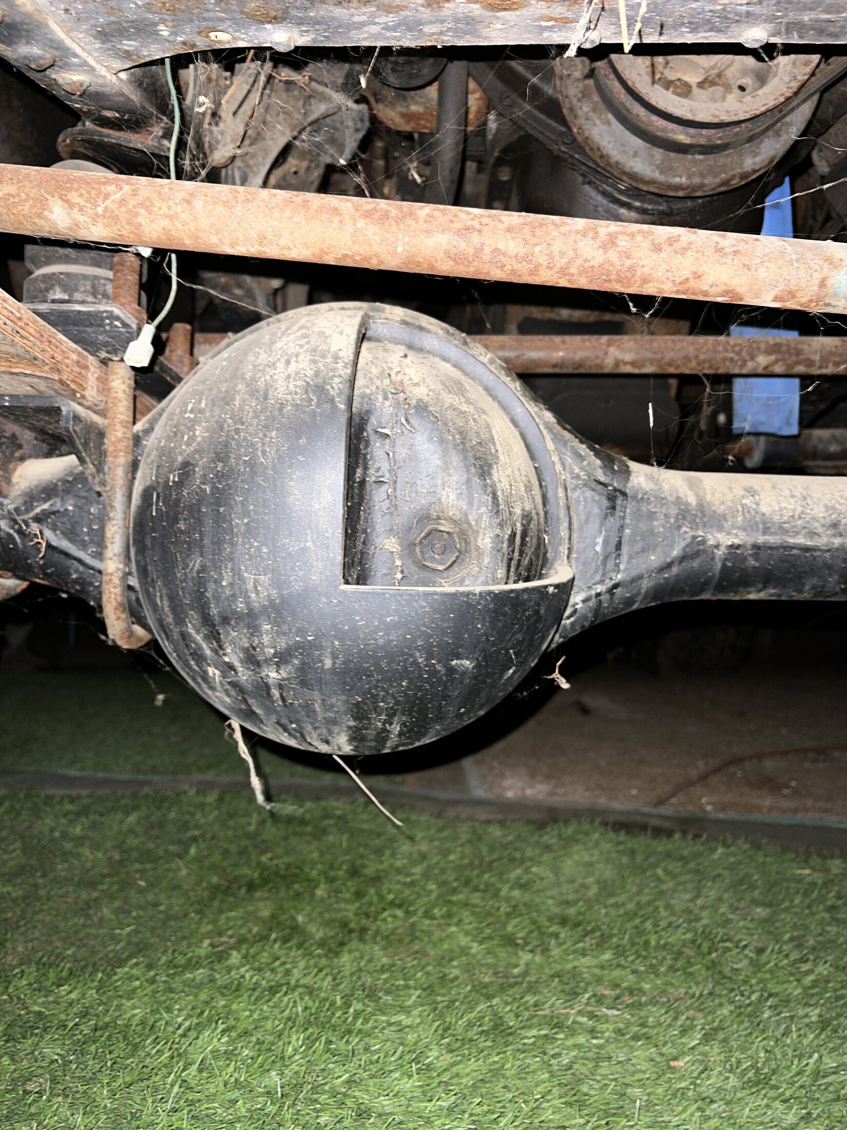

View attachment 3699382View attachment 3699383View attachment 3699384
