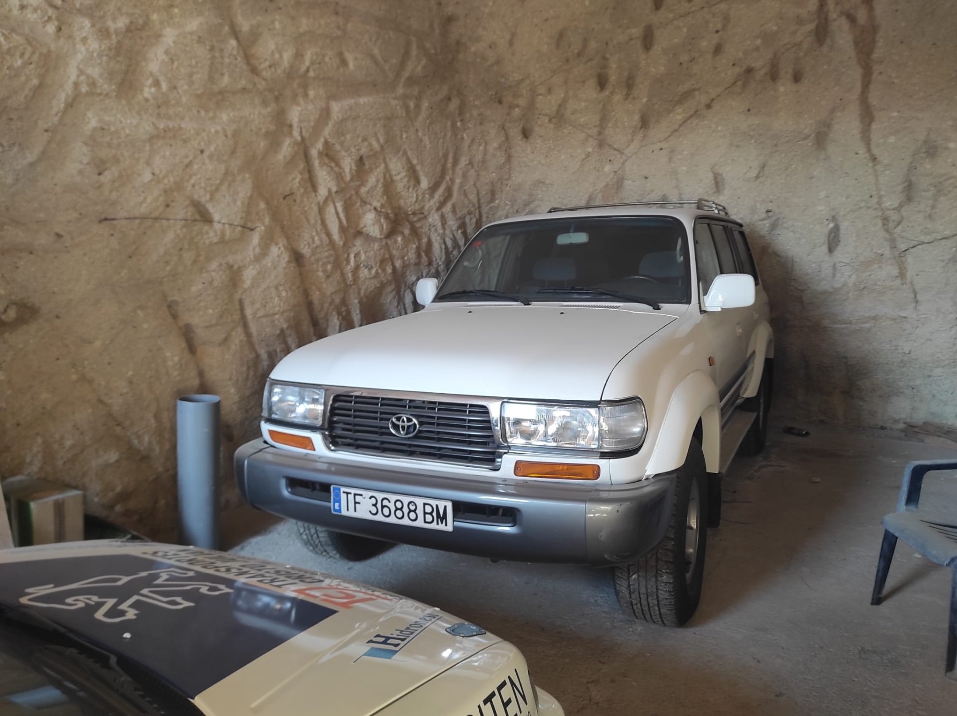

Canary Islands
A member who imported an 80 series from the above referenced importer and had a good experience.
