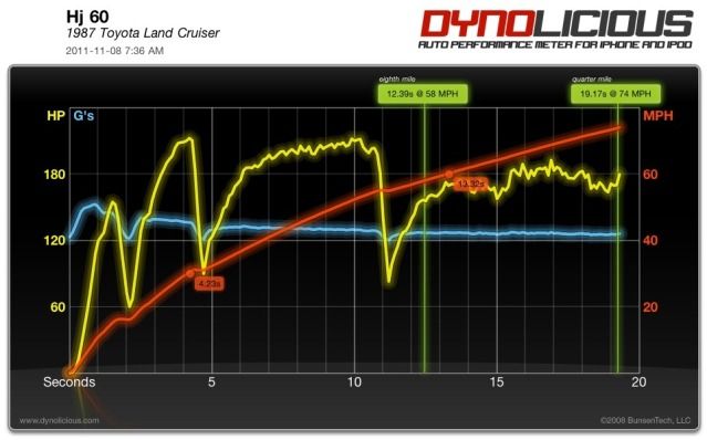

Here is mine
I entered 30% loss and at 6400lbs.
35s with 456 gears.
Any idea how accurate these are. Likely good for comparison more than anything. I hope someone does a stock hj 60 to compare

Damn that's impressive! My brothers Turbo 2H (auto) feels like its in the 20's. How much boost are you running and what turbo?
I'm running nearly 20 psi. More like 18 tops. That's also measured at compressor outlet and not after intercooler. Turbo is a Garret model with .6 exhaust and .48 compressor if I remember. 3 inch straight pipe.
I would like to run more boost and will once I try turning fuel up. Also thinking about timing advance.
I'm in 20 @ 60MPH at 14 PSI ( measured post IC at TB ) non methanol .. ( 40" MTRs / Marks t-case reduction and 4.56 R&P )

Everybody using dynolicious, make sure you calibrate it and set the tricker to .06g and 12" and everybody should use same drive train loss.
Im with you and gbentik on this one, most accurate results can be archieved without factoring drive train losses (shouldnt we get RWHP that way?)
Ya that all sounds good. I'll reset my setting and try it again tonight. I'm really more interested in the times than anything. I bet this is best used for comparison against yourself rather than truck to truck. But as we nail down variables we can get closer to comparison. Either way.... Way cool app
Or just not use the HP function and compare times and shapes of the acceleration curves instead.
