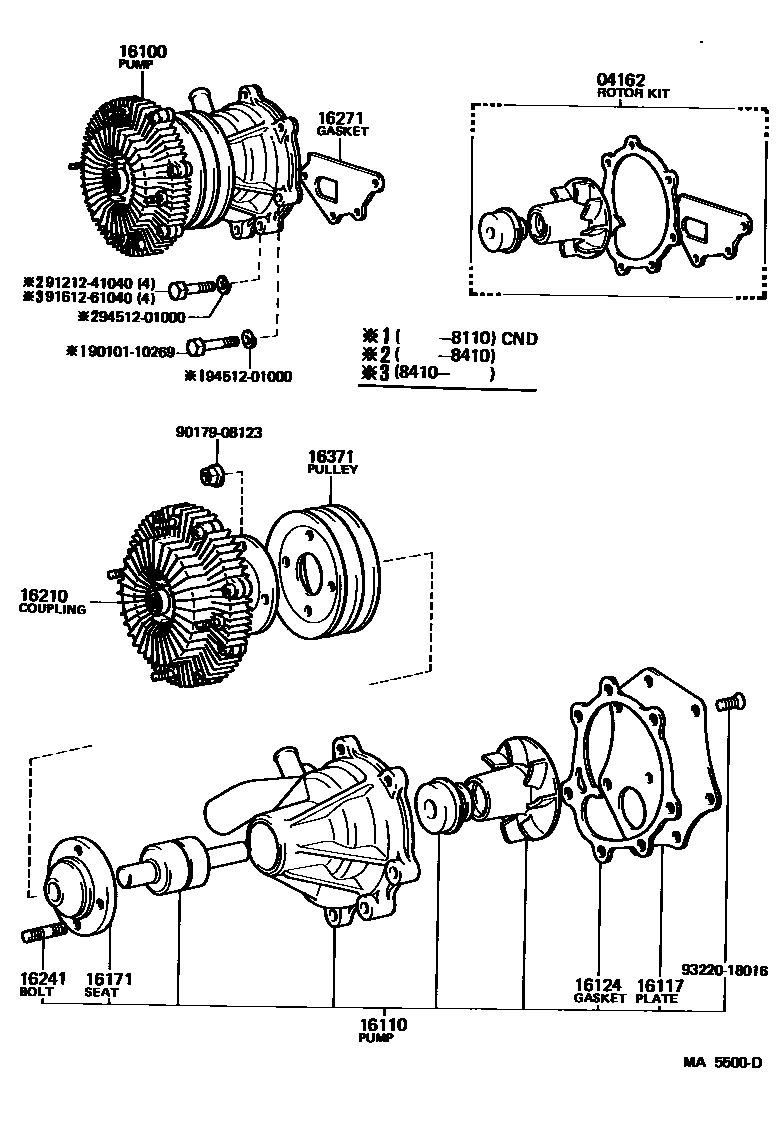

I took a look at this with @jwould . the 12mm nuts (p/n 90179-08123) on the pulley are definitely tight, and all the belts are new and recently tensioned. Possibly a lose bolt or the seat? Is the seat replaceable or a part of the pump assembly? Are the bolts a part of the seat too?

I think you should pull the clutch and pully off and see if you can find where the wobbling is coming from.
