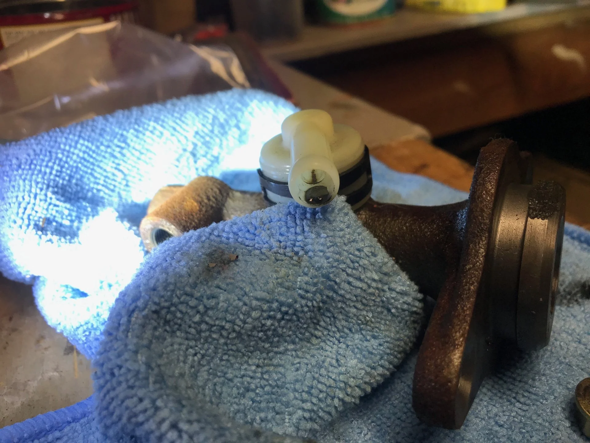

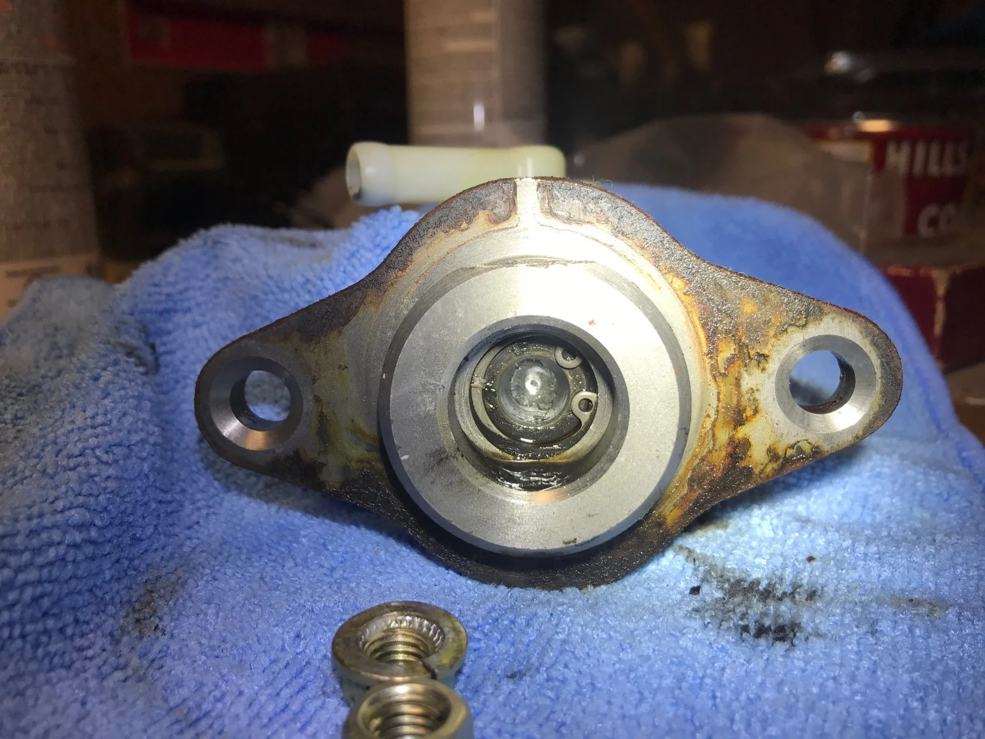

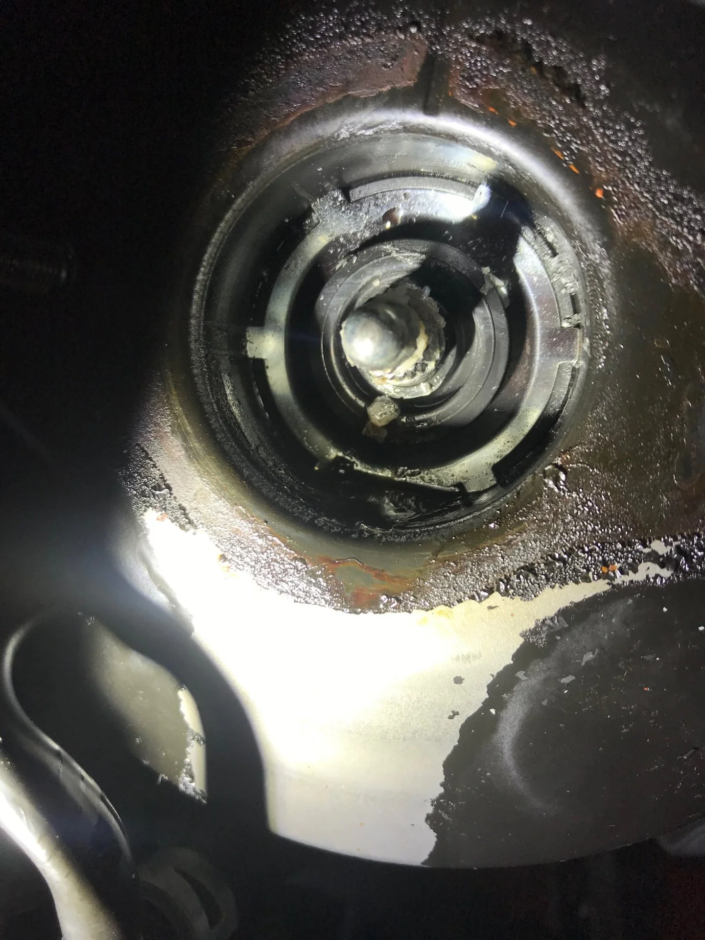

Brake fluid has been leaking from the where my clutch master cylinder is bolted to the clutch booster. I pulled off the master cylinder expecting to see a failed gasket of some sort but it doesn't seem like there is any gasket at all where they join together. Then it occurred to me that brake fluid should be contained with in the the master cylinder shouldn't it? Leading me to think that a seal has failed inside of the cylinder allowing brake fluid out of unsealed junction between the master cylinder and the booster. Is this correct? Here are some pictures if anyone who knows more than I do (which is anything at all) and can tell what is wrong. Any help is appreciated.

You are right; all fluid be contained within the master.
The leak has eaten the paint off the booster… clean the booster with brake cleaner spray.
The master can be rebuilt with new rubber parts but a new one may be available too.

Now should I be worried about brake fluid that has gotten inside of the booster?
I’d buy some electronics cleaning spray and hose down the booster parts that got soaked with brake fluid.
Safe for plastics.

It would be best to change the whole master cylinder for a new one, more than likely the bore is pitted and has torn the last seal.
If you open the cylinder and just put a kit in, it will fail again in the near future.
Open it up have have a look at the bore inside anyway.
Sometimes there a small seperating bolt in the side if its a dual cylinder, just release the tension a bit by pushing the plunger in and remove the bolt and be very careful re installing it not to damage the plunger.
