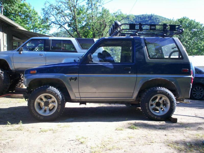

first is sans BL
second is with the BL mocked in place
third is the sticks after the BL install.

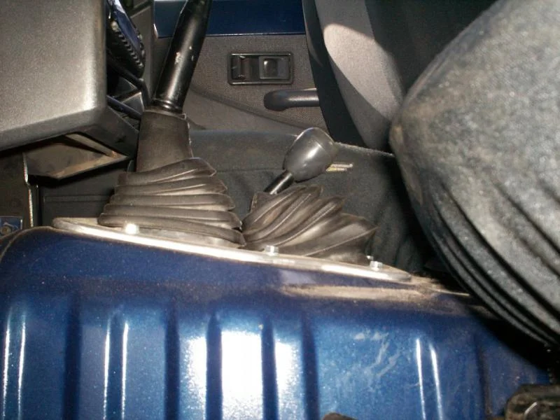

jacked up the trans and case with a small block to fix the stick interference issues.
also shows the BL and how much i cranked the front torsions (8 turns) about 3/4"

shows the new stick height.
