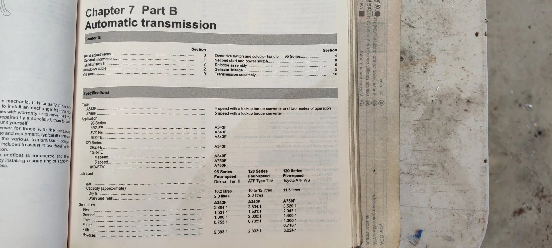

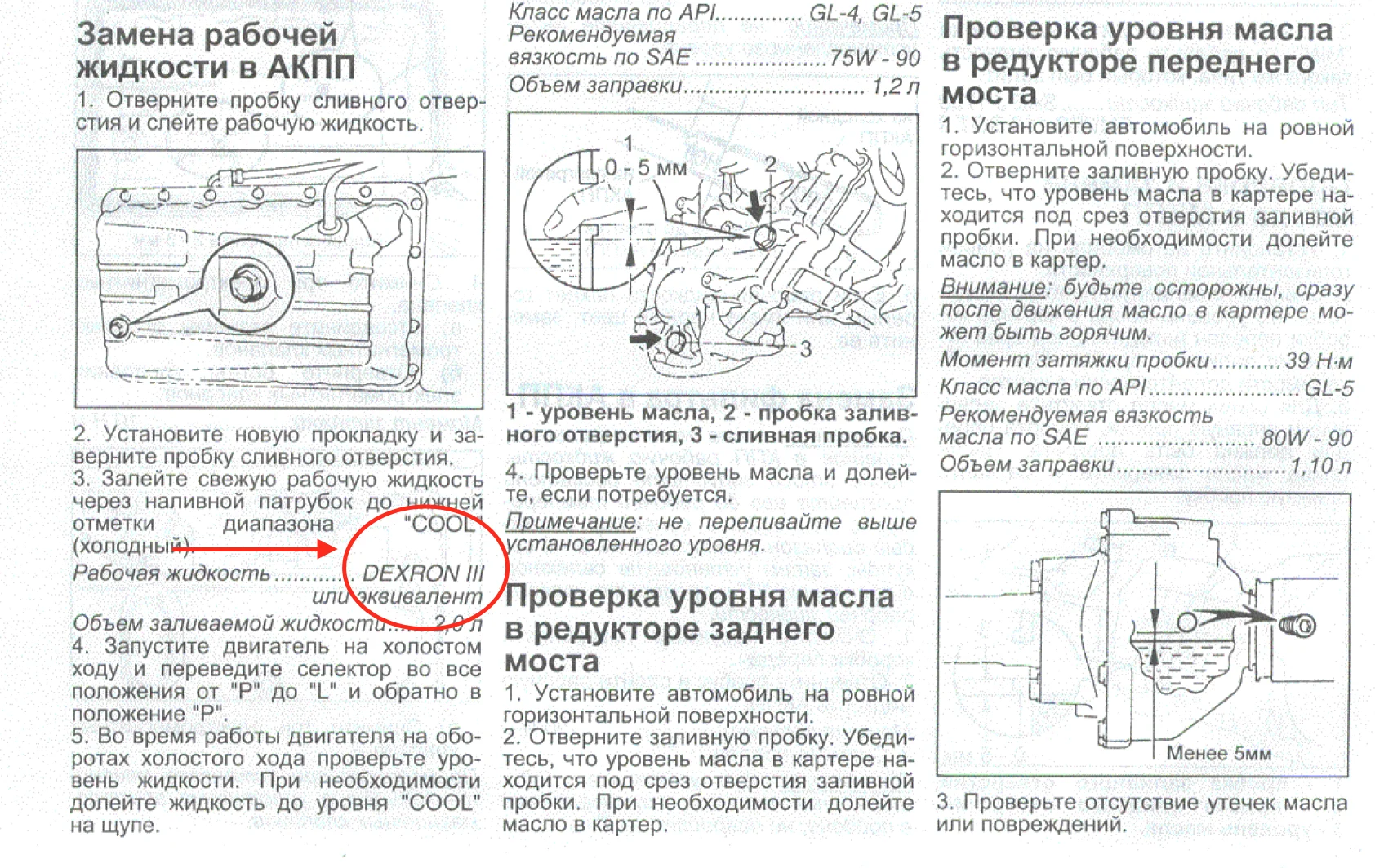

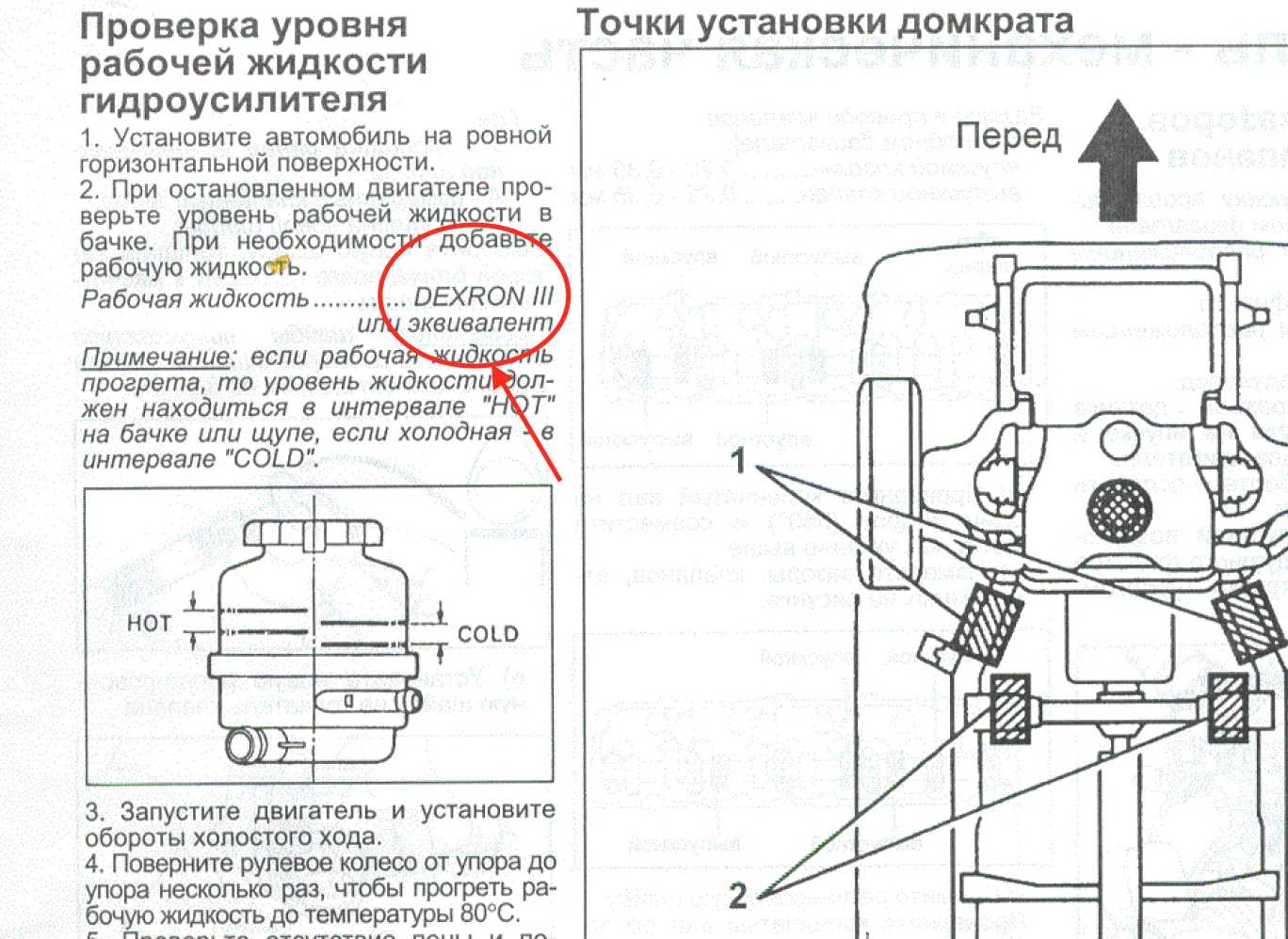

planing to change the transmission fluid tomorrow, i do have few bottles of Toyota WS ATF transmission fluid which left from my Toyota Corolla, i can't find an English maintenance manual for 96 diesel Prado online the only version i found seems like in Russian, i am using google translate and found out for my vehicle i should use Dexron III or equivalent in my transmission.
my question is ,is there a significant difference between Dexron III vs Toyota WS ATF? will use Toyota WS damage my transmission? also seems like power steering fluid is the same with transmission fluid? what kind of power steering fluid you guys all using?
