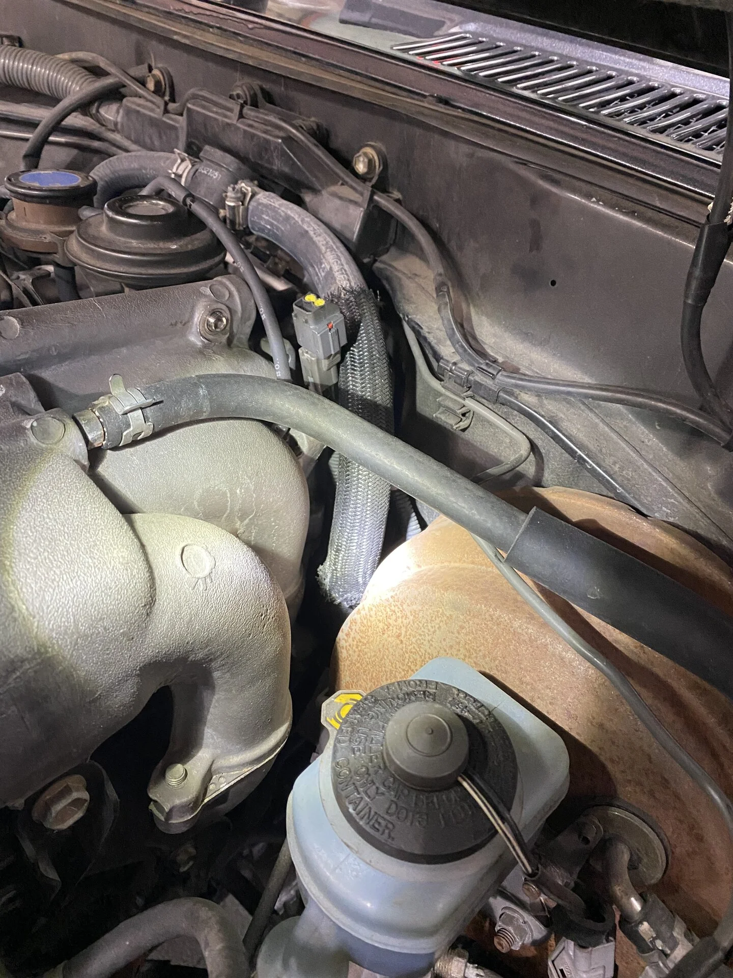

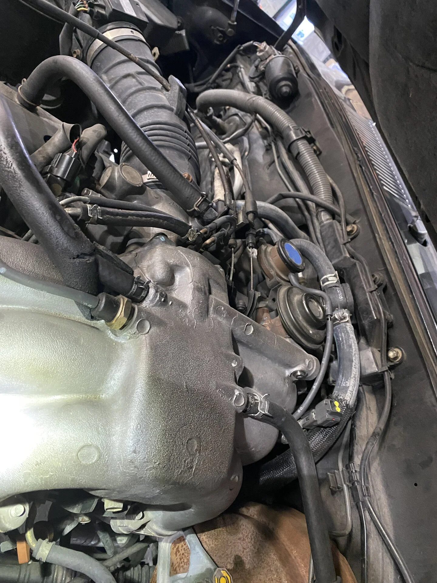

Thanks guys, I haven't had any free time to save my life I finally puller her in today. Mind you I'm barely a half banana mechanic but the wiring harness looks pretty clean to me....what do you guys think?
Of course she's been running perfect ever since this popped up again for that day....
You're taking pictures of the wrong side of the engine. 1. It looks like you have an EGR delete plug for the temp sensor and resistor mod, but the EGR is still there. So if the EGR valve is still there, you're still getting really hot there. 2. The spot where the wire harness melts is right below the EGR by where the pipe comes up from the exhaust manifold.
Oof of course I am 🤦🏻‍♂️
I'll check it out again thank you.
I actually have the hoses plugged going to the egr with ball bearings, that doesn't block it off?
When you plug off the vacuum lines with ball bearings, you are stopping the vacuum from actuating the modulator. I believe you are effectively keeping the egr valve always closed by stopping the flow of exhaust through your egr valve into the intake, but what about the heat and exhaust that is going up the pipe to the egr valve? The only way to eliminate that heat is to block off the egr at the intake and exhaust manifolds. Mine egr works as intended, but I have seen enough burnt wire harnesses by that spot, so I insulated it with some high temperature reflective tape.
