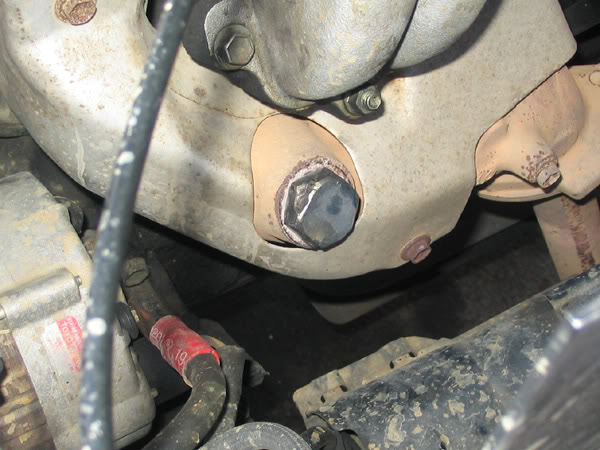

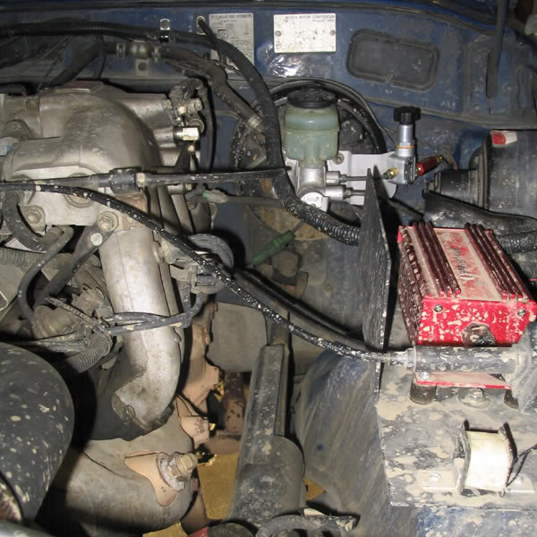

When I removed my EGR system for the desmog, I had used a brass plug for the EGR port on the exhaust manifold. As the manifold would heat up, cool, heat up, and cool, the brass plug kept trying to work its way out. I managed a better solution by ordering a new steel EGR manifold union (the male/male one that connects the EGR pipe to the manifold), cut off one of the threaded sections, welded a piece of scrap steel (had a flattened out piece of 4" thick wall exhaust from a diesel truck in the scrap bin so I used that) to the "head" and then ground the excess off to match the 36mm (I think) hex portion of the union. I looked and looked and could never find a steel bolt the right size, so this was the only real solution I could find. I'll try to post a pic tomorrow if I get the chance. It worked out MUCH better than the brass plug, and looks cleaner too.

Pics for comparison:
Old brass plug on the exhaust manifold,
New plug made from modded EGR union,
