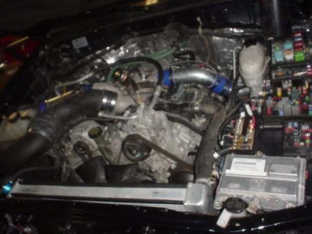

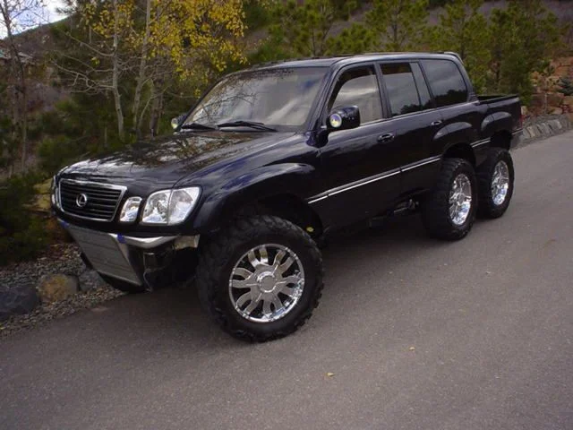

Alan Podvin built this nice little 100 series tow rig with a 6.6L Duramax.
More Details - Here
attachment.php
attachment.php
These rigs are works of art so they won't lead you to the plug-and-play solution everybody wants.
