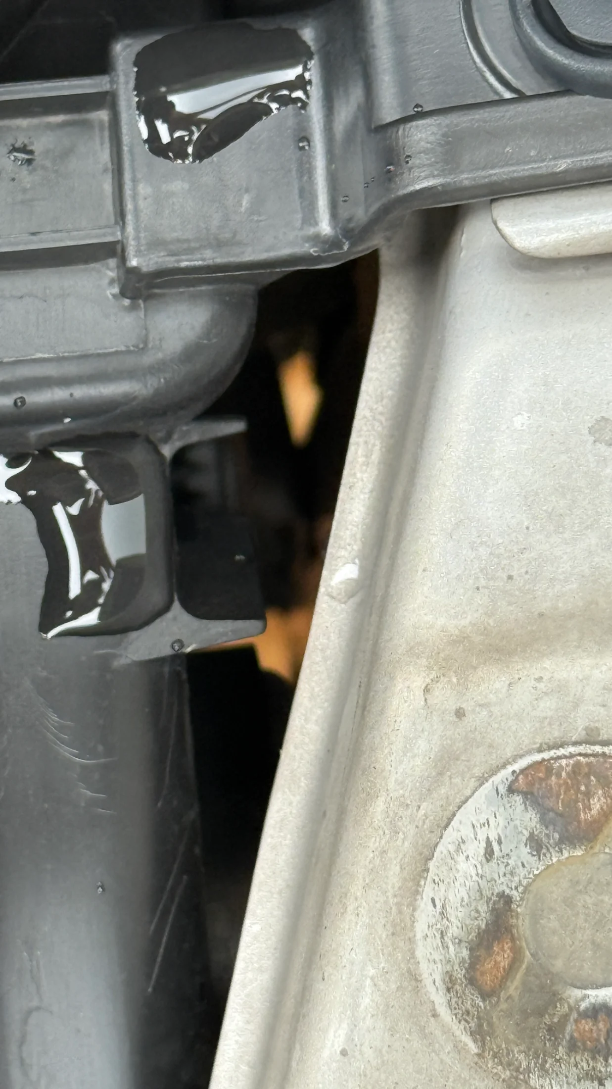

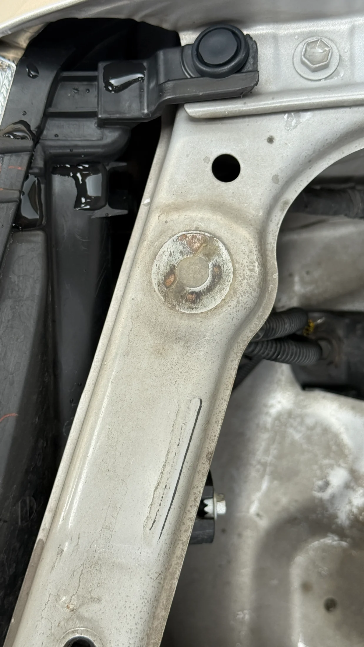

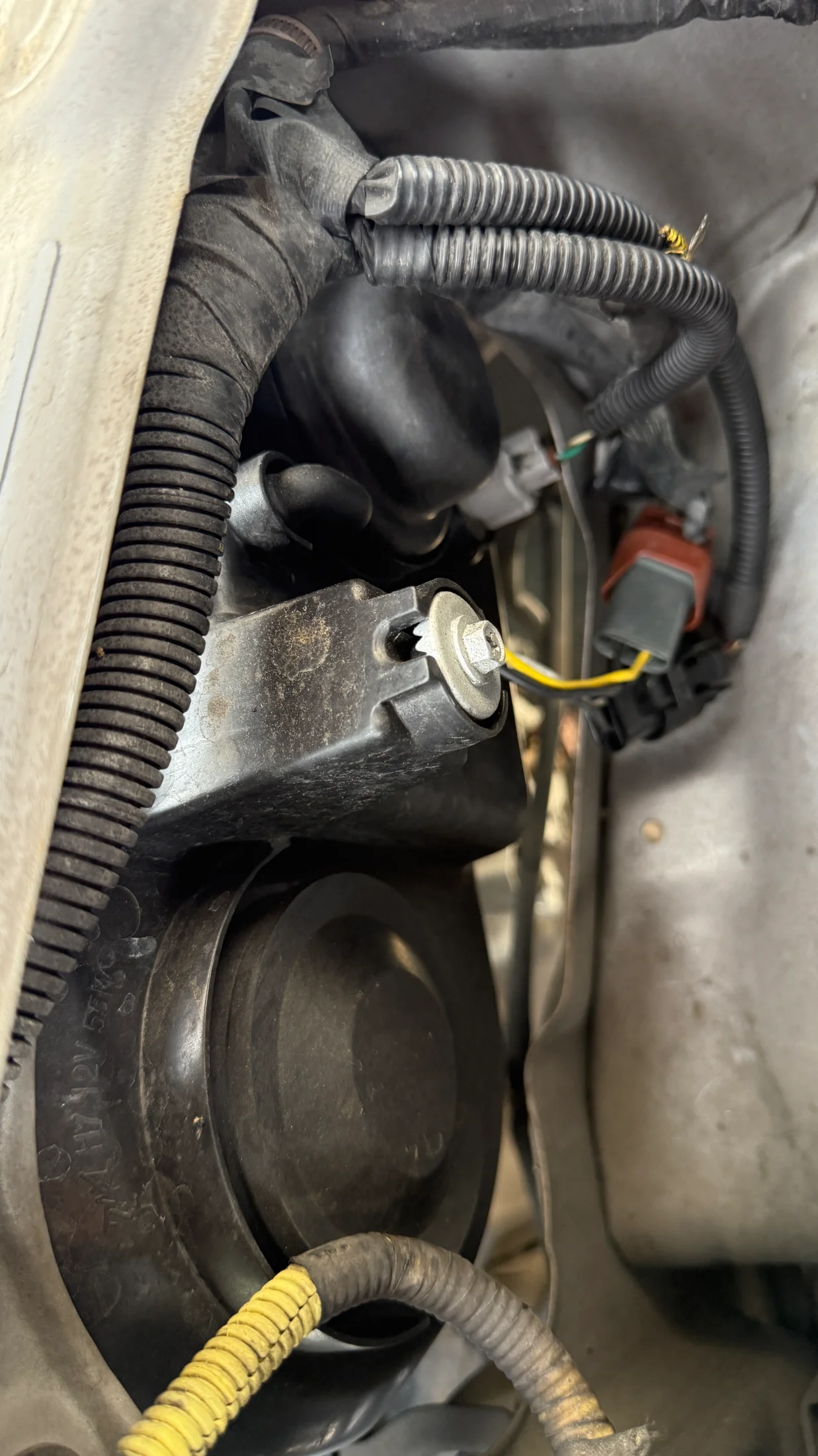

Did swap the headlights against DEPO in my '99 LC100. My original ones had automatic hight adjustment with motors. The DEPO's haven't but that's OK.
There are silver screws see pictures. Two on each headlight, one of these is hard to reach when headlight is fixed in position (there is like a channel that goas vertically down, tried to catch it with the photo?
Does anyone know how to adjust the vertical/horizontal direction after installation?

Use a long Phillip's screw driver to reach the bottom adjuster as well.
The adjuster in the first picture is Horizontal movement and the one at the very bottom should be for vertical.
