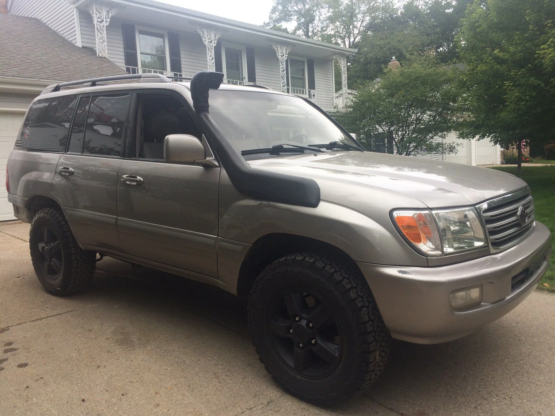

My wife comes out on Sunday and tells me a couple funny stories about what she encountered earlier that day and then looks at the 4” hole in the already dented fender. She looks at me and asks; “why is there a large hole in the fender of the Land Cruiser”?
In my hand is my bright-red, Milwaukee drill with a 4” bit.
Busted.
There’s only one thing I can say and I hear it coming out of my mouth in slow-motion; s n o r k e l...
And then in one stream of justification I hear myself say; Ithelpstheeginebreathbetterandgetbettermpgandlive longer

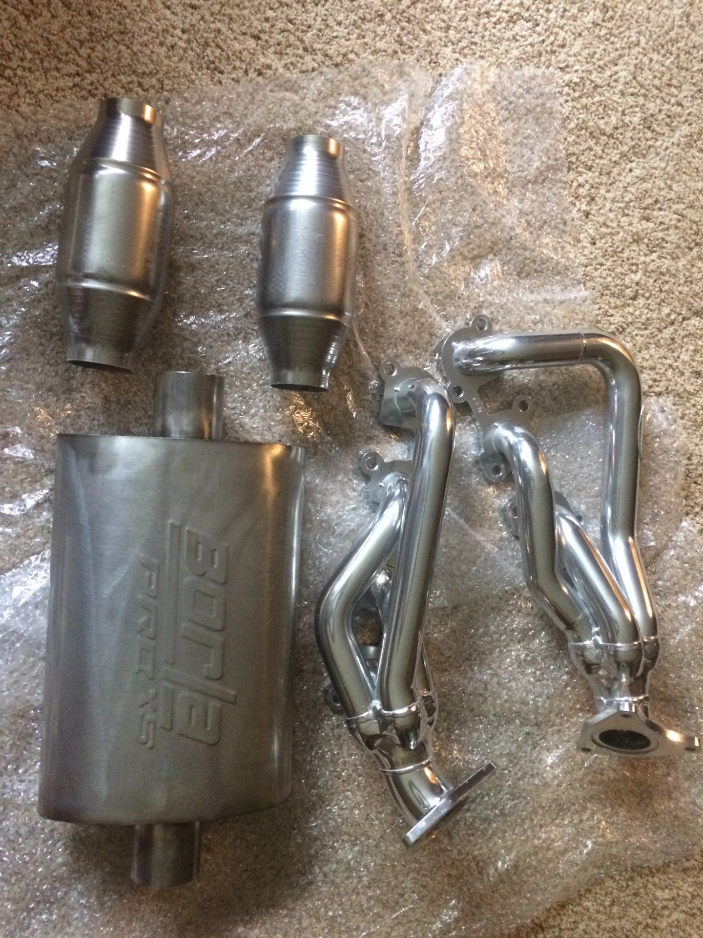

She’s really going to dig the DT Headers, SS Cats, Borla muffler, Resinator delete and custom exhaust ;?)
Absolutely imperative mods to enhance value, fuel mileage, and longevity.

Question for the group; Should we paint the snorkel (either Black or body colour) to protect it?
btw, I used this already dented fender to build a 100 series template... now I'd kind of like to find a replacement fender but it makes it look tougher.

You likely could get by putting some UV protectant on it occasionally. Something like "303 aerospace protectant" which looks exactly like armor all coming out of the bottle but is water based instead of silicone based which is supposed to be a good thing. I like it.
You could paint it black, or any other color you want to help with protection as well. In general, molded plastic parts without paint are subjected to a LOT of UV and could benefit from some UV protection.
I’m thinking of painting “Moab” over the dented area in a little different color.
This is going to be my son’s daily driver as soon as this stage is complete.
I think a protective coat of black will be going on the snorkel this weekend.

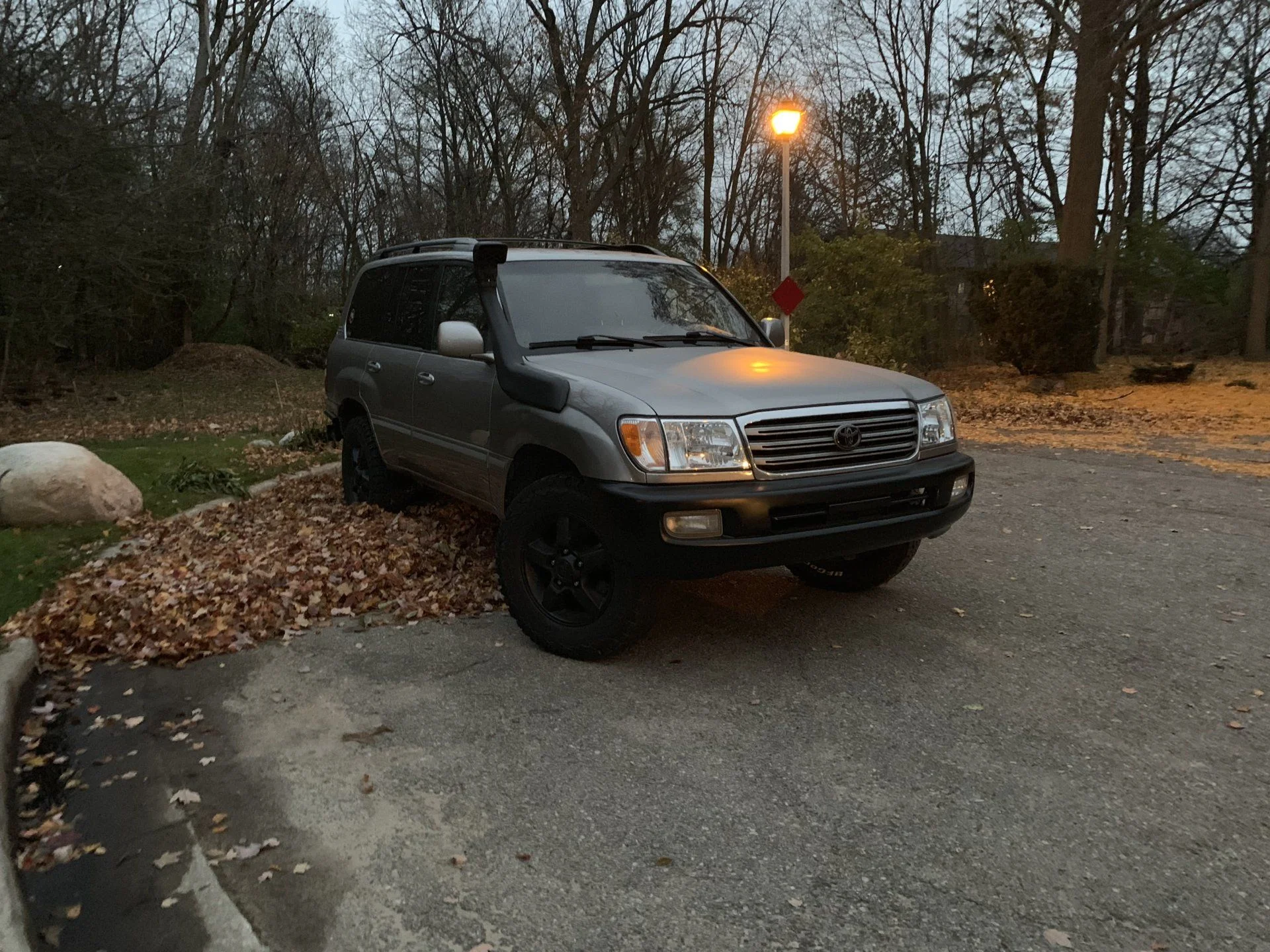

Painted the snorkel, debadged, de-rustified the usual spots (not in too bad of shape), prepped and painted the trouble spots.
Debating installation of the Surco rack I've had in storage for 3 years or if I should save it for when I own kbahus's Fj40 ;?)

I bought the O2 sensors, Borla, Cats and Headers in the pics above and I’m not exactly sure how much final will be. From the initial discussions I’m guessing about $1600 - $2k all in.
Will let you know when it’s all said and done.

LC's back. As soon as I learn how to upload a video to Mud I'll share what the new Stainless, customer exhaust sounds like.
Nice! If you do a youtube video you can just hit the "copy link " and then come here and (on your phone) hold down on the screen until "paste" comes up and choose that. Or use the chain link icon at the top of your message box
Need a cleaner recording... this was my phone rattling on the new rear bumper but you get the idea.
