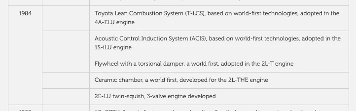

This thread reminded me of some information I had found on-line from Toyota.... The 2L-THE was quite the "important" motor for Toyota....
