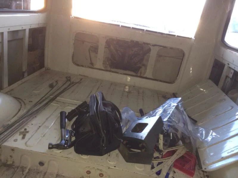

Got about two hours in this afternoon, before family matters tore away, but..,,

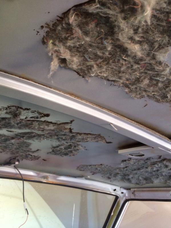

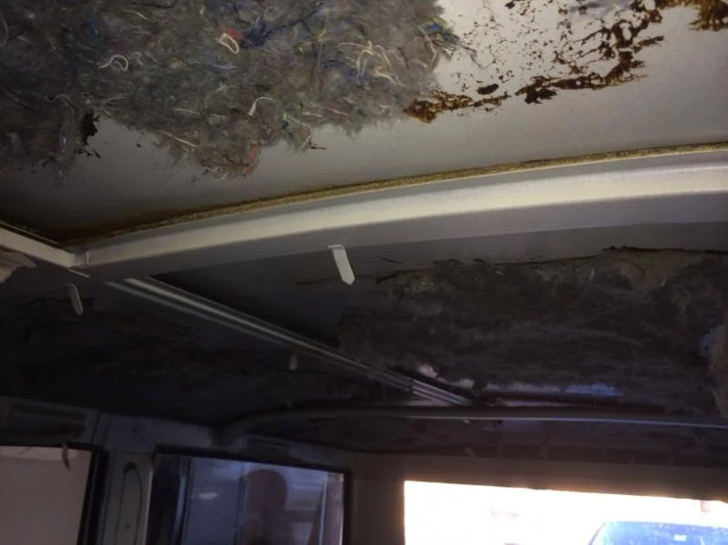

Headliner disintegrated in my hands.

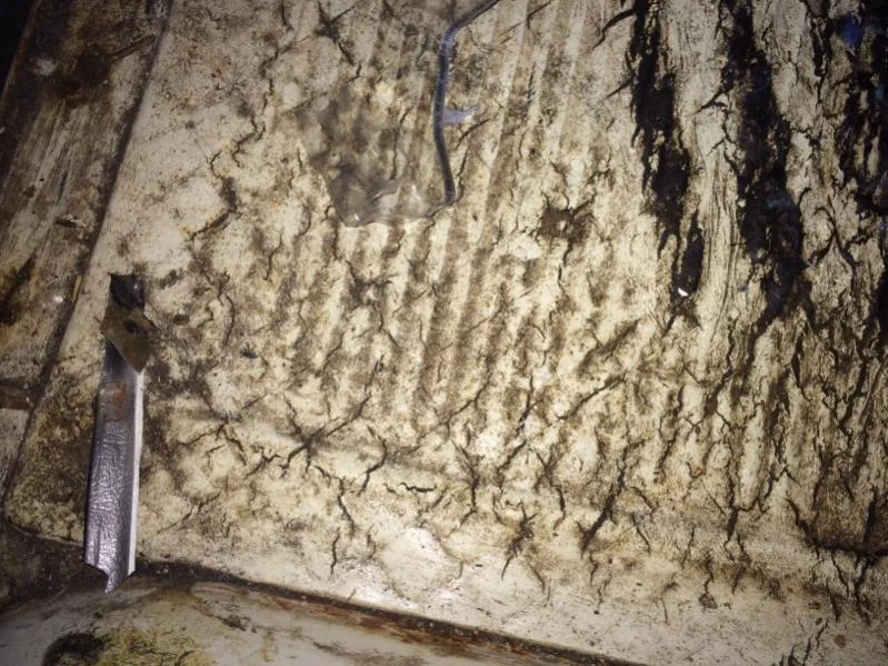

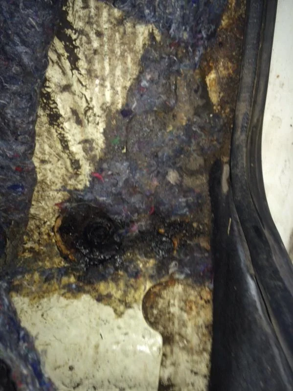

The news. It appears the floor pans are solid.

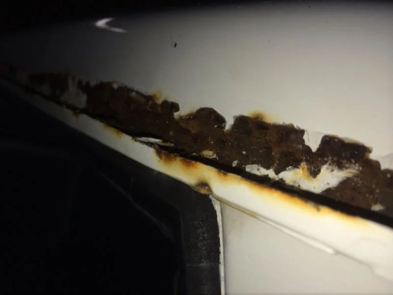

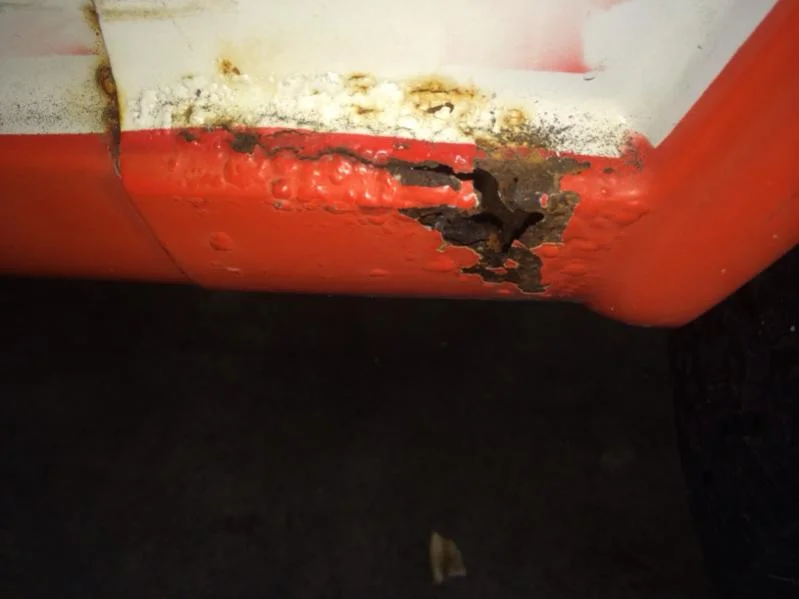

Bad news....the roof does not.

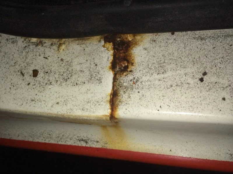

Rocker rot
Pillar rot
Thinking a surprise awaits in the roof channel.
Sucks.

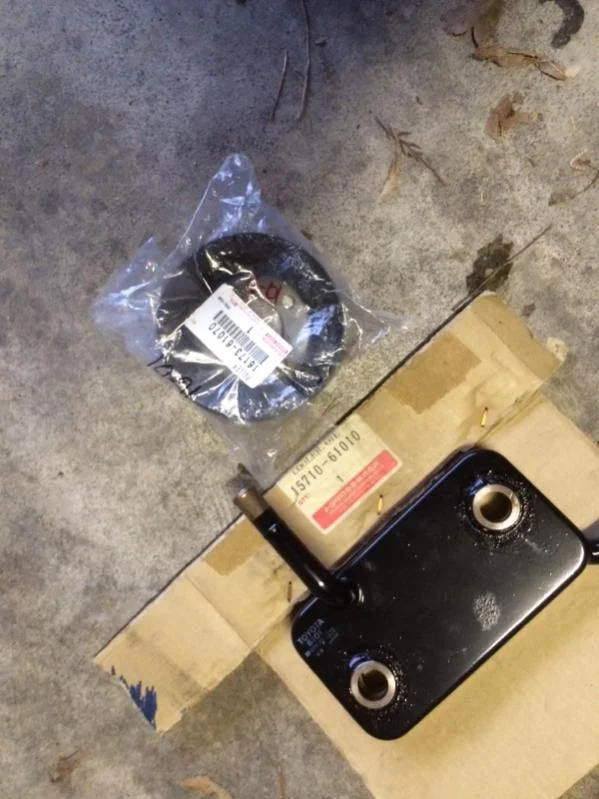

Prepping parts for two part epoxy.
Before.
After

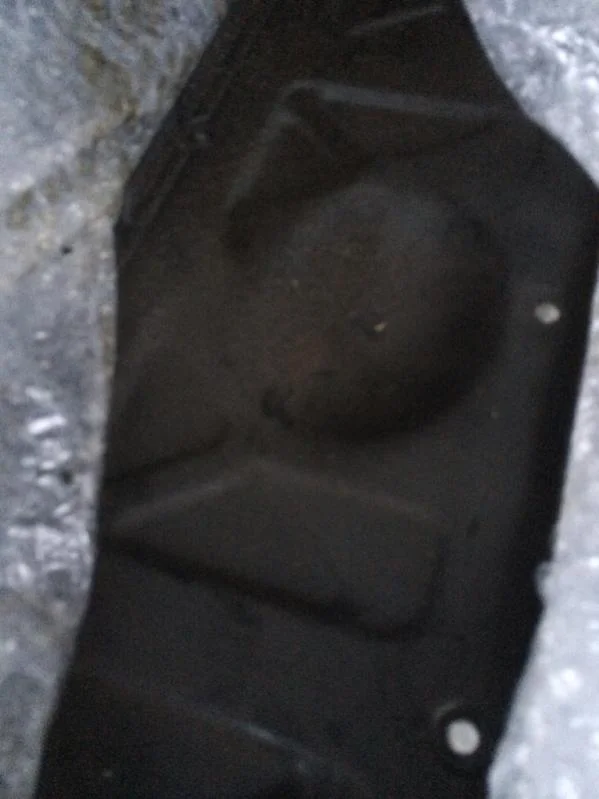

The parts depicted are for the '76. Bought the timing cover, dented side cover, and big cap from 3 puppies, and it looked normal.....with a 1/2" of sludge coating.
Ran those through a buddy's washer and they cleaned up very well , but the timing cover gasket still did not remove. It's incredible.
Think I've found a product and even an applier that will blast, epoxy prime, and top coat in a product that I can use for the rest of everything, for about $10 a part.
That's cheaper than I can blast, so what I can have done now, I am.
The place I spoke to was Precision Coatings they do PC, ceramic, industrial paints, rubberized paints, and cost pistons, rods, cylinders, all kinds of high temp stuff for national accounts.
I was frustrated due to the PC on the 80 falling apart after one snow storm, so I asked what he would suggest. Turns out , he's a car guy and, pretty much said, out of all the coatings at his disposal, this is what he uses on classic Fords and suggests to other local individuals.
Sold me.
Little duller than 202, but I'll live with it.
Have a pile to take Monday, that I'm adding to this weekend. Even going to re-coat the OE parts, since it's claimed a much more durable product and $10 a part.

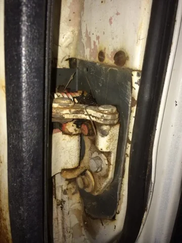

Not certain what's the best course of action to repair this:
Have a fair earlier door, but thinking they're different from the later.
Think the lower frame could be sectioned in?
Later skin and glass transplanted to earlier frame?

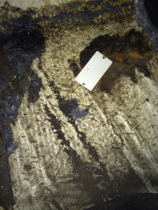

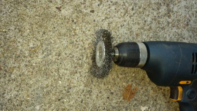

Match? J/K. I used a chisel if I could get a good lip. But everything else I use a 4 inch angle grinder with a 60 grit sanding wheel. You can go cheap if you just have a drill and this works good. Ware a hat and glasses.
Tips on removing the padding?
Stiff wire brush ain't putting a dent, nor did a flat bladed shovel.
Chris,
That's the worst of jobs and what stage of removal, depends on your plans for recovering. I took mine all the way down to bare metal, so the paint would stick. If you're just going to reinsulate with a padding and headliner, then just get the loose stuff with a sharp putty knife. A cheap multi tool from HF, worked for me also.
In the end, I used a propane torch, heated the glue and scraped off.
Good luck, my friend!
