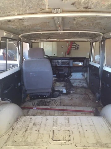

Thinking about the roof.
Mine is now permanently oil canned due to a previous, confirmed impact of some sort. I'd prefer to not replace, all things considered, but will if necessary.
Regardless if it replaces, or not, thinking there's a better way to support the roof panel and increase headroom, but seeing what y'all think.
Add 3 additional cross supports, thinking a heavier rolled hat channel, then seam sealing directly to the bottom of the roof panel, removing the support that runs the length, completely.
Now, I realize why they're meant to move, but they did attach the hood support in a similar fashion, it's more visible than the roof.
If I have to replace or even remove the roof skin, half inclined to find a shop that could roll ribs into it. Know it's possible on smaller flats, but unsure how it could be done on larger, curved metal, but where there's a will there's a way.
Even thought of putting the external ribs, like what is on most with luggage racks, simply as structural component, but thinking that would look hideous.
Part of my thought process is also providing support for a "xx" ga sheet metal headliner, one that could be scrapdaddied, as a finished product. If rust can be abated, I see no reason that access would ever again be necessary, even if that meant surface mounting interior domes. Could always pull wire back through, if an event dictated.
By triple coating the bottom of the roof skin, again, in scrapdaddy fashion, possibly even blanket insulation glued to the underside of the coated roof skin, then a sheet metal headliner triple coated, I "think" that'd minimize the tin can affect plus it'd be durable.
So, why would it be a bad idea to raise the roof supports to the bottom of the skin and attach with a seam sealer?
Why is a sheet metal headliner a bad idea?

The Po on mine used emt tubing and contoured to the roof and it makes makes a good structure to self tap screw something to. He had fiber board there before but I am putting abs sheeting to match me door cards.
How about something like this. http://www.usplastic.com/catalog/item.aspx?itemid=40938&catid=733
A PVC sheet, any thickness you want and cheap, light weight also. It could be cut to fit inside each section and attached to the tubing.
Once you have the frame work made and mounted, there's a lot of products to use as a headliner, if you wish so. Sometimes I think, it would look good without a covering.
the plastic(non-metallic) would be a better option for adhearing the headliner to. but there are so many rigs out there with 75+# of rack weight ABOVE the highest points on their rigs, I would not be worried about that- plus you're not going to be at the limits off camber or climbing a hill with this rig- your concern there is almost valid, but a non-issue in this case...if you're concerned about protection during a tragic event like a roll, then just do an inside cage.
In this event, I'm not. Concerned about an internal support structure for the roof skin, that's viable.
No one has commented on the idea of raising the bows to the underside of the skin and adhering with a seam sealer.
Personally, think welding the damn thing would be a lot better, but the seam sealer should allow for minimal movement.

Chris,
That is how I will do mine. The frame work will be right up against the roof with seam sealer in between, to stop any rattling, etc. The side rails will be bolted to the body, all along the same line as the holes for the headliner bows. No welding, no sweating, no rusting.

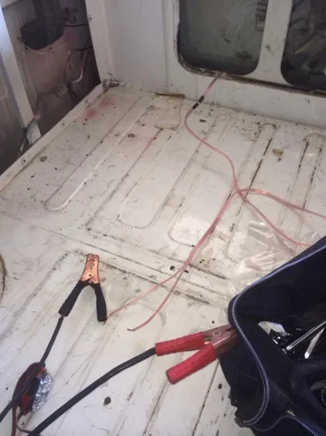

Stripped.
Two and a half hours trying to get the tailgate to work resulted in a cobbled up jumper, after frying the quads charger (my mistake), but did get the glass down, finally.
I have to agree with Pighead, wherever he may be....
It was 70 today, refreshing after the arctic blast, and the rear window down was pretty cool.

check out what i did on my roof. #139 you shouldhave the parts to double up or even triple the roof ribs. i welded in the headliner rods on the inside of the ribs for structural integrity.
https://forum.ih8mud.com/fj55-iron-...91-ga-55-left-woods-20-yrs-10-73-model-7.html
maybe this will inspire you.
