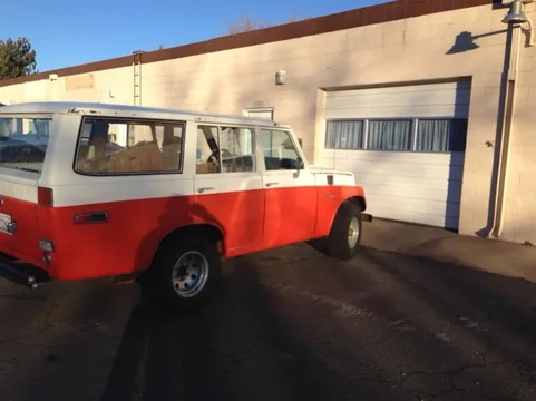

Big day for the '76.....though I can't fully divulge the circumstances, due to pending legal wrangling and processes, but I'm glad the day had come.
Have everything on hand for the mechanical portion, except the dizzy at Jim C's, the mini truck power steering gear box pedestal, and expected, but unknown curveballs the Redheaded 2F is going to throw at us.
Once again, my standard MO, since the horse is pushing the cart, but I wouldn't know any other way to do it, so no point in upsetting the cart, now.

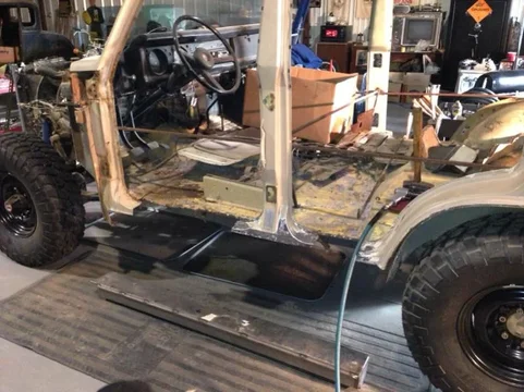

Building the Redheaded 2F, H55, split case, 3F manifolds, 3F carb, Big Cap dizzy and ignition, 3FE alternator, power steering pump, and compressor, and getting all happy and running right.
Power steering gearbox rebuild and install, steering links, axles, brakes, all planned in the downtime balance is being machined.
Host of other tasks that coincide with. Two part epoxy coating all that is removed or planned to be part of the finished product, possible electrical alterations, since there's some unknowns, that will be the blue print for a future harness.
Leafs, shocks, few other miscellaneous items that make sense to do, concurrently with other major mechanical.
Facelift will come after, since the stars didn't align for the more sensible plan, that was many months in the making and fell apart in the final hours, to develop.
Before I take grief over outsourcing, my plan is for this Pig to replace my current DD, so that I can liquidate current DD while it's still worth half of just the aftermarket components I've installed.
My goal was to have this done by March, but betting I'll be lucky to see September, that's if I can get the body work underway soon , which seems unlikely, considering the scope with the ambi doors.

My contingency plan is to complete this portion, being mechanical, and reassessing timeline after, possibly driving before body work is 100% done.
Short of the gearbox pedestal, exhaust, leafs, shocks, and the dizzy/ignition at Jim C's, all other components were loaded in the Pig.
The pistons, rings, rods, lifters, bearings, camshaft and valves, have all been frozen, already, so a matter of stripping it and getting all to the machine shop, which the area's notable for many that are proficient.

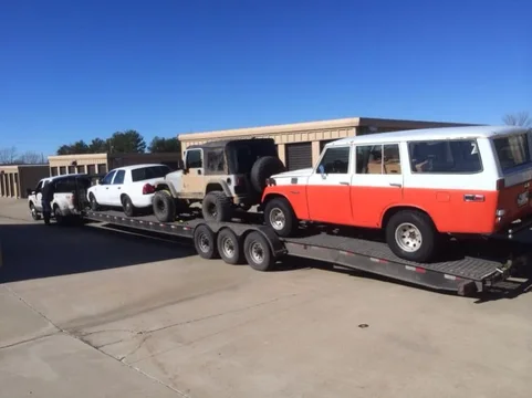

Was moments away from calling y'all a week ago to see what the schedule was looking like for, at least, minor body work (anything that would make sense to do with the body off the frame) but figured my piss poor planning doesn't constitute an pseudo-emergency for anyone else, plus have no means to transport the shell the 80 miles south to Colorado Springs.
