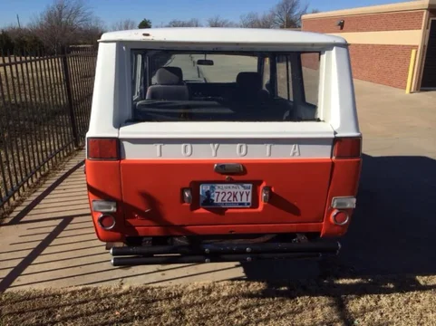

Delancy's NEW 76 PIGGY ???
In a continuing effort to contain my pignorant questions, posing here.
After a little seat time, I'm concerned about legroom, or the lack thereof, and don't see a means to move whatever the final seat option is, further back, without there being little reason for a rear door. (No room in back seat for rear passenger, for those challenged with D'English).
So, I'm curious if anyone has any experience or input on moving the pedals closer to the firewall?
In realizing all are levers, thinking it's possible without impacting the stroke, but I don't profess much knowledge of anything anyway.

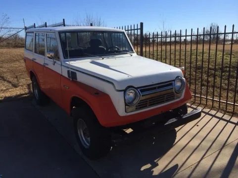

Regardless, a few items that will need to be addressed are RH, suspension, seat pan height, and legroom.
I've tried on number it's occasions to elicit a response from Jeff at Deaver to discuss a 2-2 1/2" leaf with the only focus being comfort, to no avail.
Considering Alcan my only option, unless someone has a suggestion otherwise.
Reworking these isn't a viable consideration and Kurt's offerings are all stated for additional loads, which aren't present on this build.
Will order shocks according to lift specs, with the standard nomenclature "caddy like" ride, when the time comes.
Don't know what to do about seat/leg room.
Lowering the seat beyond its current setting (which isn't possible due to heater) makes for a funny steering wheel angle, determined by lowering the PS and holding up a wheel.
Tilt column may help, but still gets no where on leg room.
For moving pedals...there's room at the bottom of the clutch and brake pedal throw, that may be minimized once the masters are addressed, but can't say for certain.
The only other armature I have is the 80, which is so different, it's no use even to visualize, so still searching for info on.

I'd love to do business with Kurt on this, but the additional load capacities and the perceived impact on ride quality concern me.
I've learned my lesson on coils/coil overs and have absolutely no desire to be a guinea pig, again.
Once again, my goals are:
Lift it 3.5" above its current ride height, which should be 2-2.5" over OE.
No additional weight considerations beyond OE.
On road ride quality takes highest importance over any other.
Tulsa Spring contends that re-arching can be done, but they do not guarantee the results nor longevity of product.
He said it "sounds good", but it's a "fine art."
I'm lucky I guess, I have Eberwein spring right down the road from me(50 miles). they are one of the older old fashioned spring shops- run by fine artisans;). they want 350-375 per custom, but only 50 per axle to disassemble, flatten, re-arch, and reassemble. They will say they won't guarantee any longevity, but mostly because it is an off road vehicle as well...I don't have a prollem w/alcan, just out of my range...
might think about talking to Kurt about using the 75 series springs, loose a leaf or 2 from the pack, and then have them arched to desired ride height....the trick is to have a long enough leaf that it can be arched a bit more, but not be too short then for the hangers...the 75 series springs are long enough to do this, and with a leaf or 2 missing, there will be a better ride quality over all just due to the longer springs and corrected shackle angles...the re-arching lasts longer on a newer spring, FWIU from the guys at Eberwein...
I'm 6'1" and I don't have any problem with Pig comfort. I do feel like I'm looking out the rear door window but there is still plenty of room behind me. Depending on what you are doing for a front seat you can also raise the seat a little to gain inches that way. In a past iteration of my front seating I had it so my head almost hit the ceiling which made for a really comfortable driving position as long as I didn't go over any speed bumps. The first front seats I used were out of a full size Blazer, now I'm using some cheap-o sport buckets which are harder and lower but have nice side bolsters in case I decide I need to do some auto-crossing. :)
How big of tires are you going with? You have a good height at the moment. What lift is in it currently? One thing I found was that once I got it to the height I wanted my wife and kids could no longer get in...thus they all hated the Pig. I've taken a bunch of lift back out of it and have gone to smaller tires. Do the wife test before you go a lot farther.
Plan to run 33s and the "lift" is mostly to elevate for ease of egress in and out for myself. At 3.5" above where it currently sits, puts the bottom of the door opening at 5' 11 1/2".
My family already has the lifted 80 to despise, so anything less should be embraced.
On seating, had intentions of F250 ABTS seats mounted on ~1" risers, but thinking the seat backs are too thick to still leave knee room in rear seat behind driver.
