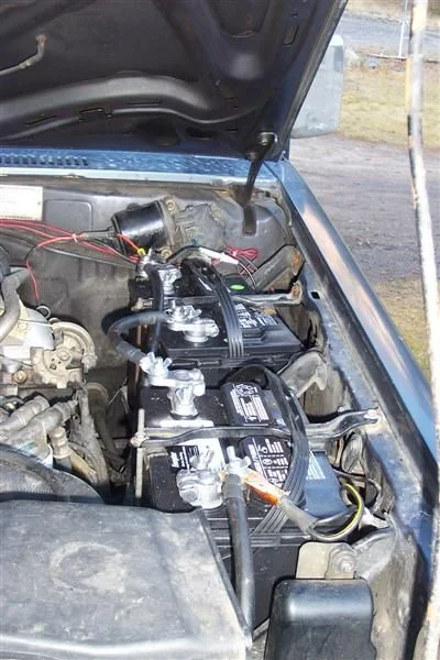

would you guys use the secondary battery posts for the winch cables?

Some battery manufacturers ( such as Optima) don't want you to run the winch from the side posts. In your case with the 24V winch, I'd be surprised if you draw the same current as a 12 V winch would so... maybe.

sounds hopeful lowenbrau.

your right on less cca and thicker plates, but i went a little over kill for electric winch.
It's precisely why you'd be best with semi deep cycle. The winch doesn't take 1000A, but it can draw a lot of power for quite some time, therefore a battery able to discharge a bit less but for longer would be better. Last summer when my starter almost fried (welded solenoid contacts), the batteries where quite appy to turn it for a couple minutes non stop (until I found a wrench to take the cable off the battery posts). Also, several years ago I burnt out an 8D (yea, that huge truck battery, about 1200CCA IIRC) in 6 months doing just that (winching logs with my partner's FJ45). Starting batteries are simply not tough enough for extended power draw.
edit, as a side note, re-did my wires last night with 1/0 awg welding cable. :hillbilly:
Excellent idea. Did you crimp or solder?

are you 24 volt?
solder and shrink tube.

are you 24 volt?
24 v start, 12V lights and accessories.
Copper Pipe Sleeve, Insert cable, Solder, Flatten with Sledge Hammer on Vise, Drill, Shape, Resolder, Buff and Shrink Tubing ;)
