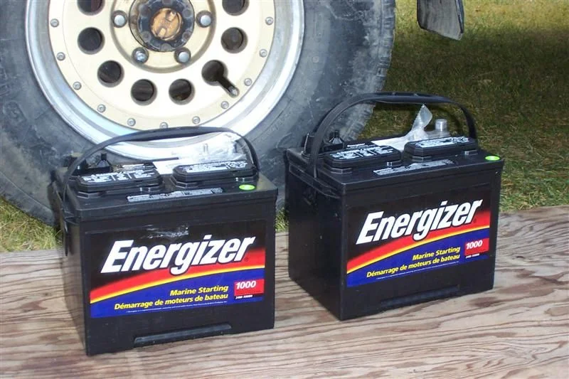

went to walmart instead of c-tire and picked up these batteries.
OK, I know these bateries, they are suposed to be more robust than regular starting batteries, but they are NOT the improperly named 'deep-cycle' I am using. The ones I was talking about are 'start and troll', which have lesser CCAs (850 or so instead of your 1000), already more than enough for our trucks, but have thicker plates with coarser crystals, confering them better longevity than the standard starting batteries while still having more tha enough starting capacity for our trucks (even in the middle of winter).
You may not be able to get them at this time of the year, though, they usually buy their new stock in spring. it's vital to fully chrge the battieries BEFORE using as they may have been sitting on their shelves for quite a while (check the date code, a new one should have a sticker with "0811" or something like that)
It will be interesting to find how these two battery types compare ;)
Willing to conduct a few 'leave your lights on for three hours' tests to find out? ;)
not a case of willing, but more a case of by default forgetfulness. :frown:
yer, we will see how they work out. your right on less cca and thicker plates, but i went a little over kill for electric winch.
