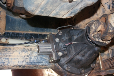

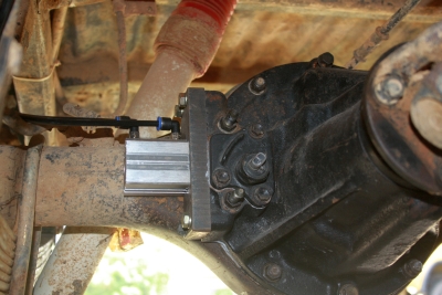

WEll after 14 months the Lockers are installed finally. All we need now is the Compressor connected and the wiring done. It all being done with AIR and I am getting two flashing lights installed for when the lockers are engaged also.

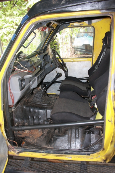

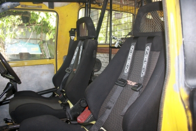

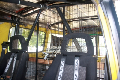

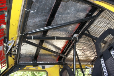

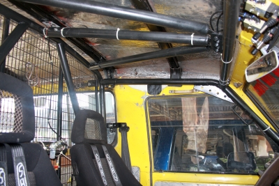

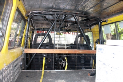

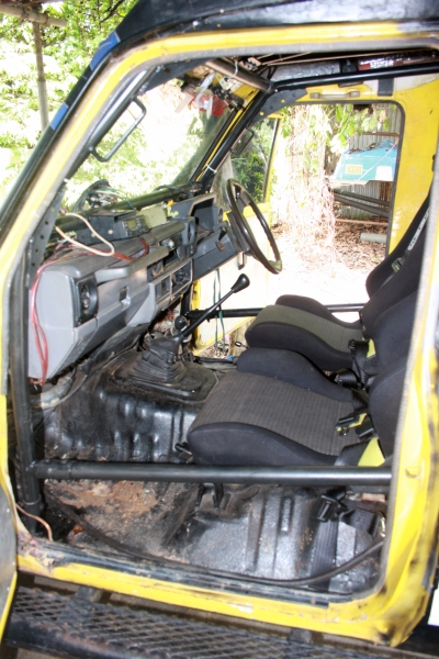

At the same time the new seats were installed (from an ISUZU TROOPER 2 DOOR) and the harnesses and the rollcage also installed. The cage is fully removeable.

The new rear locker actuator fitted.
The new front locker actuator fitted.

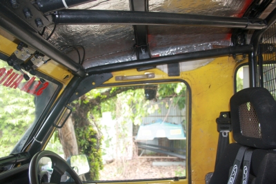

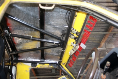

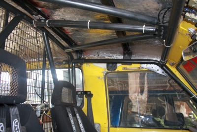

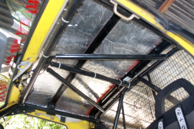

Gusseting on the roof bar and the AIR actuators for the lockers are on the front on top of the front window.

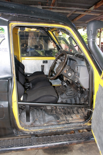

I gave the welder the picture of the rollcage and away he went he has done a lot of cages before but not one with such a complicated roof spec. Comments or advice please. For cost here its 40mm normal tube as the high spec stuff is just so expensive and I am not doing comp in it.

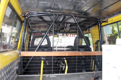

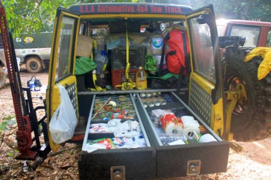

The DEATHSTAR packed and ready to move. 800kg of kit including 20 cases of the finest MAlaysian Beer.

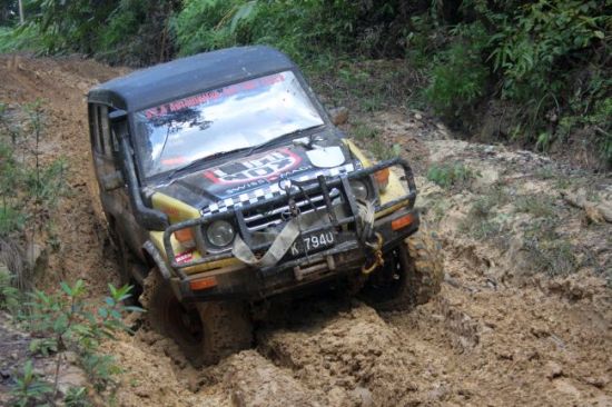

Yellow coming down a slippery slope in RFC 2009 with 800kg in the rear.
Near the bottom and still in control hahaha
The roll cage also has space at the bottom for two more batteries for the running of the all essential fridges which will make 4 batteries in the DEATHSTAR. I am looking at how to have 2 alternators and a SOLAR panel on the bonnet.
there is a lot of lost room and I have size 12 feet the shoes I was wearing saturday just fitted nicely - I suspect I will have to move something like the pedals all left some 20mm to make my feet happy

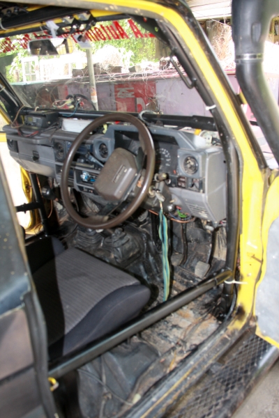

Nice cage:cheers: Did you need to modify the front doors? (dash-rollcage door)
THanks. It was my design after looking at a few comp trucks and what I wanted for my own saftey.

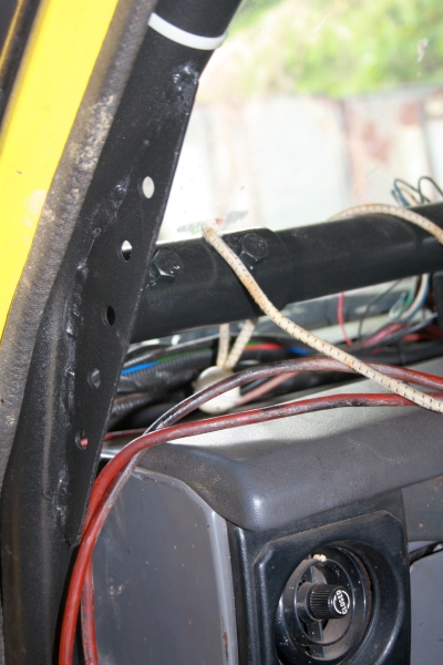

Only mod done was to remove the grab handles but they welded in two new ones for me to the cage. I need to fix the passenger seat up as the seat adjuster is right on the horizontal bar. THey may be made to move it yet.
I think they choped a little of the dash away to fit it down. THey did ask if they had to could they chop the dash end and I said yes. I saw another one recently where they chopped the down bar to make it fit between the dash and the door pillar with a oxy torch and a hammer. Oh it was bad very bad. A roll cage guy I knew looked at it and walked away shaking his head.
The quality of the welds and the joins is very good.
