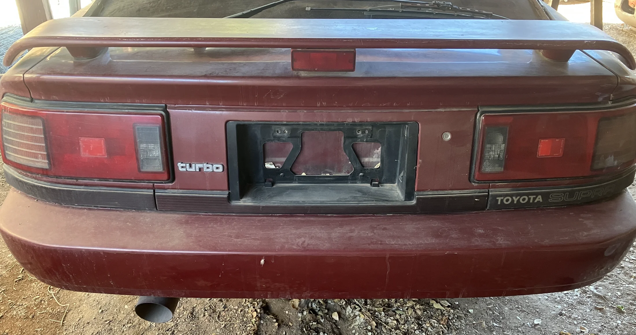

I have an extra 22rte engine with a fresh turbo. The truck has a fresh engine and turbo too. Decent 1980's Toyota plastic parts are tough to find.
@NMBruce brought up a very important point: Parts. Many 1980's polymer parts are brittle, sun-bleached, cracked, or just broken. New OEM mechanical parts for old or obscure models are tough to find. Finding parts takes time and patience. Extra running vehicles are a must.
UGLY! Once this dash is replaced, I don't think I could give it away. Sun-baked yard art!

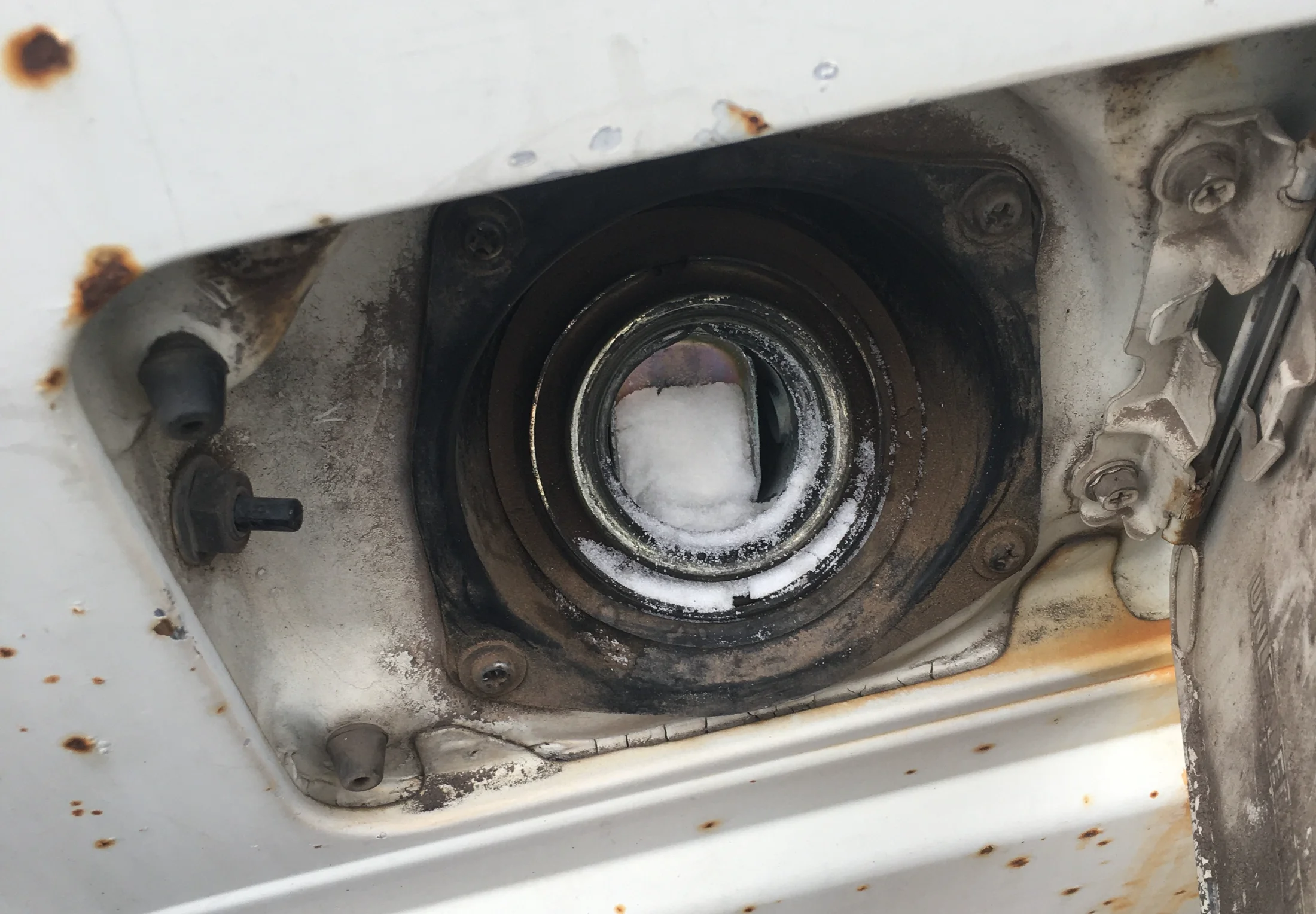

4 Check for damage or vandalism: Loose lugnuts, castle nuts without cotter pins, loose engine mounts, sugar in the gas tank. Any guesses why I gave those examples?
5 Preventative maintenance and regular tune-ups. Parts wear out or break. Do not use chinesium junk. I've gone the cheap parts route and been burned.

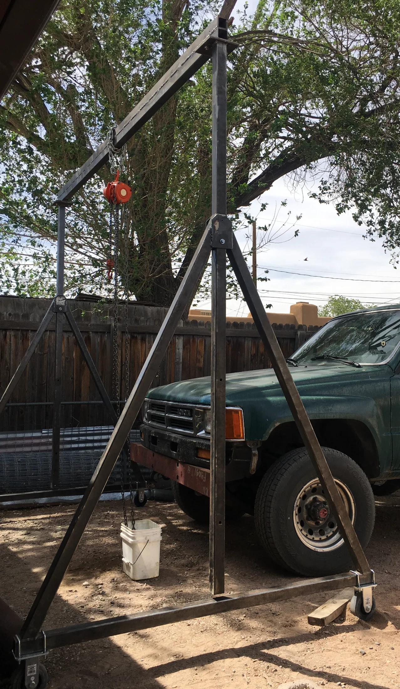

I didn't like the cost and features of commercially available gantry cranes. So, I designed and fabricated my own.
The green pickup in the above picture was bought with a broken odometer reading 716,000 miles. Actual milage is unknown. The engine was opened up and .060" over pistons found. The engine cylinders were bored at least a couple of times if not four times. If you calculate total engine rotations based on mileage and gear ratios, you will get a very large number. This large number of engine rotations causes measurable wear from piston rings sliding up and down for every rotation. The number of rebuilds this truck underwent is understandable. What should someone do if they are concerned about engine condition or lackluster performance? A leak down test.
