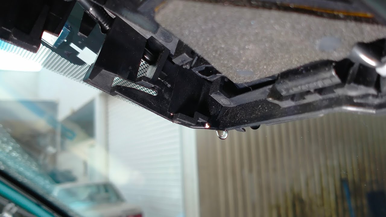

Lots of people with water in the kick panels and corroded wiring connectors there. Source could be a windshield, possibly overflowing sunroof drains, or even a bad seal between the plastic cowl cover and the windshield letting water into the recirculate vent above the AC blower motor in the dash.
Unlikely you need a whole harness, but you will need someone experienced in repairing wiring, helpful if it's specifically toyota.
Keep in mind toyota isn't in the habit of fixing even one bad wire in a harness, they'll just say to replace the harness. Could be minimal damage, but it could also be significant. See whether they will get you pictures. I assume you'll have pictures of white multi-pin connectors with originally-tin connectors green in color from corrosion.
Obviously you'll also need to find the leak source as well. If the damage is only on the passenger side it may just be the cowl.
