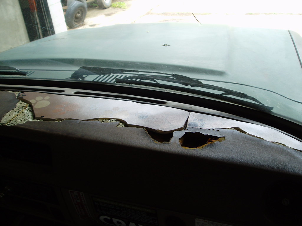

My dash was a mess, full of cracks and curling up at every crack.
I don't know about you, but seeing that every time I sit in the driver's seat is a downer at best. So I ordered a dash cover from CCOT.

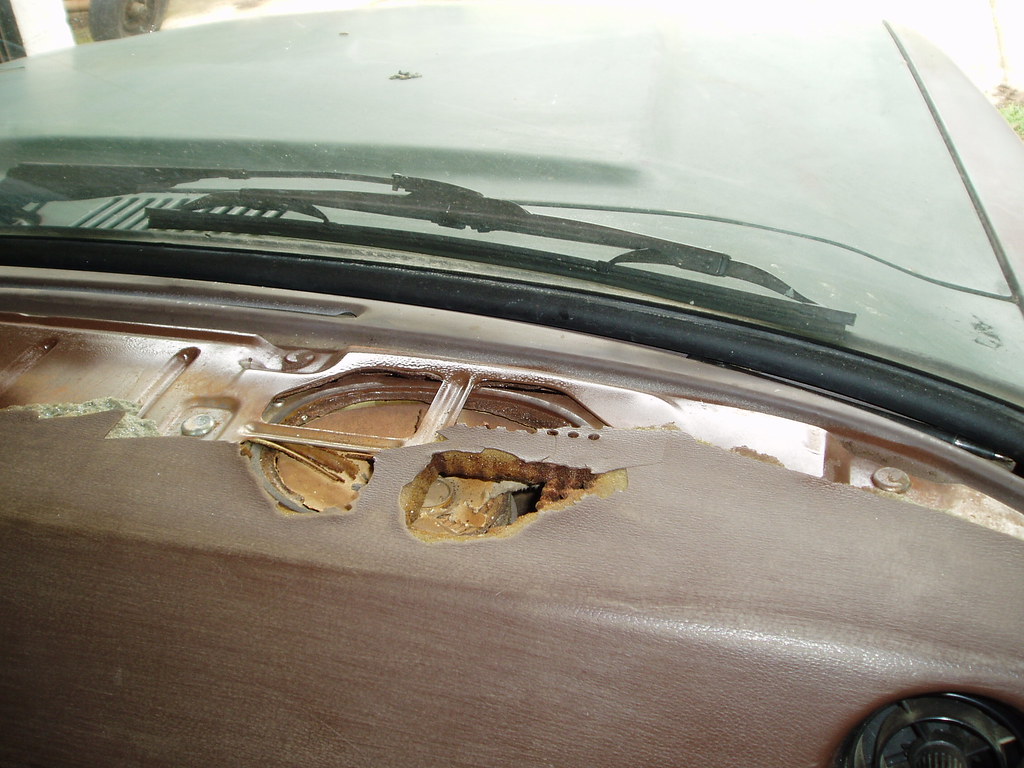

Before, This is what was left after I removed all the cracked and curling foam.
I found a dense foam matt at Lowes that was the same thickness of the foam uner the OEM dash. Cut it to shape and glued it in. THe new dash cover requires the support. I also painted the edge of the new foam brown so it is not visable through the windshield.

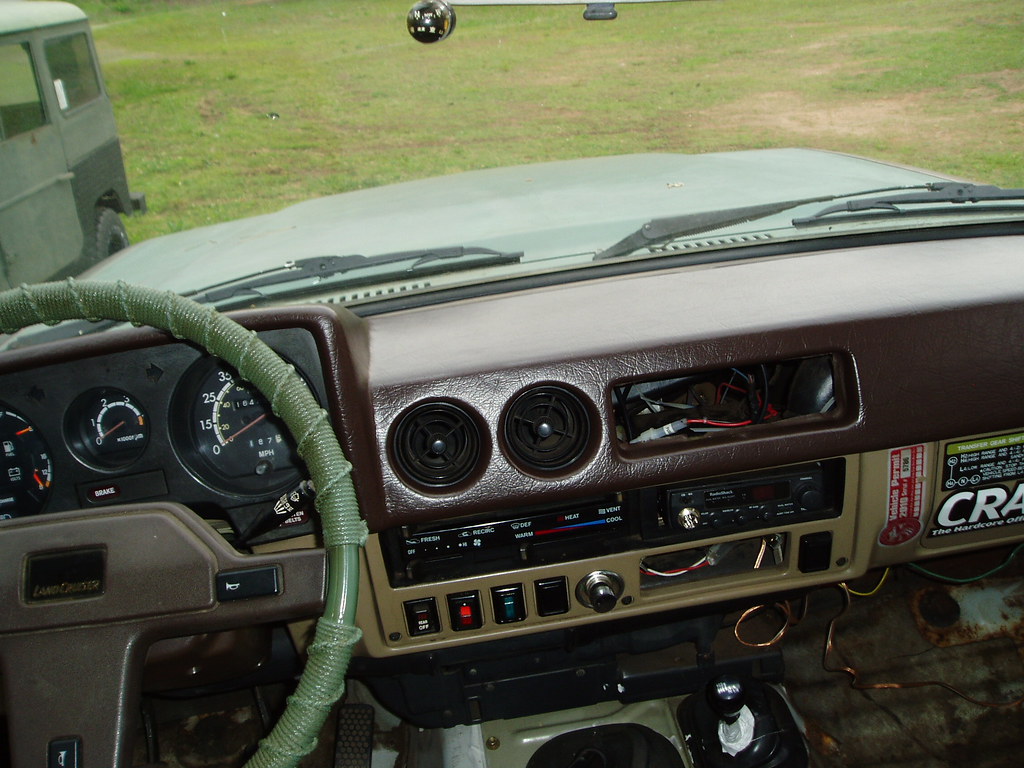

I followed the directions and this is what I look at now. HUGE improvement!
OOOOH, purty. Money and time well spent.
Nice, must be the one the PO put in mine. Hard to tell difference from factory unless you really look. Great job!
