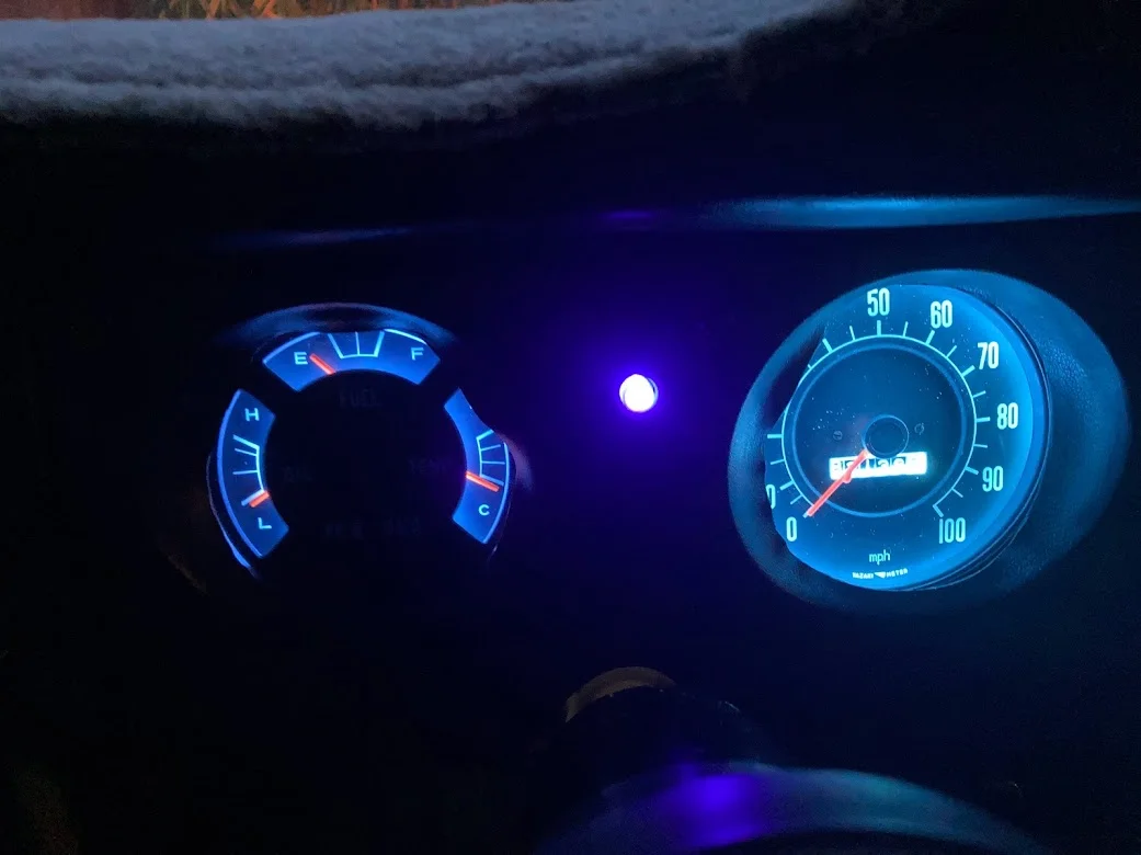

You can use LED lights that really brighten things up. I think I got them from @ToyotaMatt
This pic below shows gauges w/ LEDs installed.

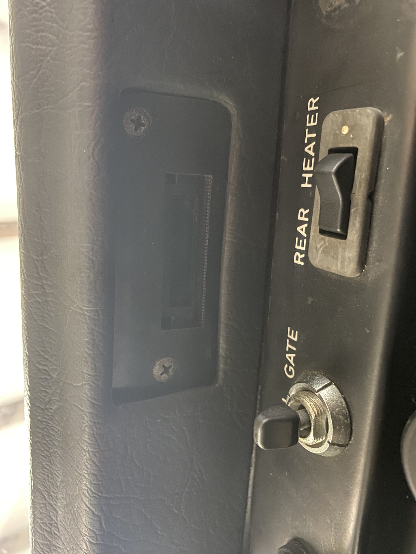

I think @arthog was referencing the single light under the center of the dash pad that’s supposed to illuminate the heater controls.
My apologies. I'll try to get that taken apart asap.

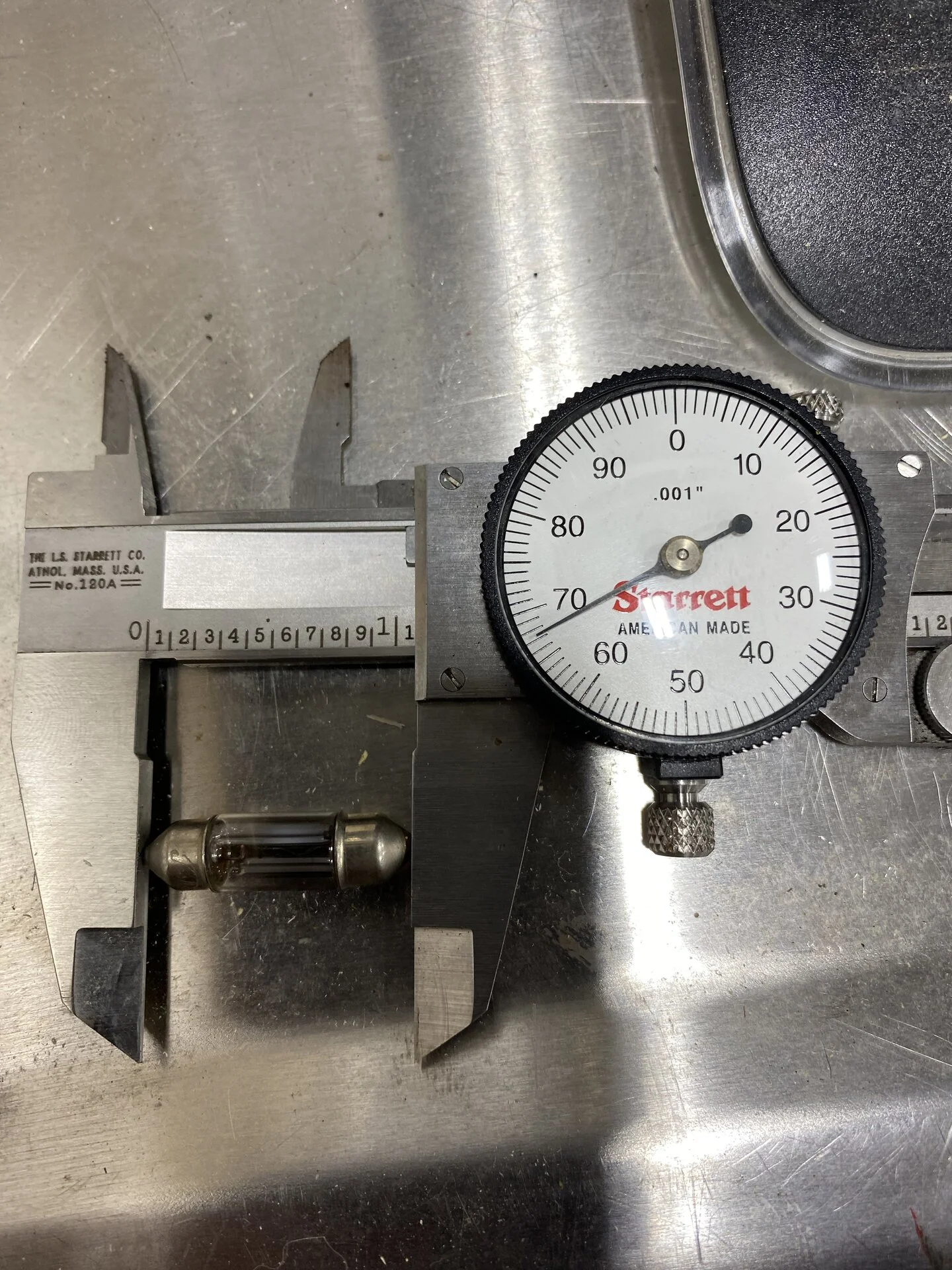

2nd Edit: I am guessing that the under dash light bulb is not the one I referenced below. It makes no sense for it to be 23W when the overhead dome light is only 10W. If the dome light is 10W then I would think the dash light would be less, maybe way less. I can find no marking on the bulb I removed and it is burnt out so impossible to get a feel for output.

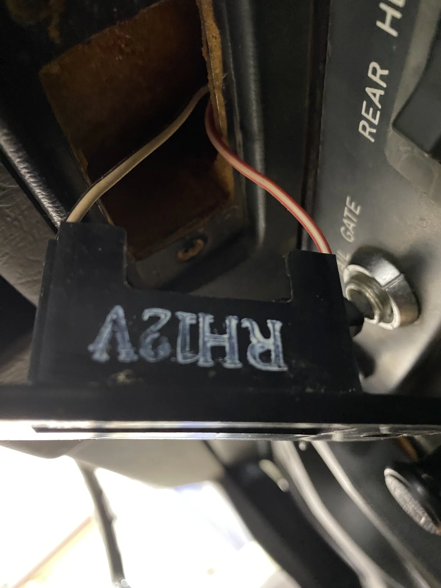

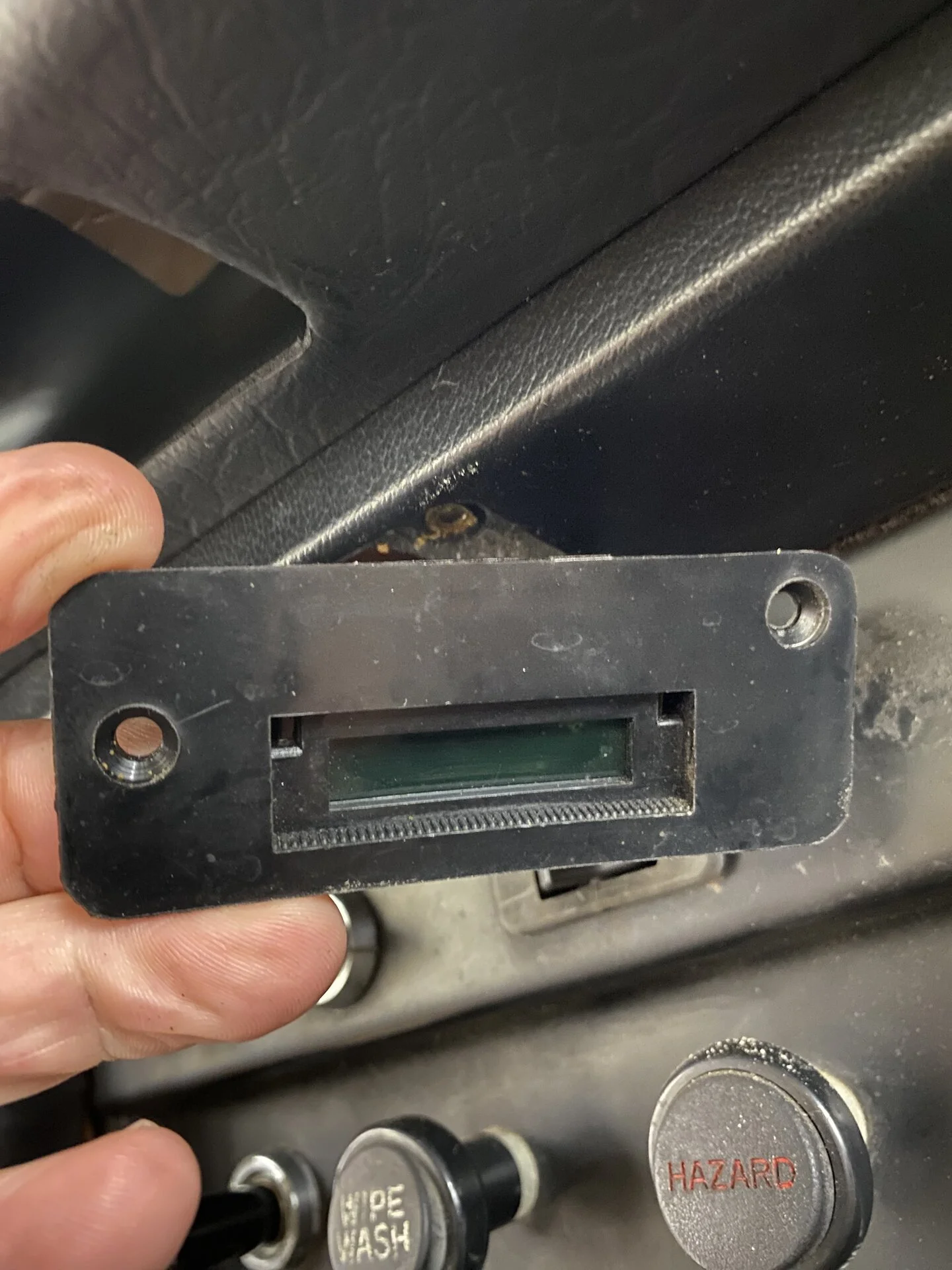

Edit: Here's all the information I can find in the parts diagrams and I did take it apart and get some photos.

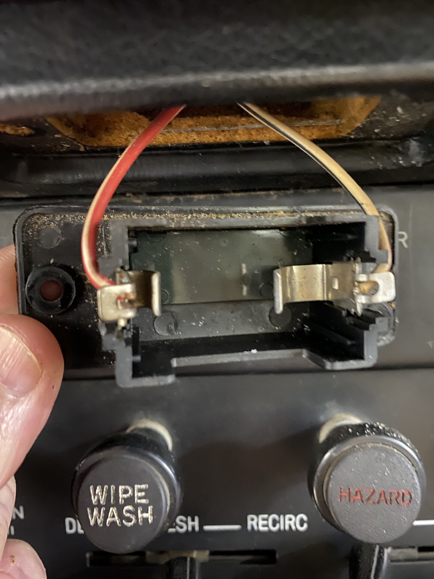

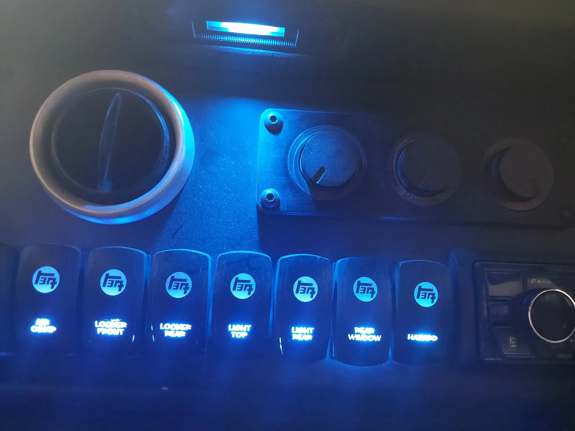

Here are some photos of the dash light (or whatever it's called). The bulb measures 1.068" or around 27mm long.
Anxious to see if you come up with a brighter replacement bulb for that under dash light. You'll find the plug for the inspection lamp in the engine compartment. Mine is over the driver fender.
I think you're right. Been a while since I went looking for it.
How bout a pic from the drivers seat with the light on. the close up pics don't represent real use. And is that the stock bulb or one of them new fandangeled acronym bulbs. pics are 🐂💩🤨🤔😯😲😳😘
