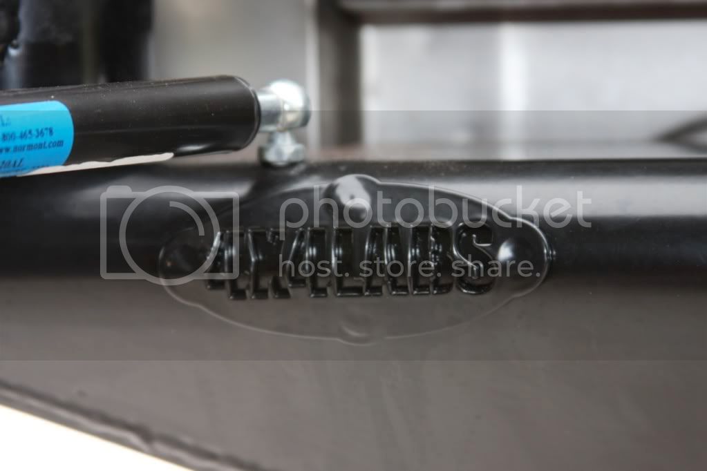

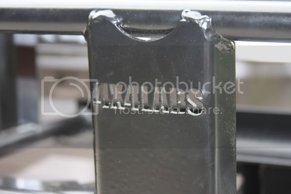

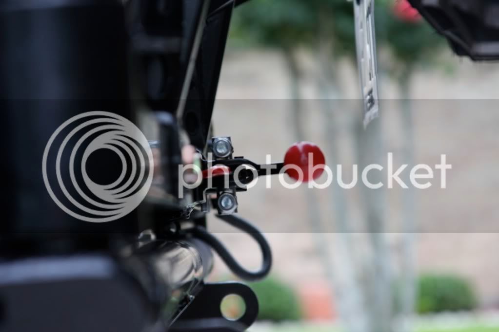

Got a package from Luke @ 4x4labs and got it mounted over the weekend. His quality and attention to details I've heard about but to see it for myself... Its a work of art. :cool:

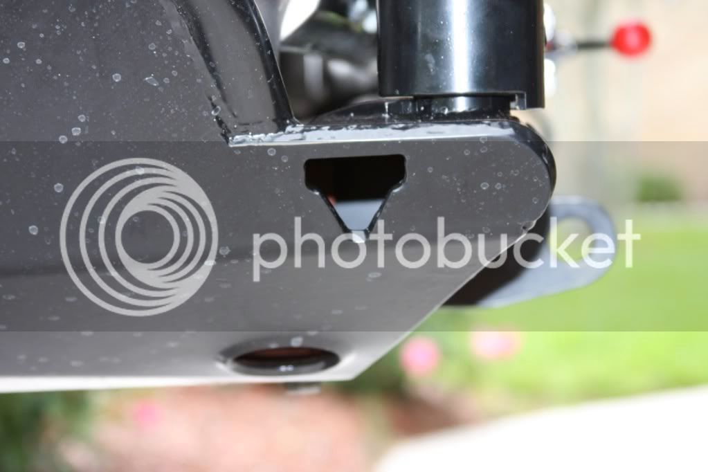

I now have 3 bottle openers! I mean who really needs 3? :D

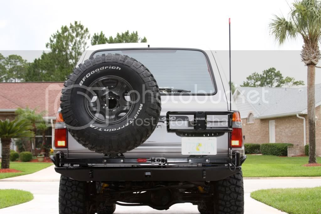

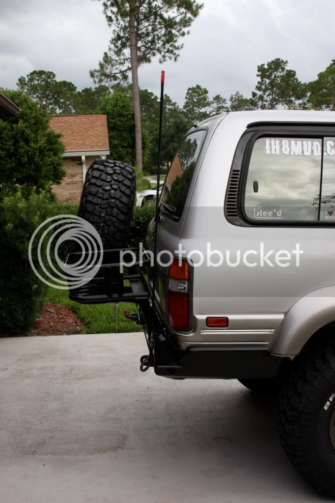

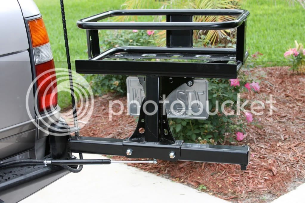

Got my firestick mounted and Im happy with the look. Not really noticeable however still provides good transmission and reception.

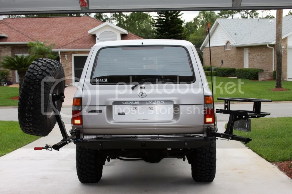

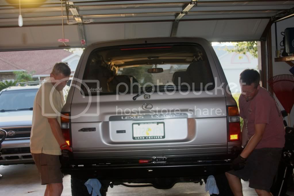

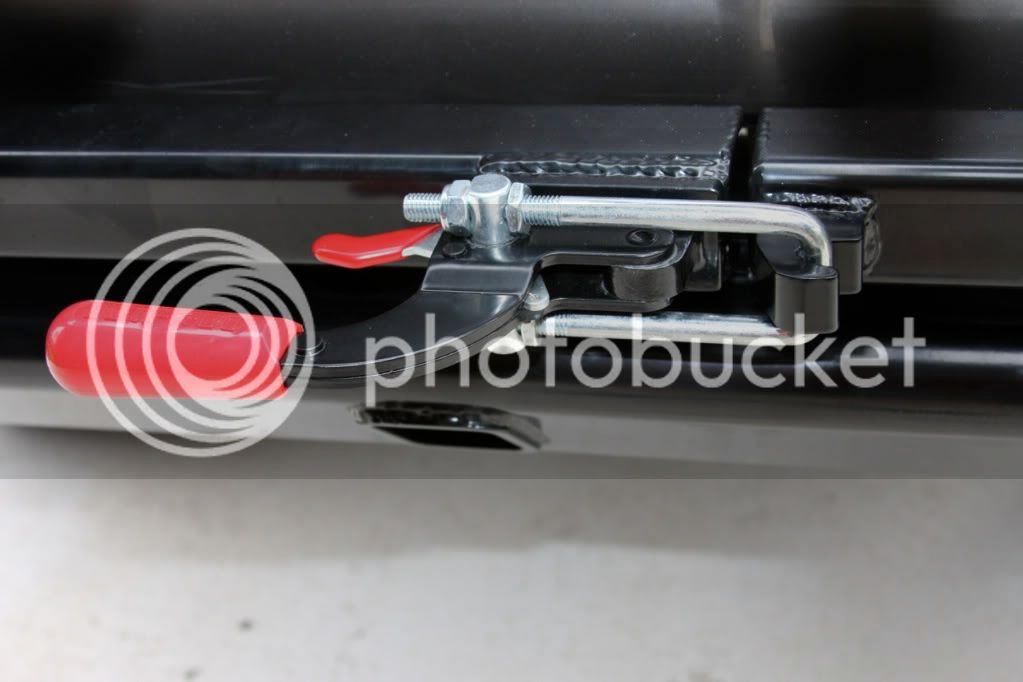

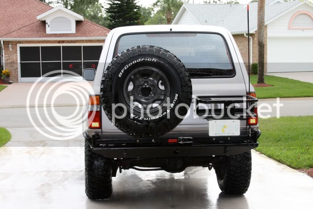

Word to the wise. make sure you have someone to help you install it. Its heavy, HEAVY, 225 LBS HEAVY!!! My Dad came down from GA to visit so I got him to help me install it.

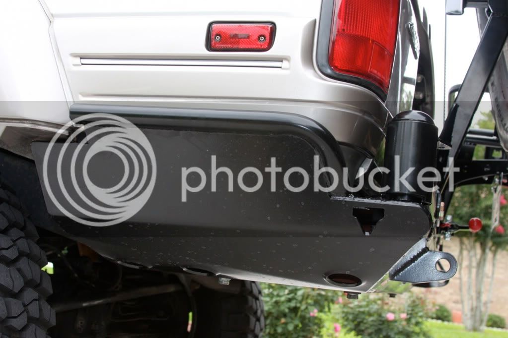

Two areas where I had to mod the bumper:

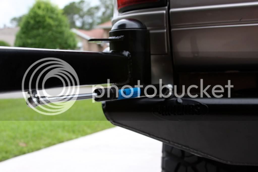

  • One was the stop for the swingouts was to high. It came in contact with the rear tailgate body cladding. I just used a flap wheel and shaved it down. Then I brushed on some duplicolor bed liner and it looks like new.
  • The 2nd was every bolt hole had to be re-drilled because of the powder coating. This was not a huge deal just made getting it mounted take 1 hour longer than it would have otherwise
Overall:
I love the bumper and would buy it again. I cannot wait to get it off-road soon!!

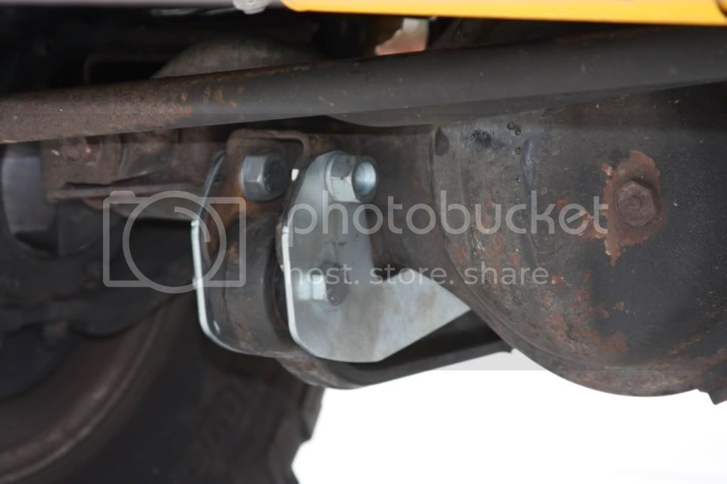

Suspension
I also did some modding to my suspension:
Was running OME 851 (with 1 inch spacer) and OME 863's. I was also using MAF caster drop brackets.
I opted to go with 850J's with no spacers and use SLEE's caster plates. I like this combo much better.
I think the difference in the spring rate before made for a weird ride. The front felt sloppy (was running OME Long shocks on all 4 corners)
Now the ride feels positive and way I like it. The combo of the J's and 863's is perfect for my tastes. Nice and level.

One question, where did you route the coax for the antenna?
I routed it down the PS of the truck under the kick plates. There is a drain at the rear of the truck that I routed it through. The drain still drains and I did not have to the drill any new holes.
Very nice! Im plotting a rear bumper as well on my 80 but cant come up with the pros/cons of a singe versus double swing gate. Is that "V" not a universal bottle opener?

There should only be 1 bottle opener-on the side of the basket. The holes in the bumper body are for the nose of the hi-lift.

that makes sense. I was wondering why 3 now that makes it even better. :doh:
