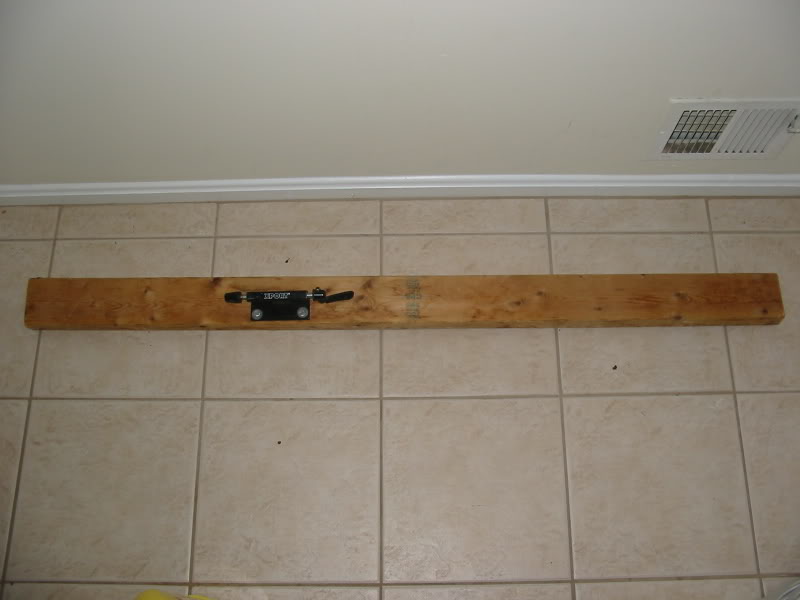

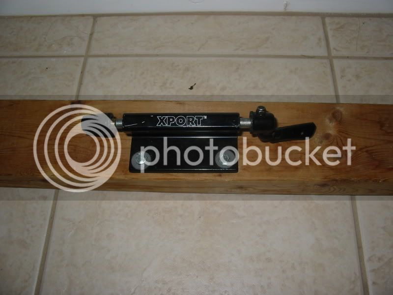

its a homebuilt rack. the fork mount takes 2 bolts and bolts to any flat surface. then just use a nylon stram to secure the rear tire

My interior bike rack. You have to fold down the second row seats though. Total $10 since I had the wood at home.
