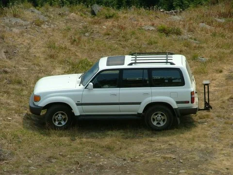

Yakima
not perfect but hopefully you can see there is more than enough space for even my 37" tire to fit in between. I've put it up there just to make sure for the time I finally get a rear bumper...
the other nice feature is that on that rack in the pic is (1) Adam's folding trail-a-bike (2) GF Sugar (3) Specialized SJer & (4) Trek Mystic? - small frame child's bike. Pretty versatile!
