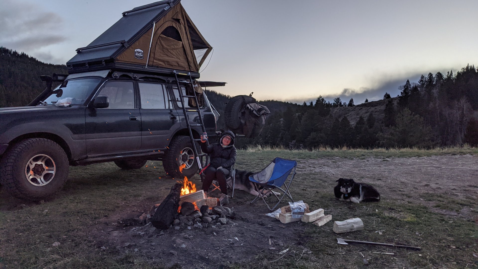

Going to post this up since I haven't seen anyone talk about the double channel here on mud or really any other place online.
Here is the Cascadia Vehicle Tents Mt. Hood 56" double channel roof top tent on my 97 LX450.
I wouldn't call this a review at this point since my wife and I have a whopping 1 (yes 1) night in this thing, but I am going to keep this thread updated for those of you that are interested in this tent so in time it will morph into a review. As of right now lets call this post a factoid about the tent. Purchased this back in February for 20% off, if you watch their Instagram they will randomly do sales and we definitely hopped on the band wagon. I had been eyeing this tent for quite some time, and in my opinion this tent is kind of a jack of all trades much like my 80. Thin enough, light enough, roomy enough... It checked off most the boxes on my list, more so than any other tent on the market. Even without the sale this was the tent I wanted to get.
It is an aluminum clamshell style tent that weighs in at ~150 lbs (They're claim and I didn't weigh it but it also didn't take much effort for me and a buddy to move it around). Its sides are an aluminum extrusion. It has 1 slot around the rim on the top half of the clamshell and 2 slots on the lower half hence the name Double Channel. They do offer a slimmer "Single Channel" version that is 6.25" thick. I chose the double channel to make closing with pillows and sleeping bags easier. I already get 10-12 mpg, wasn't worried about the extra 2" of wind drag. The tent also doubles as a roof rack and comes with 2 cross bars that can be installed on the top half. They say you can keep 150 lbs up there on the load bars and while I likely never will, based on how stout this thing is I believe them but you probably wouldn't want to open it with that much on top.
Interior dimensions 82"x 53"x 55" (55 is the interior height to the peak)
Exterior dimensions 85"x 56"x 9.75" (The height is really 8.25", they include their roof rack crossbars in the height that are supplied with the tent but don't have to be installed, I didn't install them)
All the hardware included and the struts are stainless steel. The latches are a draw style latch and make closing the tent much easier than competitors tents. The tent has a bungy cord that goes around the fabric to help keep the fabric in while shutting the tent. I can shut the tent without ever hopping off the tailgate to fold fabric in on the side. The ladder is solid and you can enter from any of the three sides. I placed the ladder safety hooks on the driver side and centered on the rear so that we can enter from under the tents built in awning if its raining and the ladder does not interfere with the driver rear door. One thing I am going to do with the ladder safety hooks is put heat shrink around them because when the truck moves the ladder on hook movement makes a squeak.

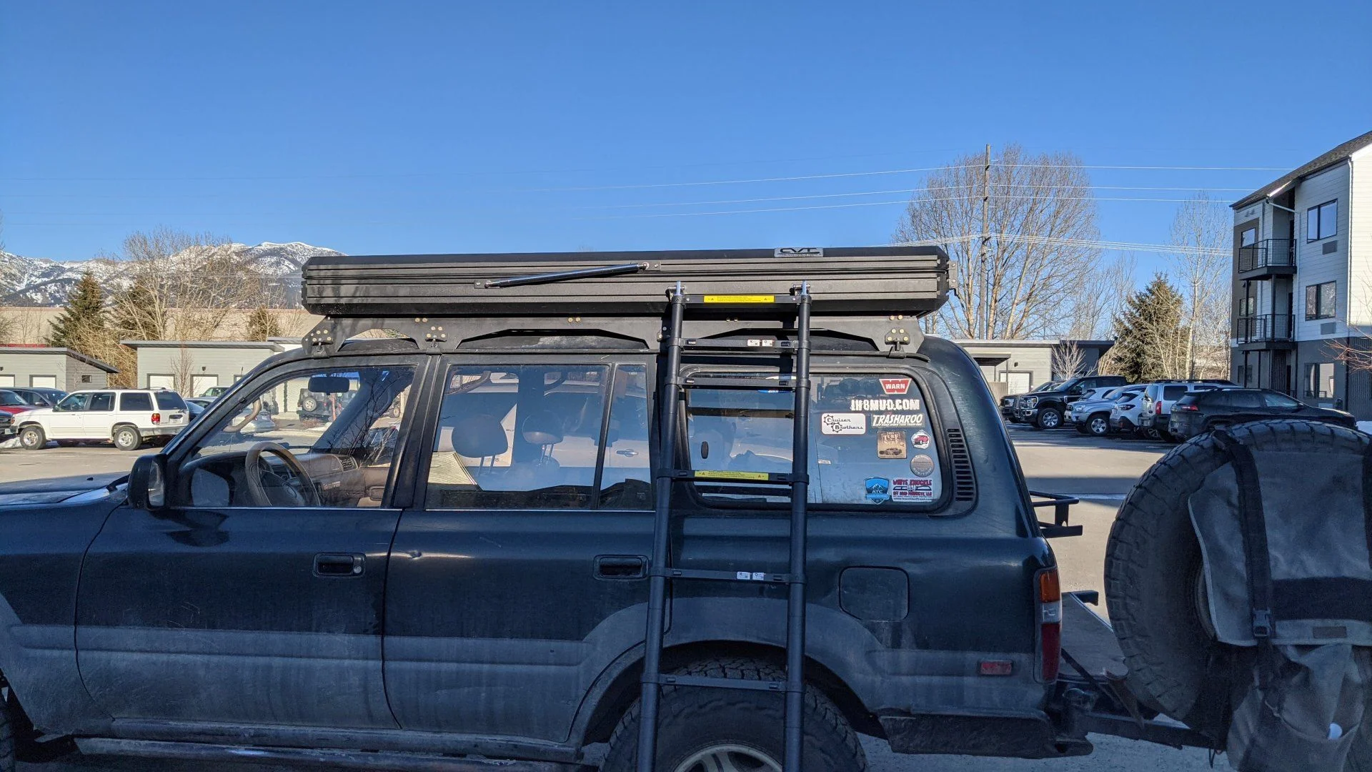

Thanks! That is a 1 of a kind roof rack built by me. It used to have 10 cross bars but I removed a bunch down to 4 bars to save weight when putting the tent up since it really doesnt need 10. The rack probably weighs 40 ish lbs at this point and sit 1/4" off the roofs tallest point (I also removed the lx450 luggage rub rails from under the stock rack) so all in all the top of the tent only sits 9" from the roofs tallest point and the rod vault just a few more above that. The also made super sturdy custom brackets to mount the tent to the roof rack becuase I wasn't a fan of their hardware. The hardware they supplied is sufficient but it could be better. When looking up cvt reviews I read all of what you had posted and the evolution is quite something. I think over time I will agree with you about the window mesh but like you said it is getting nit picky!

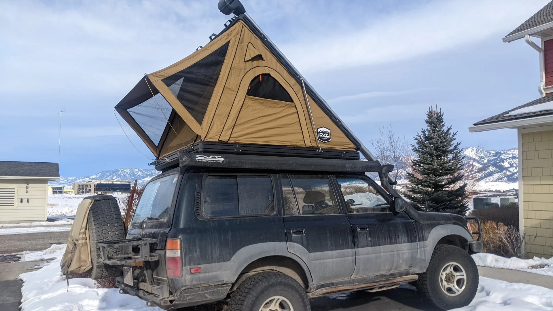

And for the heck of it here's some more photos
Wow, that is a well designed & attractive roof rack, IMHO. I like the way you spaced the gutter mount points to avoid possible door interference with the clamps. Comparing pics of yours with my Prinsu, and what I've seen with Bowfin, I like yours better. It looks like underside rack access is better. Which is important when mounting things to it.
Wow thank you so much, built it a few years ago when prinsu was the only thing on the market. It was still difficult to mount but wasn't too bad. With prinsu/bowfin the way to install these things is to remove bars you are going to clamp/bolt the tent too from the roof rack. Install those onto the tent with the tent upside down, measure to get all your left to right and front to back positions of the bars, then bolt up to the tent. After that lift the tent, shuffle it into place and then put the side bolts for the bars back in. That method makes tent mounting easy. I was able to do that for the middle two bars and left the front and rear for the tent to rest on, and then those got bolted up. Total time was about an hour to mount.
