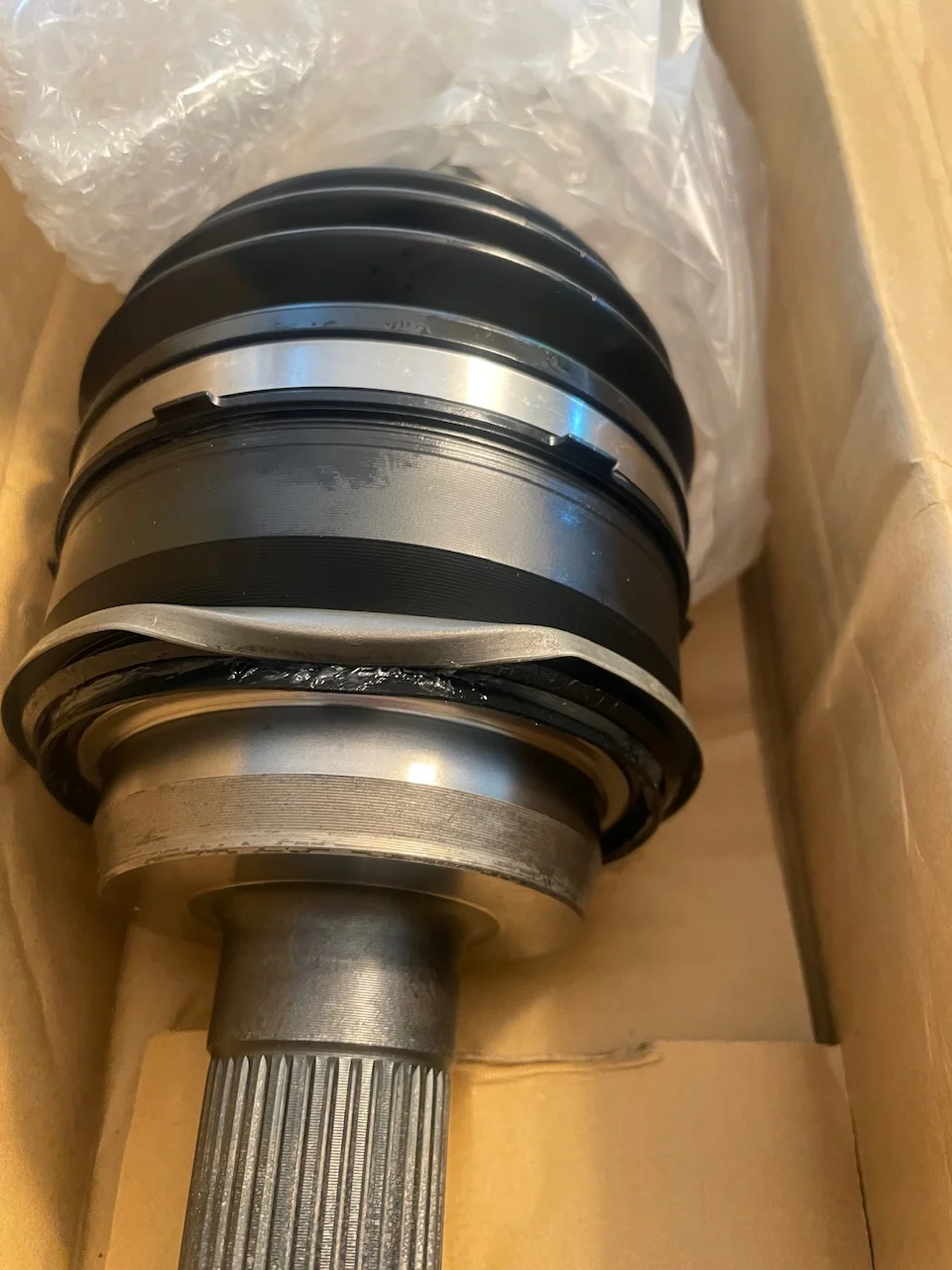

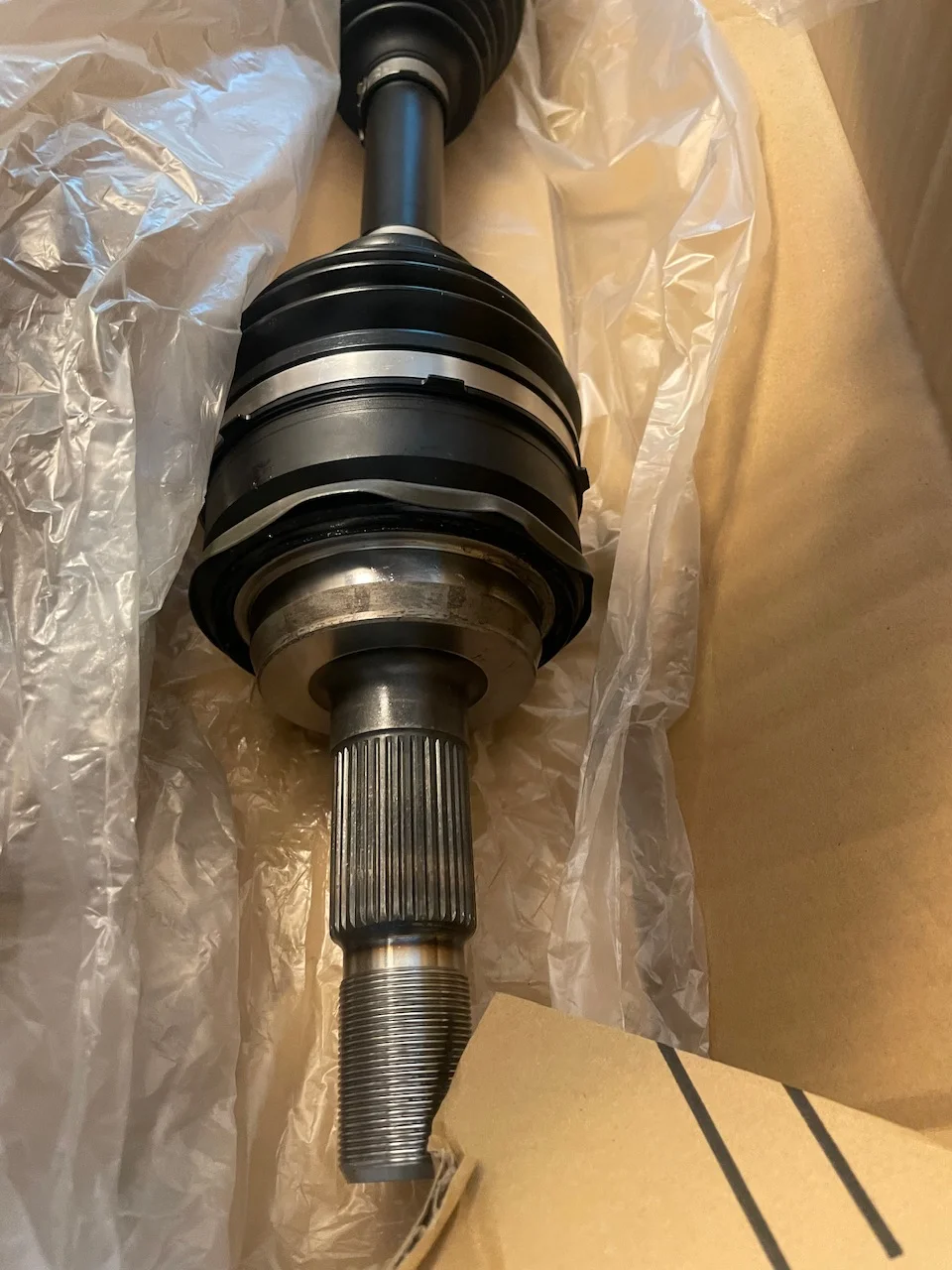

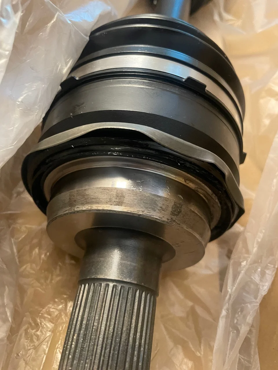

Here’s what the ones I sent back look like. Do you think I can just bend them back with a pliers good enough?
Mine was dented but not nearly as bad. I think mine can easily be bent back with pliers. That said they can send you the metal dust ring separately if you can figure out how to install it without the SST, just ask. You can try to bend them back but yours look pretty bad

If they didn't damage the rubber seal, you could straighten them acceptably, although admittedly those are worse than the ones I have gotten. I used a small pair of pliers to pry out the dents, then a small hammer to tap down the high spots.
Mine didn't look nearly that bad.

Agreed. They said they will refund my money because they don’t think these parts can be shipped w/out damage. They ordered two more from Toyota and they were damaged in the same way. Hard to go further with them when they are willing to take the parts back and give total refund.
I decided to punt and get my money refunded. Serra was good about that. My local price is $100 more per axle. A new dust cover is $30 but I have to remove and install the new one which would need a press and SST or homebrew SST and also come with the risk if damaging the seal which would then also need to be replaced. I just decided to not jack with all that to save a small amount of money.
I imaging that the local ones will still have a good chance of some damage but I'll be able to see what I'm getting before I pay and decide if its minor enough to just bend back. A little bit of bent cover isn't a big deal.

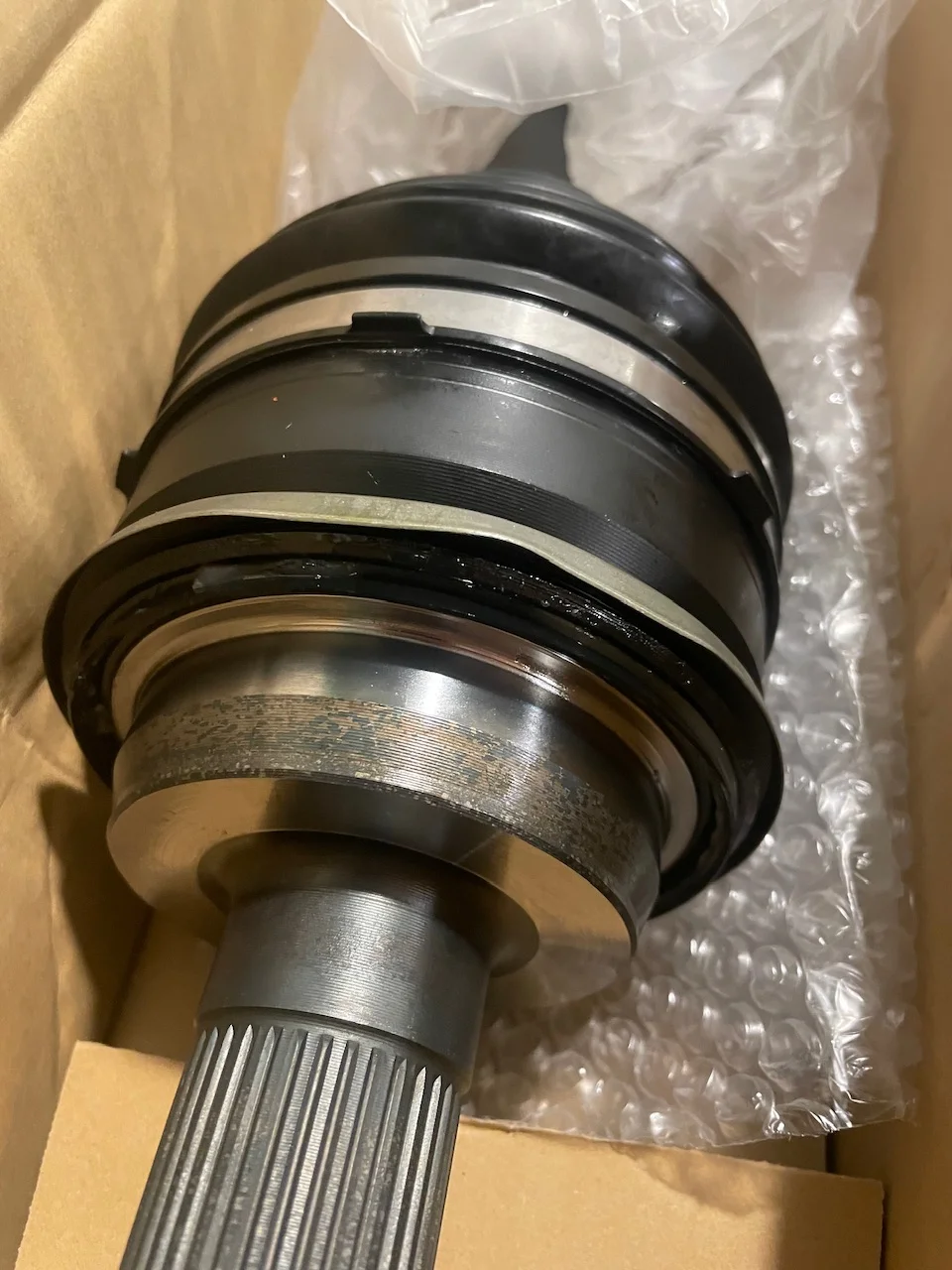

New CV from Olathe Toyota:
Much better than the Serra CVs but not perfect. The dust covers don’t need to be perfect. I don’t think I’ll even try to bend this back.

Looks almost identical to mine I got from Olathe late week.
Seems not that big of a deal, but yes, frustrating
