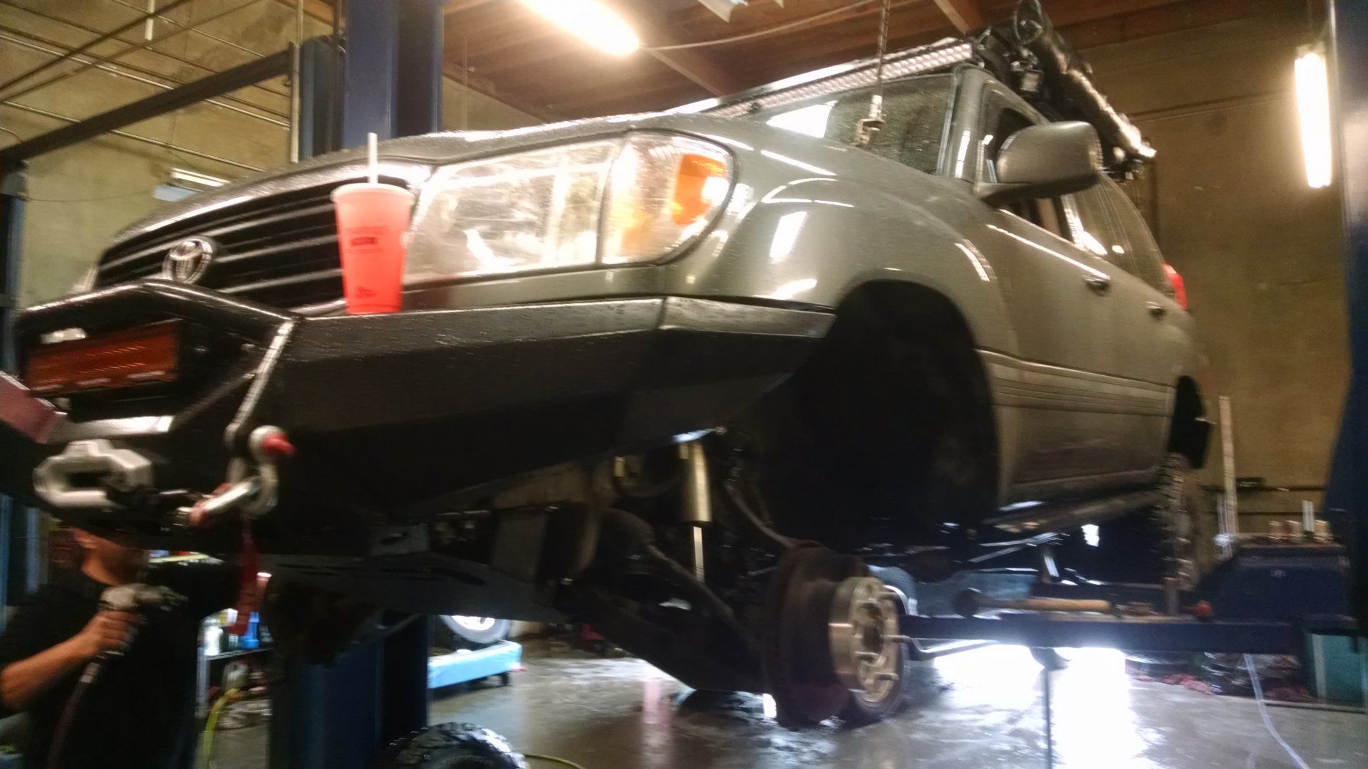

Hey Group,
After a torn boot, I've had my OEM CV's swapped with some aftermarket "stock replacement" axles and am experiencing on throttle vibrations. My mechanic suspects that the new CV's somehow are not able to handle the angle of misalignment when on throttle weight transfer causes front suspension droop and this is causing the shaking. With another of these aftermarket axles, he measured that it can take about 24° before binding and the angle that the ones on my truck are currently at about 26°.
What is the best front CV solution for these trucks? Do the OEM Toyota CV's offer greater angle range or is there some designed to fix this problem with lifted trucks?
Thanks for the help,
Will
