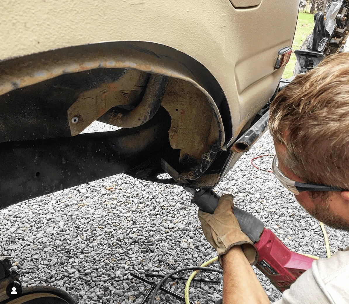

Rears:
1. Chop the wells following the line of the door.

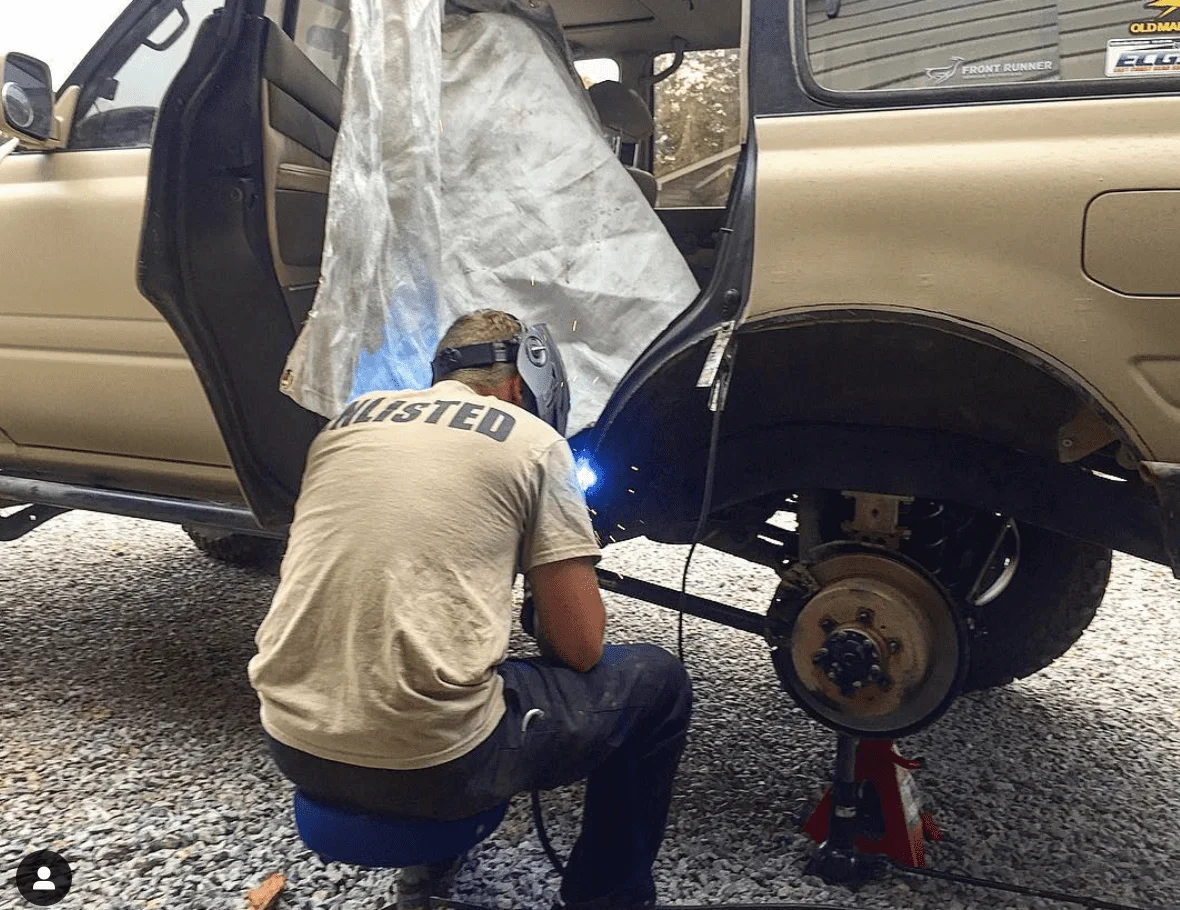

2. This will cause a gap the body panel and wheel well and that opens into the cabin
2033110

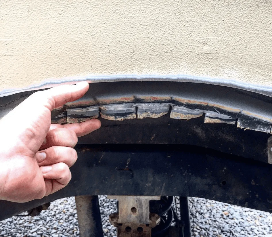

3. Pizza cut the wheel well and tack it in place, you'll still have a gap and if you're lazy like me you can cover that in fiberglass and flex seal.
2033109

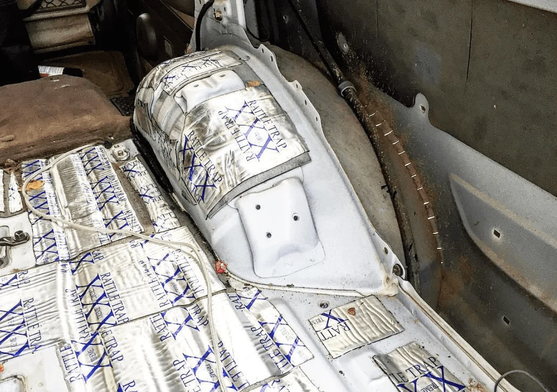

4. What it looks like from the inside of the cab after welded. Fix to your liking (or like in step 3, be lazy like me :) )
2033116

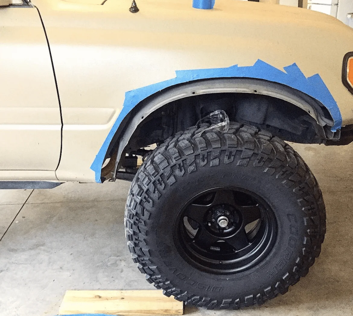

Here is a look at my front - my front chop has since gone much more aggressive when I went to 40s but this will give you the idea.
1. I drew a line around 2.5" above my wheel well
2. Disconnected the wheel well from the body panel (you can also just chop this if your bolts are too rusty)
3. I sliced with an angle iron vs. sawzall to go a bit slower
4. Final cut looks like this (on the body)
