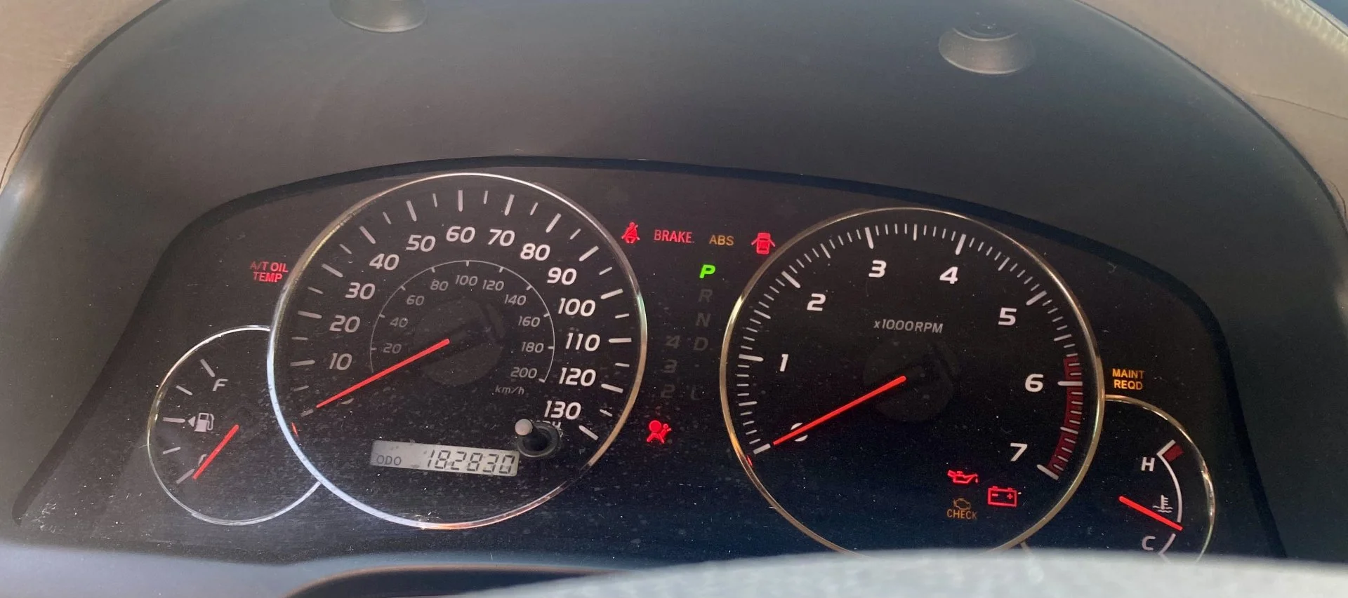

I noticed my battery light had come on while in line to get coffee this morning . Immediately shut it down upon noticing . 5 minutes later she started up just fine with no warning light . Then about 2 miles down the road the whole dash lit up including battery . I was close to my moms house so headed in that direction and made it luckily . Shut her down again and started searching for loose connections and bad fuses . Found nothing and now I only get the dreaded clicking when trying to start . FYI I replaced my alternator and battery less than one year ago . All indications point to the alternator but why are all my lights lit up ? Could it be something else ?
The computers aren't happy with lower voltage than normal. Last time my battery died I couldn't turn my headlights off. As soon as the battery charged up it was fine. Sounds like you need an alternator and maybe a new battery and you should be good to go
Thank you for the reply . I’m hoping the Christmas tree dash is just a symptom of the low voltage . Heading back that way with a voltmeter and a battery charger now .
Put it on a charge and all lights did indeed disappear . Looks like my remanufactured denso alternator lasted just over 1 year . Bummer
