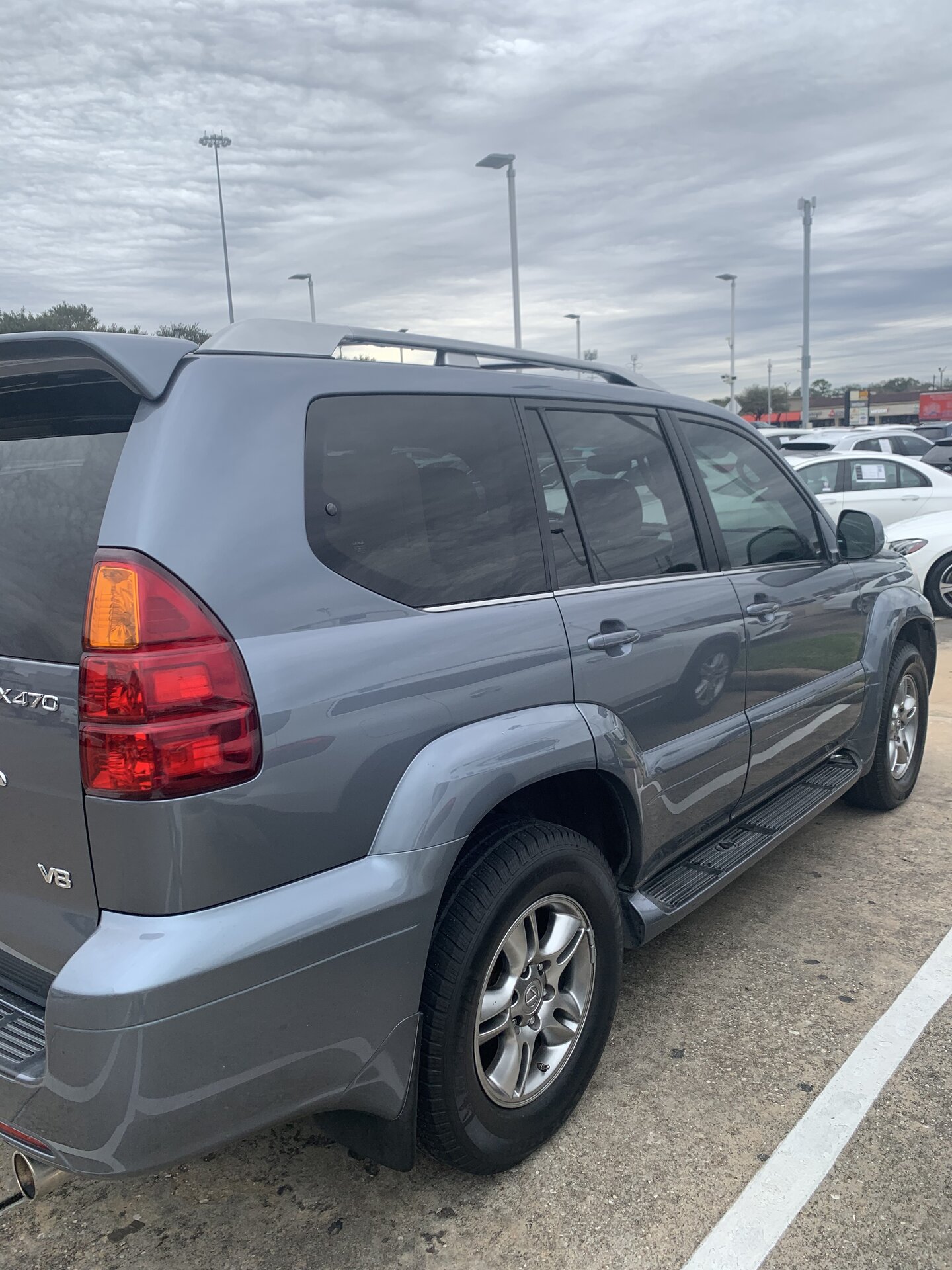

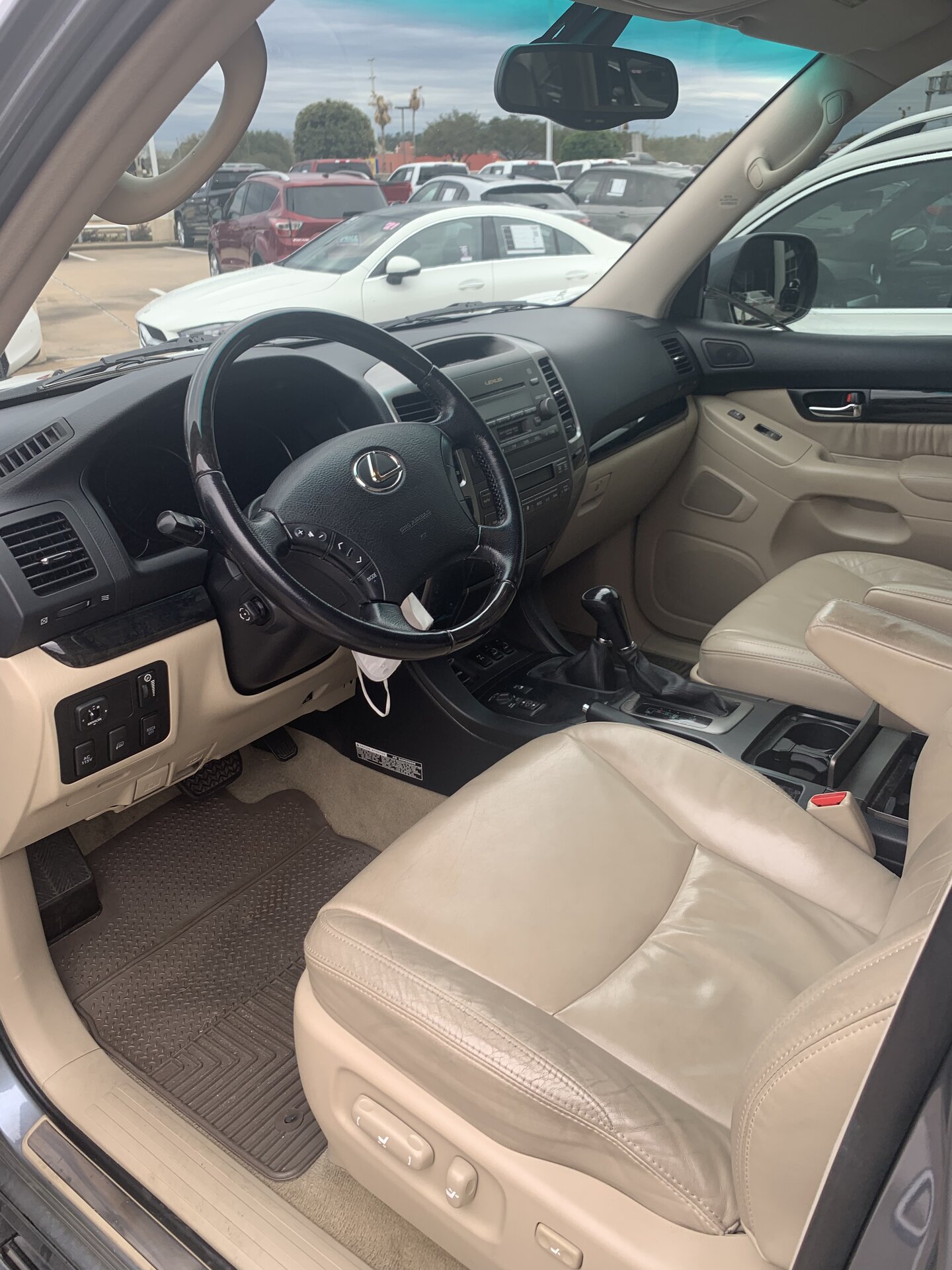

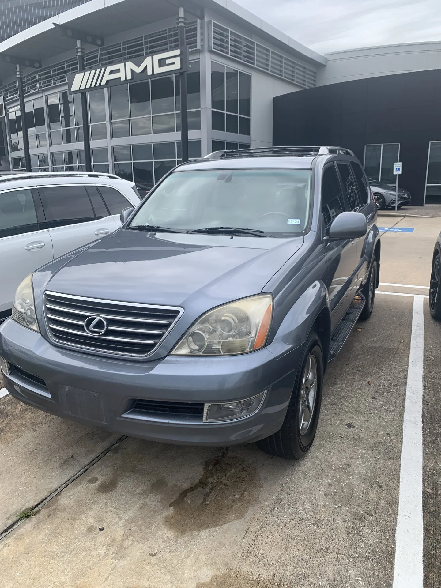

Finally time to start a build thread. I picked up a single owner 2005 GX470 with 130,000 miles. This thing is immaculate, no interior issues, all maintenance at the Lexus dealership, just an absolute gem. After searching for about 4 months, I couldn’t pass on it. It has KDSS, I know some dislike that, but I’m willing to be happy with it.

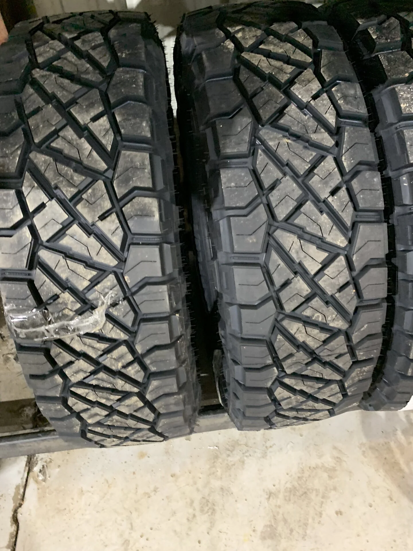

For tires, I selected Nitto Grapplers 255/80 on the stock rims. I actually like the Pizza Cutters look.

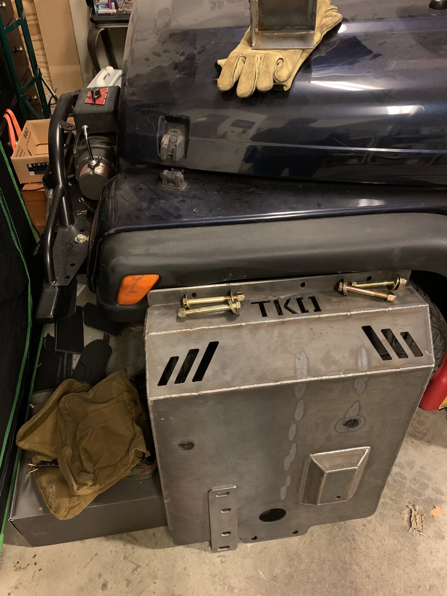

I ordered some Steel skid plates from TKO over in Georgia. A solid product, and the owner is a cool person. Still waiting on the Sliders and Repalcement rear bumper to arrive, but after seeing the Skid plates, im fine waiting since they are built well.

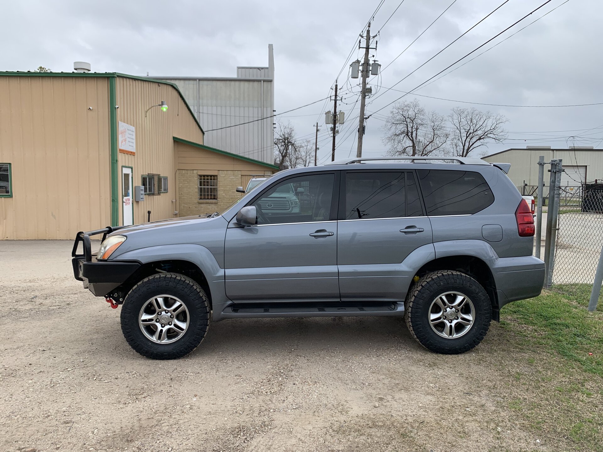

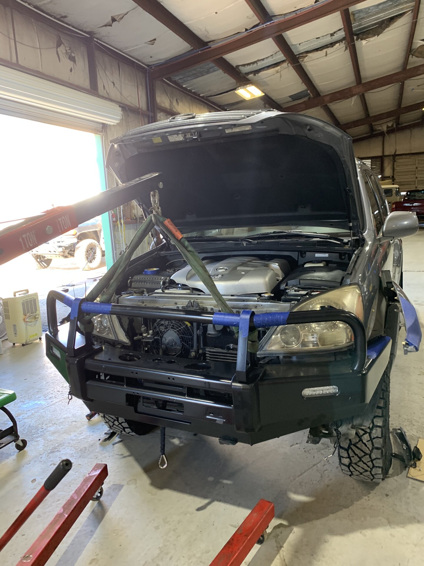

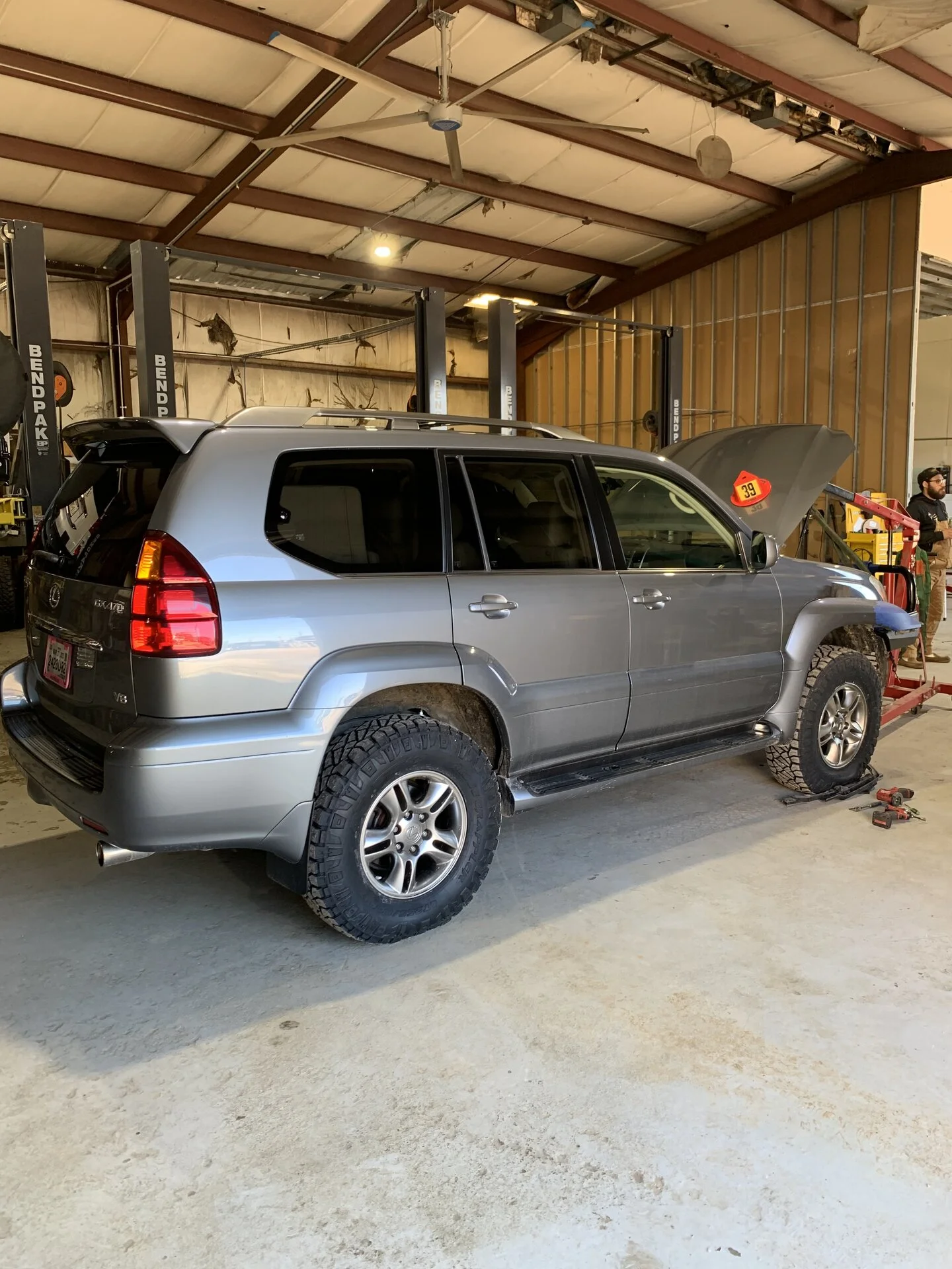

Working on my way towards progression. The guys at Duggys Garage here in Houston have been doing excellent work.

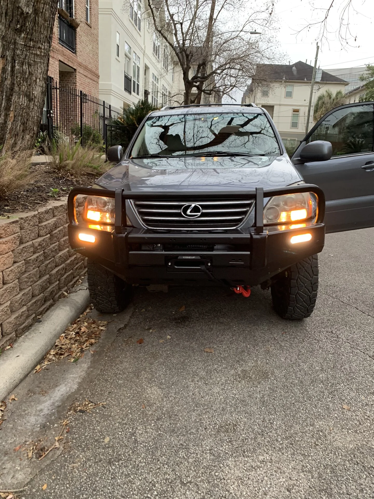

Got the Dobinson Front bumper and Comeup 9.5k Winch installed. The detail work on the cutting for the bumper was top notch and included me in all the steps to ensure I was happy with the progress.
I am dealing with a bit of KDSS lean after getting the lift installed, so that will be an avenue I will have to pursue.
