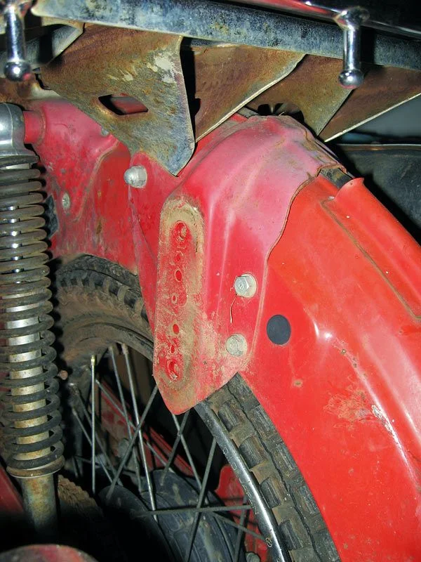

If you have to build it, mount it to the rack would ya. Like the others have said, DON'T bolt it to the fender. It is not nearly strong enough. You could hang brackets down from the rack, and use the fender as a tie in to support the bracket, but you can't use the fender to support weight. You are asking for trouble in short order.
The spot I attached to on the fender is meant to support a spare gas can already. The factory can is a bit smaller, more compact and different support, obviously... I think it'll be ok. I'm going to run it for a while as is and see how it works out. I 'm sure it will be fine.
If I do think there is a problem, I will tie it into the rack. :cheers:

Actually the factory canteen bracket is attached to a very beefy bracket that arches over the fender and ties into the same structurally hardened spots that the cargo rack attaches to. Its attachments to the lower fender, which is the only attachment point for yours, just stiffen it up a bit and spread the stress.
Oh wait, here's a pic of the one I took off and gave to Jman:
The CT90 fender is pretty strong and yours is probably fine, but maybe not. :bounce: If you have problems I would look for one of these brackets on eBay. They are one of the hardest parts to find though. :doh:
:cheers:
:hhmm: I didn't look that closely at DD's setup. You are right.
It would be pretty easy to make a new "mount" since I have more 1/2" steel.
