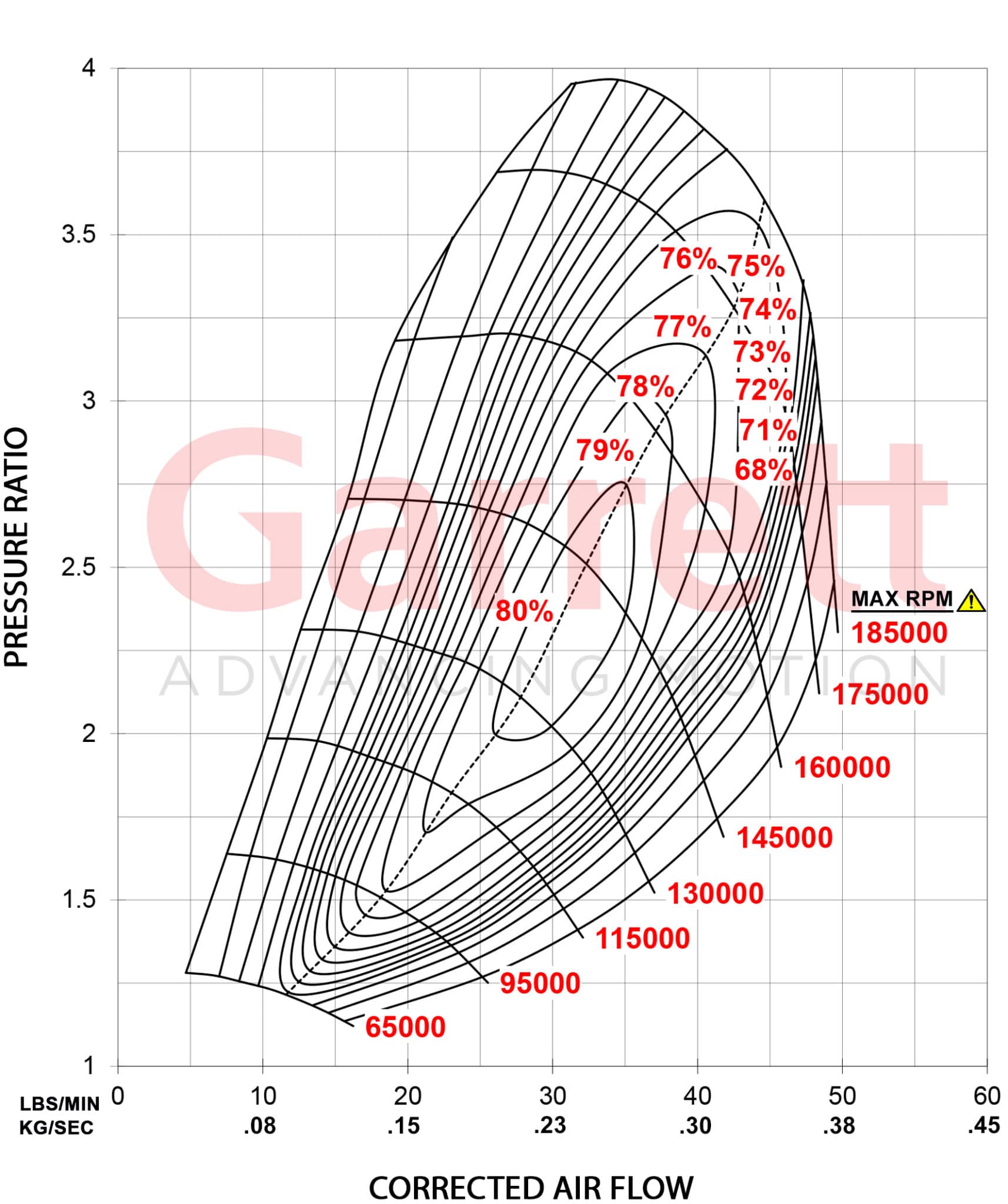

I didn’t see anything about it, but did you try any other turbos before settling on the G30-660 variant? A JDM turbo tuner I trust thinks the G25-550 may be a better match; a really fast spool with our displacement, especially with lower boost, and plenty of headroom if one wanted to crank it up with standalone and intercooling.
I’m personally interested in giving it a shot, along with standalone piggyback (full sequential, COPs, etc) while keeping the boost relatively low, as I plan to keep my rig relatively light.
A G25 turbo is going to be WAY too small. That is a 48mm compressor wheel and even Garrett only recommends it for 1.4-3.0L engines. It has been several years but I posted all of the compressor maps and where you would need to fall on the map to run say 8psi. Your shaft speed would be very high and efficiency would be maybe 68%.
They are running a Pulsar 6682 which would be between a Garrett G30-900 and G35-1050
I think the thought process was the instant spool for crawl torque, especially in low range, not necessarily power gains through the range. I guess he’s messed with smaller turbos on LS and diesels with some success. It wasn’t a deep dive by any means, just something he threw out, with how good modern turbos are nowadays. He works on a lot of Pikes Peak cars and has been messing with rock buggies lately, so he knows some things.
We have tried 4 different sizes of turbos. This kit was designed to work with a factory ecu and as such could not come on too early. We have also used this turbo in a stage 2 fashion and it does really really well and covers the whole range. Running 12 lbs right now on that truck with IC and standalone ecu and it tears up the highway. Took the Eisenhower tunnel (11K ft) last Sunday doing 80 mph without breaking a sweat in a fully built 80 on 37's and 4.56's.
