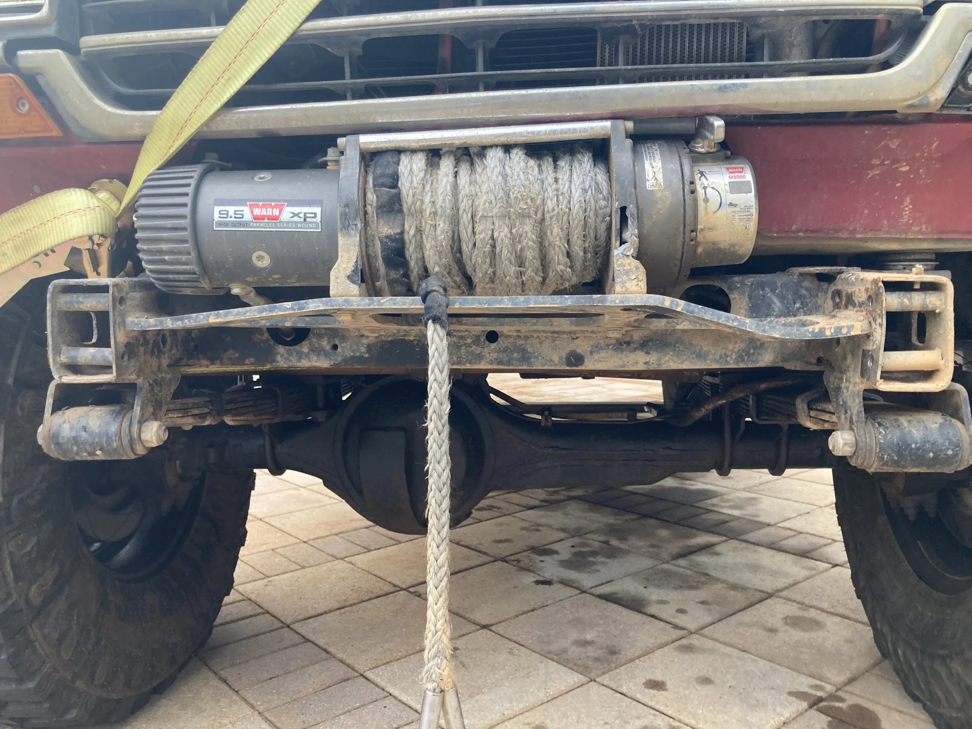

I also got the tweaked up winch mount cut out, but my frame horns are pulled inwards so i need to press them apart to get the new winch plate in.

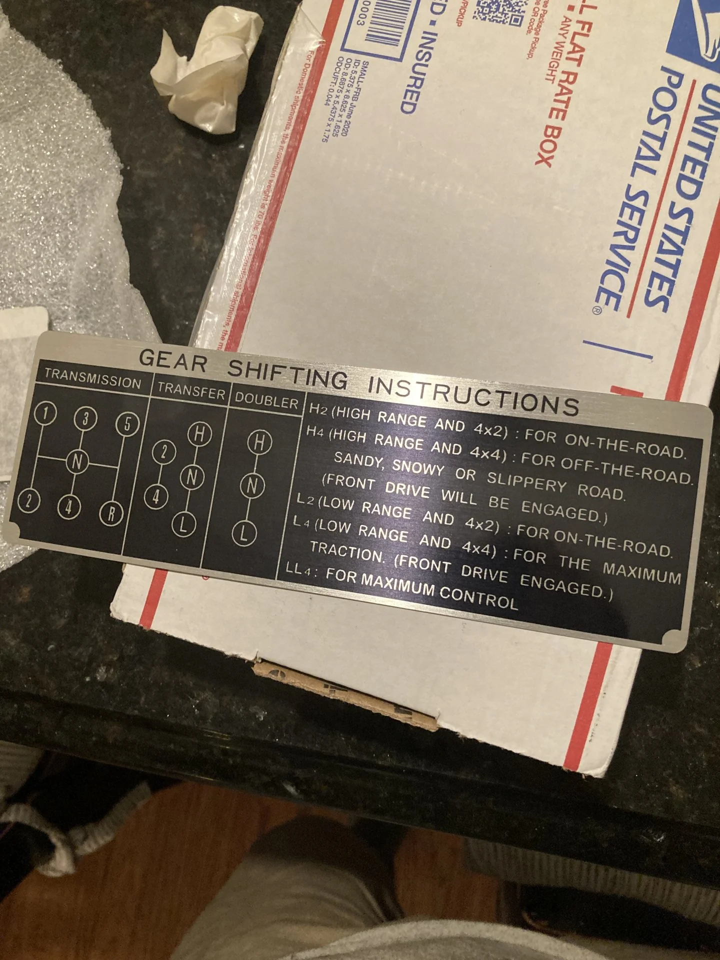

I did get a fun present from @shipmag though!

Matt, is that sticker still available or custom?
Gear shift instructions
@shipmag makes them. It’s not a sticker, it’s screen-printed stainless steel. I had him do this one custom for me but he has an entire selection available! They’re really nice!!

ah…ok. Have been needing one for the glove box on my 60. They stick on vs the metal ones for the 40

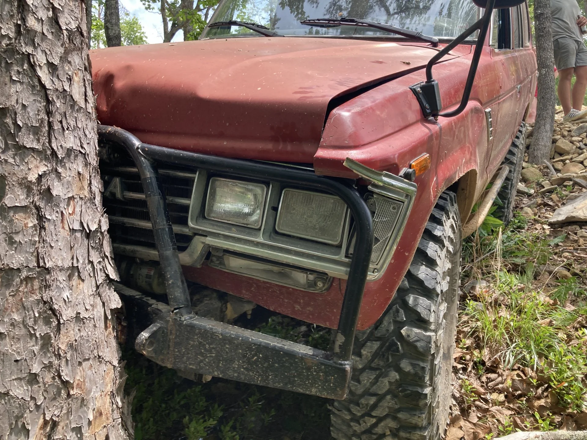

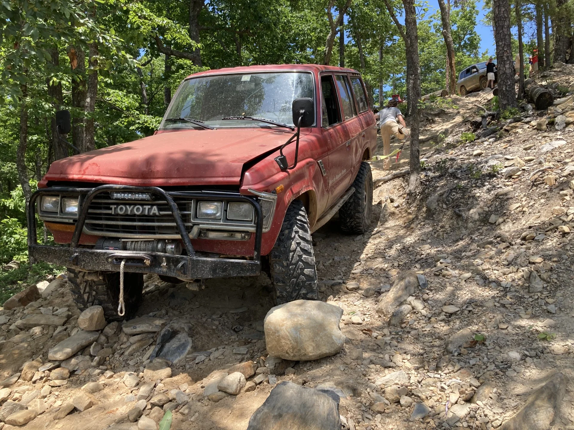

I never posted pics of my wreck, it hurts to look at but may give others some good insight into what a 30mph head-on collision into a solid tree looks like with a heavy steel bumper.

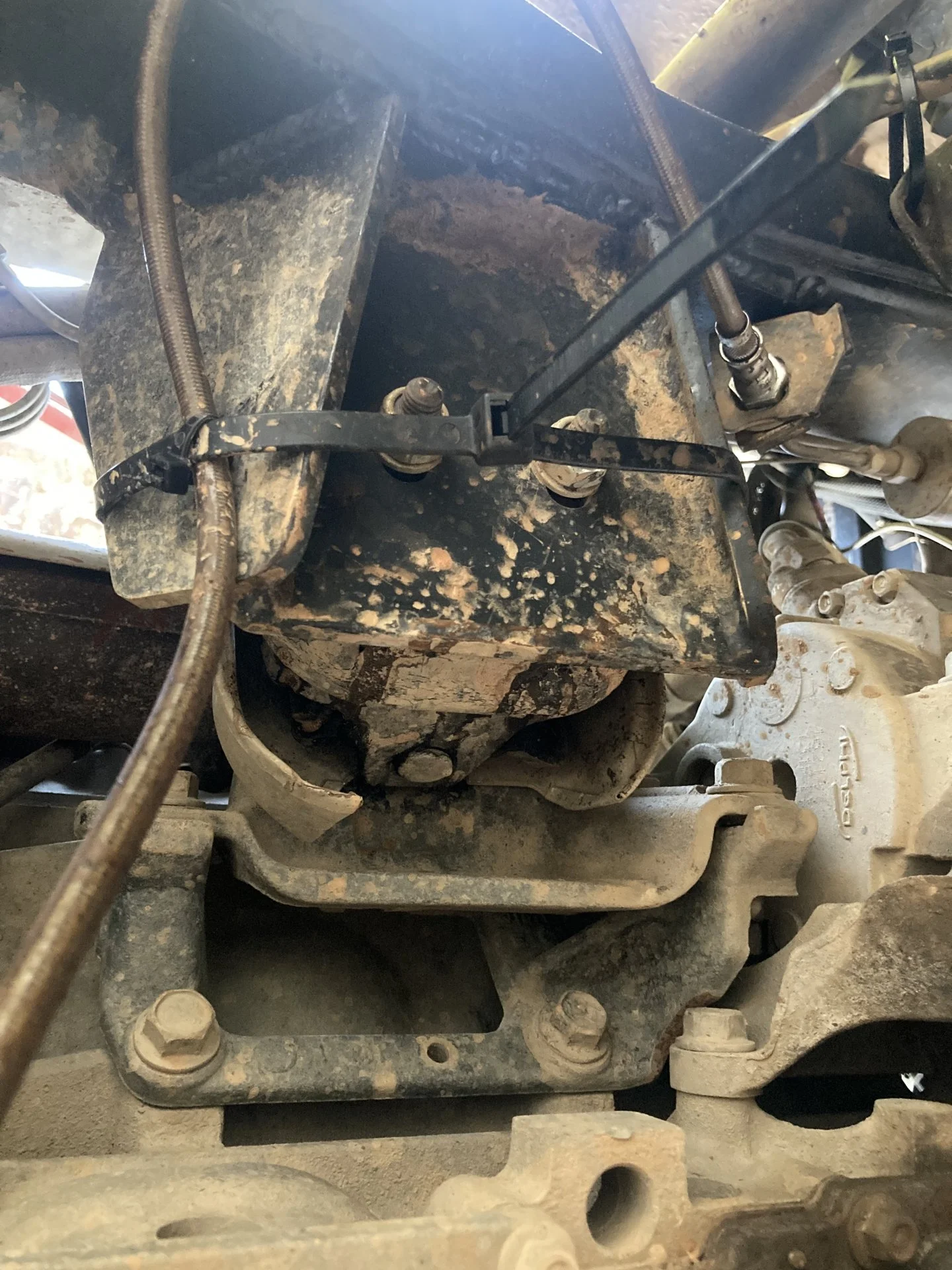

Motor mounts tweaked badly. Hard to tell in the second pic but the rubber Trailblazer mount is torn.
not sure what I am going to do about this yet. Engine still looks fine in the engine bay, might just live with it for now and cut them out and weld in a set of the swap mounts that I sell later.

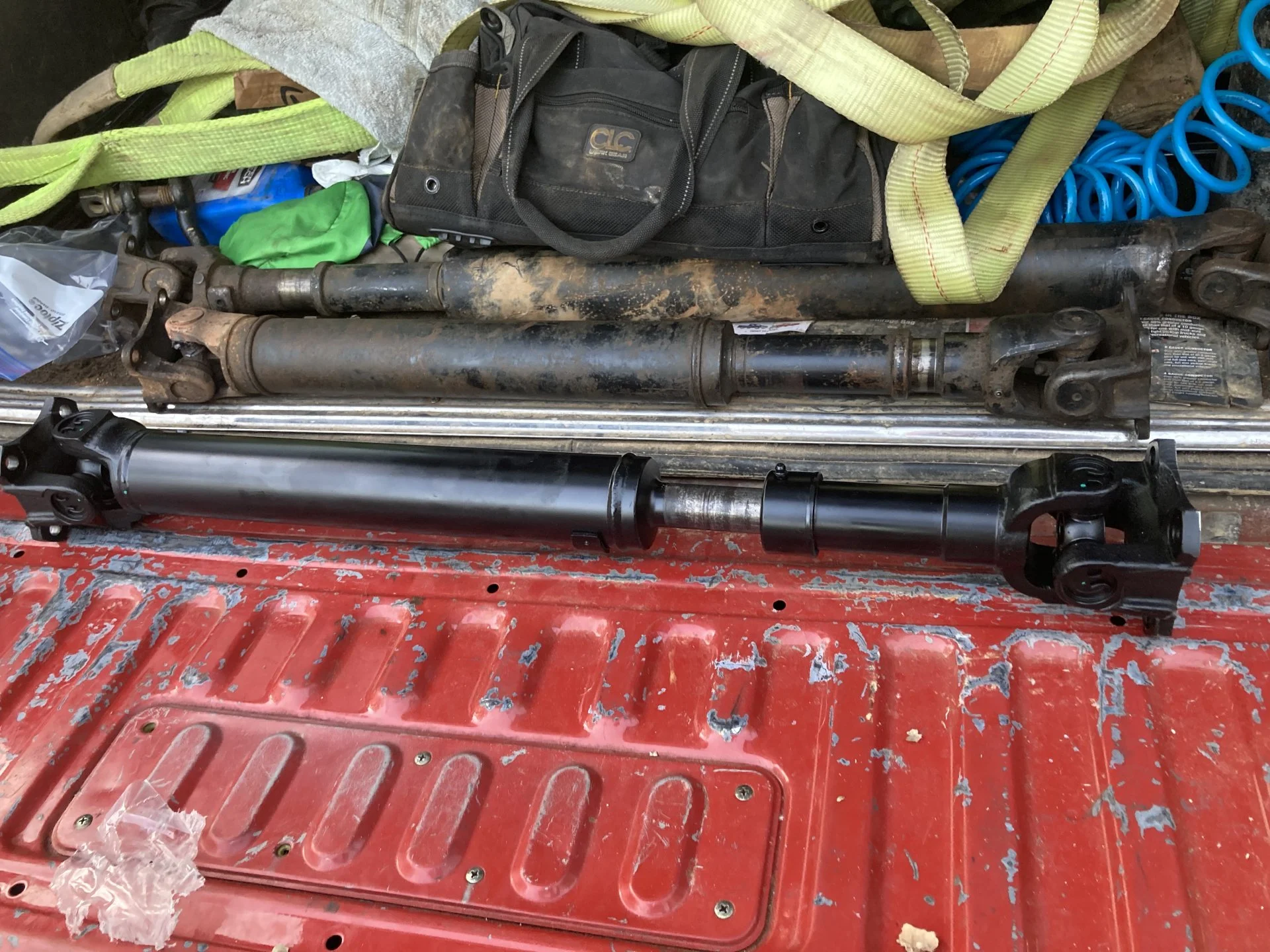

For some reason on the ride home from NC I blew out both rear u-joints. Not sure why. My best guess is that when the truck slammed down when it jumped down the hill the slip yoke fully extended and didn’t slide back together happily.
either way, both yokes got damaged so that whole driveshaft is junk. Got a new one on closeout on Rockauto for $120 so not worth dealing with a used junkyard one. (I run a Gx470 front shaft as the rear).

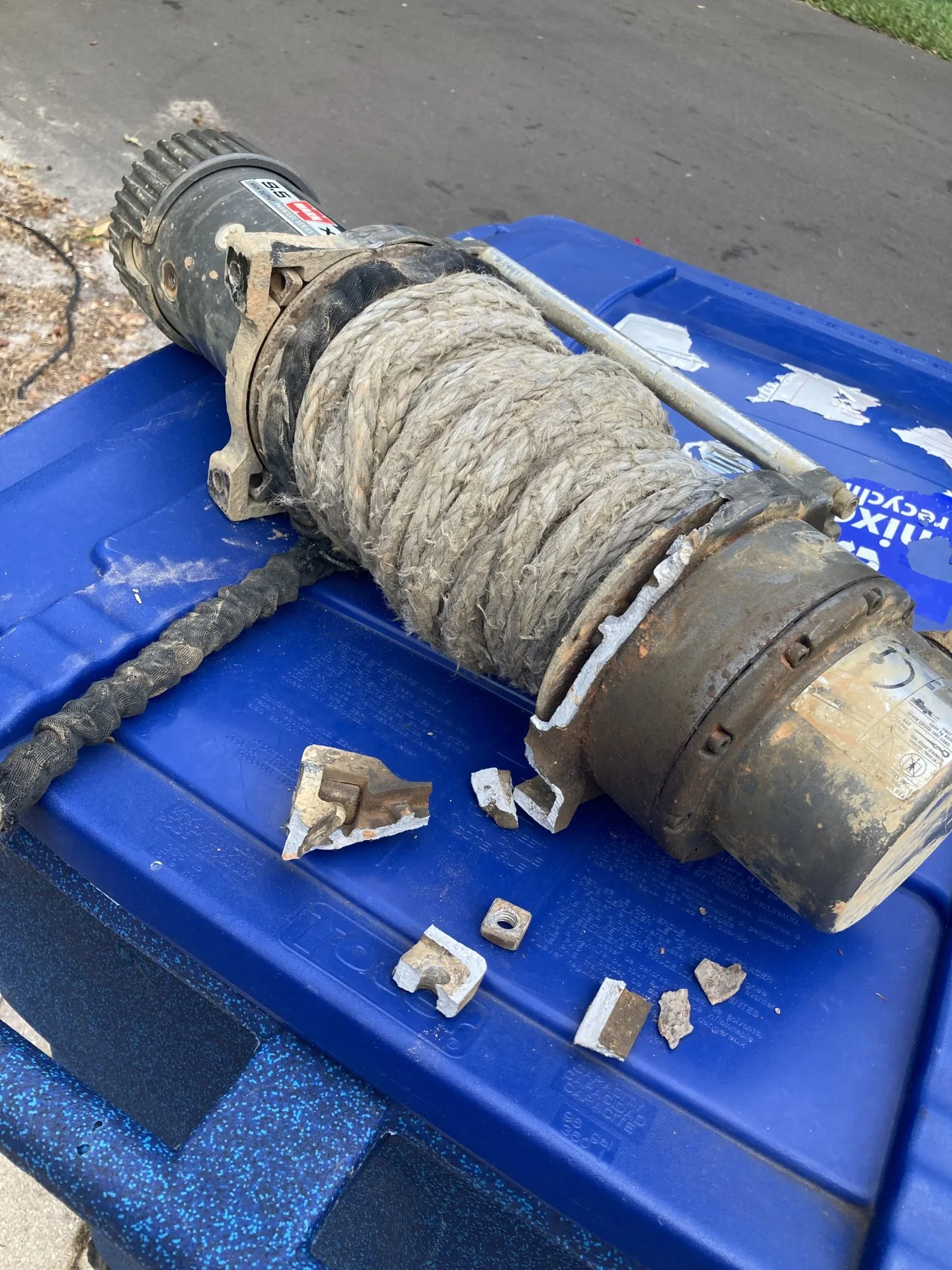

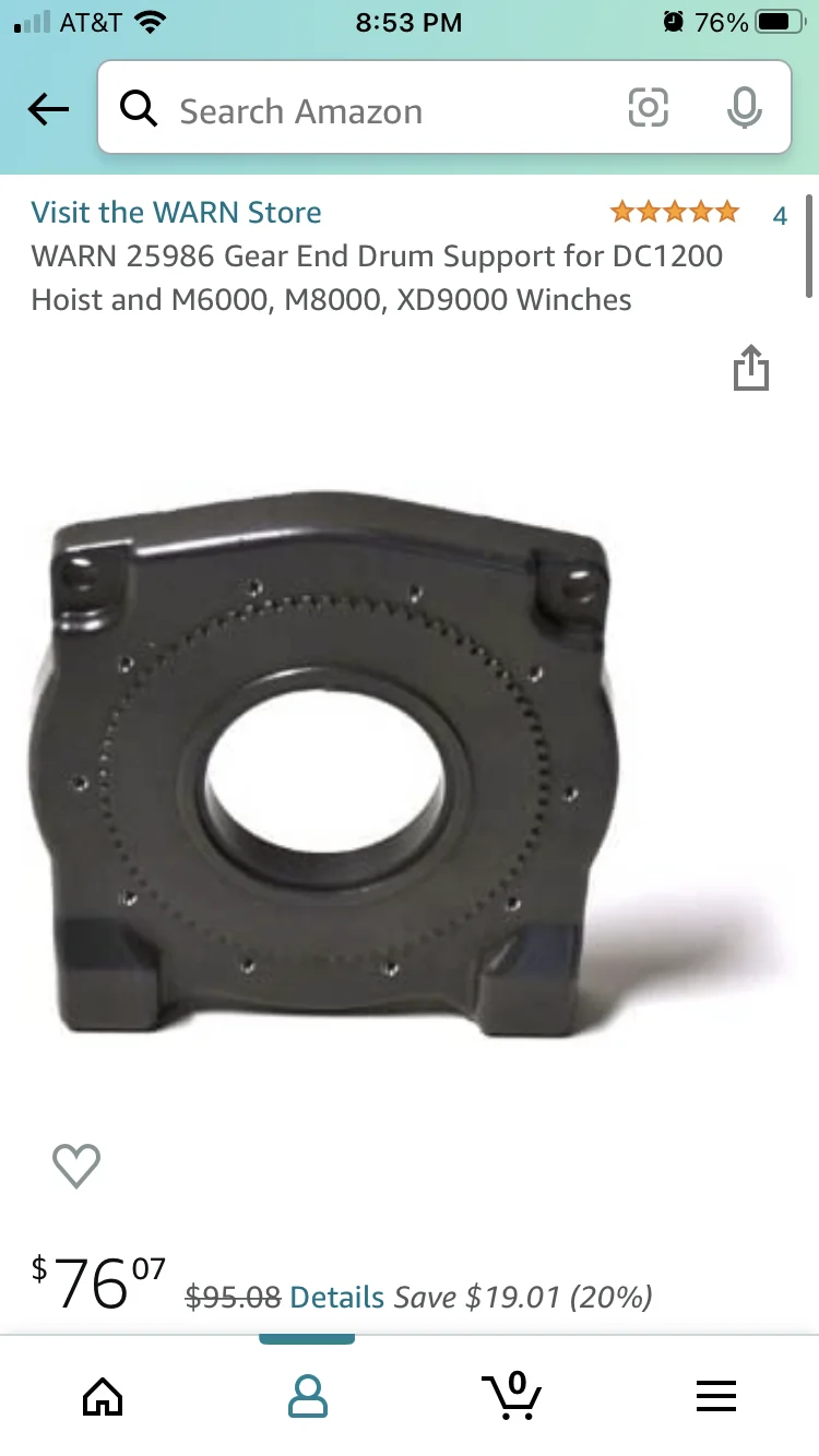

I was able to fix my broken winch for about $50 (amazon link pictured, i ended up buying the same part on Ebay though) so that was nice.

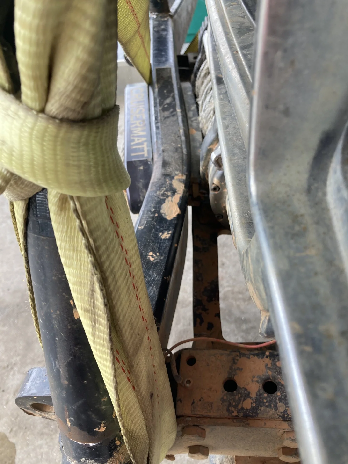

Is the frame bent?
not really from what I can tell. My front frame horns are pulled in about 1/2” from the winch plate being pushed up. All the welds held.
I will take some good pics of what my wrecked bumper mounts look like off the truck. I intentionally left a sort-of crumple zone in them that I think prevented way more damage to the truck/me.

Can you just heat up that motor mount and bend it back straight? At least you didn't crack the block or bend the frame. Sorry about the accident. Looks like a hard hit from the pics. Maybe its time to put a fj55 body on that frame:cautious:. Ill stop giving you ideas that take lots of work now. Good example of why you don't want too strong of a bumper at times.
i have daydreamed about putting a FJ55 body on it… but Id probably have even more rust issues with that then I do now!
I have another core support to swap, another hood, and two fresh fenders (from Venezuela without vents or marker lights) so I’ll be good to go for another few years.
