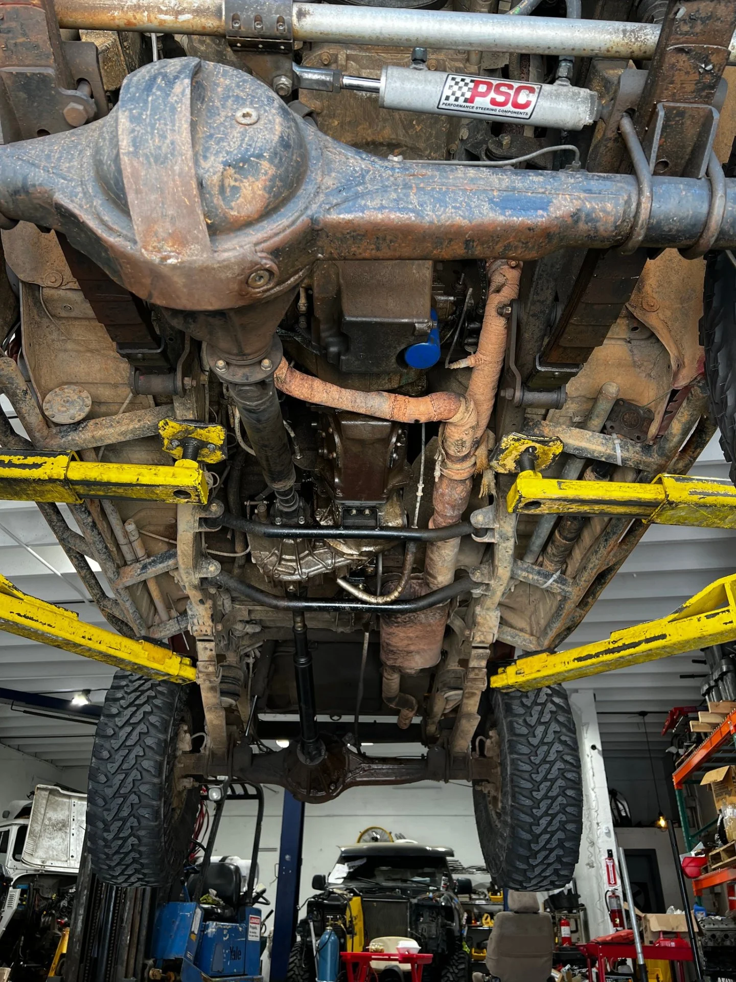

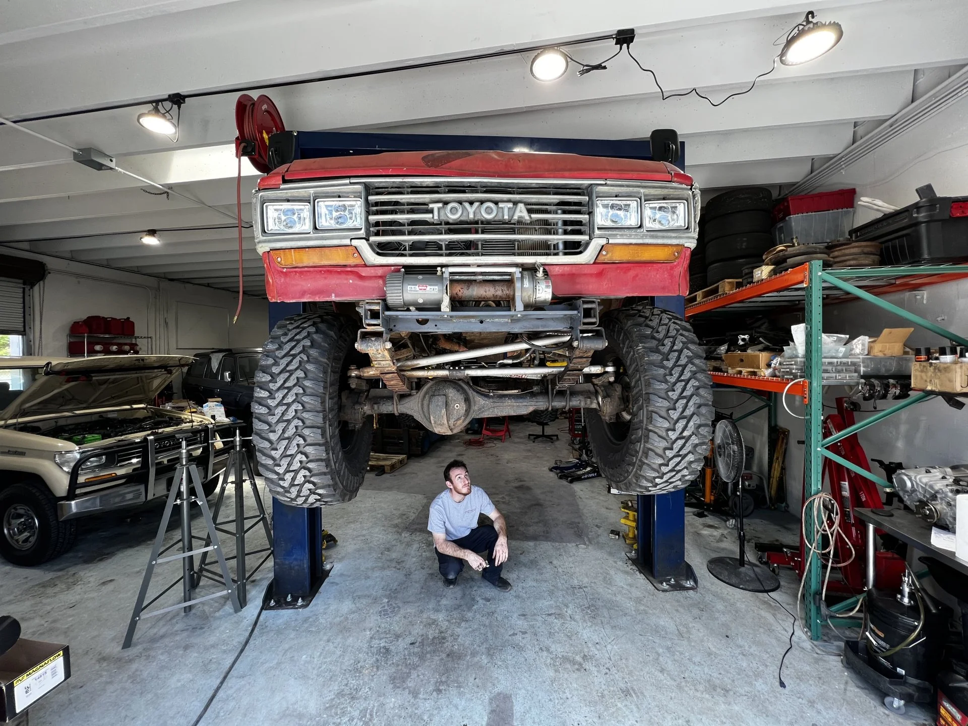

Also put it on the lift today and saw the left rear shock finally broke completely. I would like to redo them with a complete new crossmember assembly. and then cut the original completely out.
For now it drives surprisingly well with only three shocks. :lol: I wouldn't be surprised if it's been broken for a few weeks now.

I'm in the middle of a three week 80 LS swap for a friend right now, as soon as that's done this pig will go into the friend's/family bay and get torn down for a light refresh. This poor truck is in desperate need :(

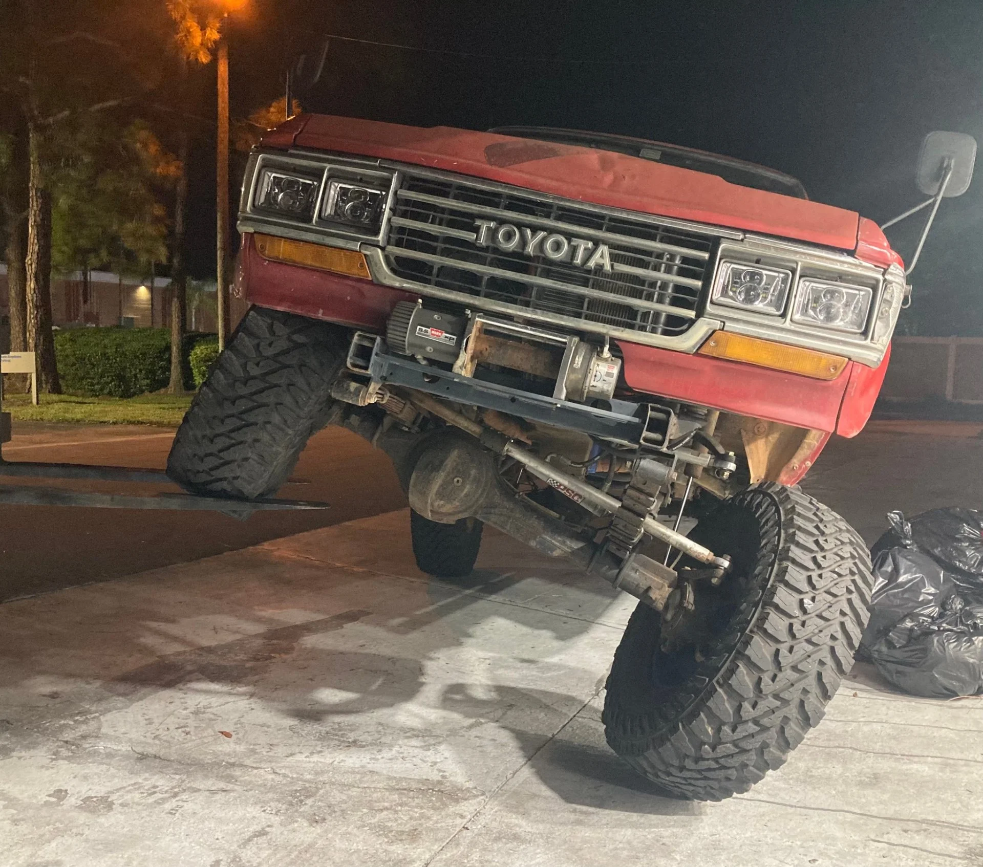

What bump stops are you using? The flex looks really nice,
fronts are 80 bumpstops, same as 60 basically with 1" extensions built-in, but they dont actually line up with the 60 mounting holes, airbags are my rear bumpstops

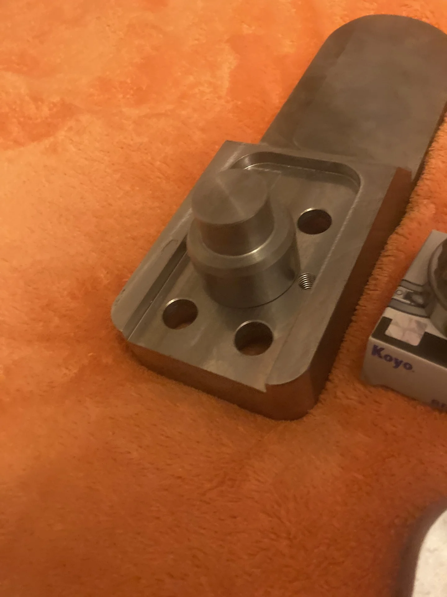

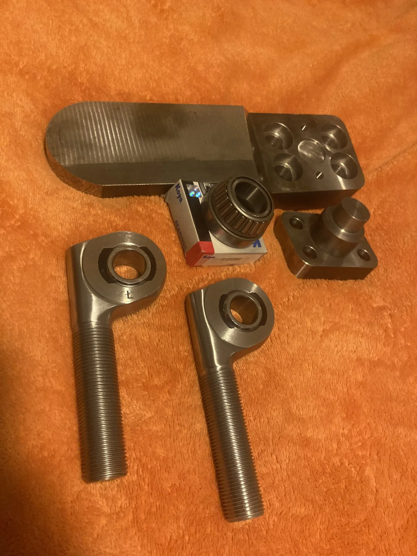

I have not been spent hardly any time or money on this truck or any of my own projects really in the last year or so but some things need to be addressed before this year’s planned summer wheeling trips. Decided to splurge a bit and get some FROR keyed arms, 25mm bearing upgrade and billet lower caps. Also got a full set of offset heims to try, my tie rod rubs the spring plates a little at full lock, and I want to decrease the steering ratio (notice the arms aren't drilled for TRE’s) which would make the issue worse , hopefully these are the Easy Button

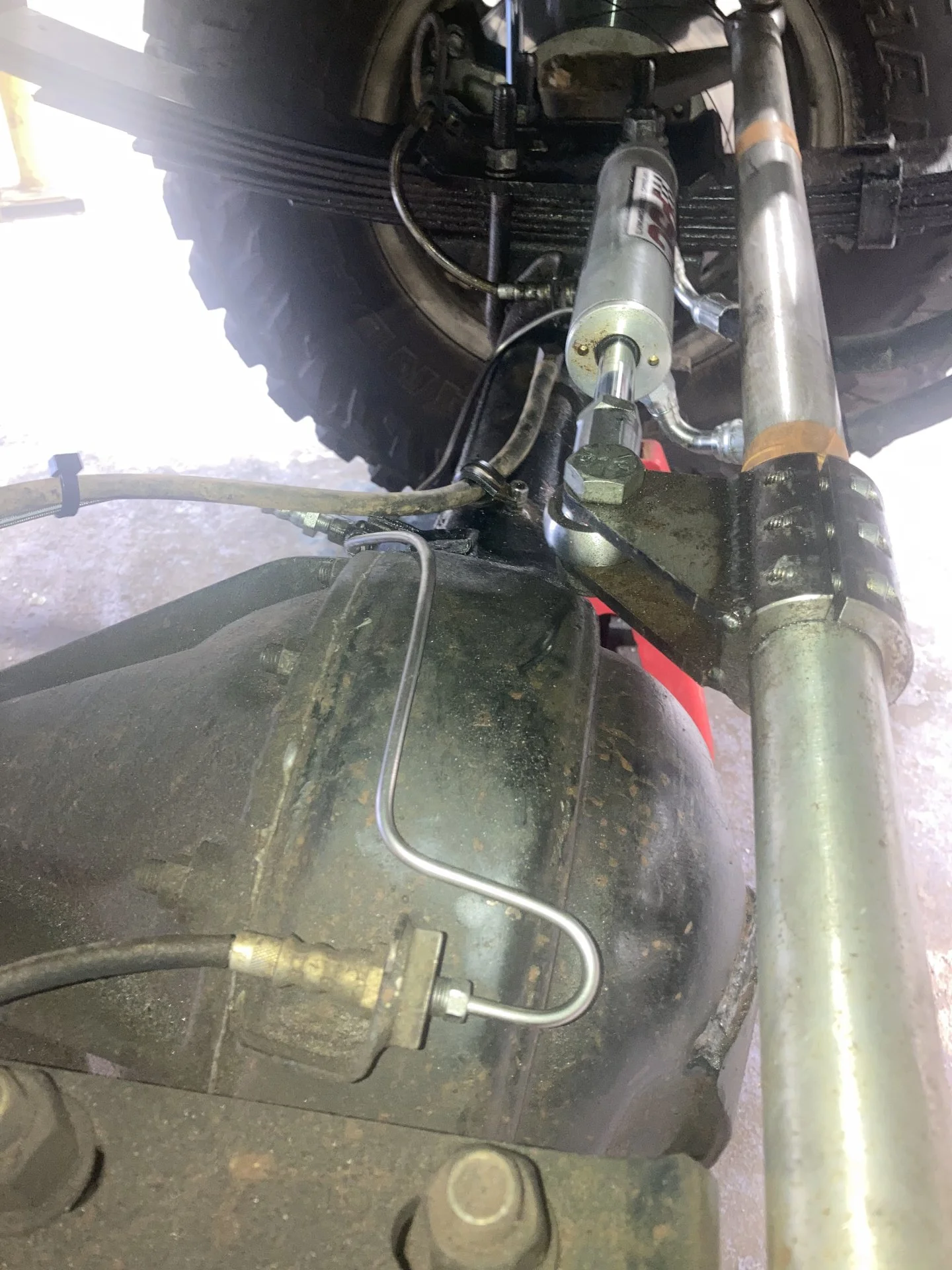

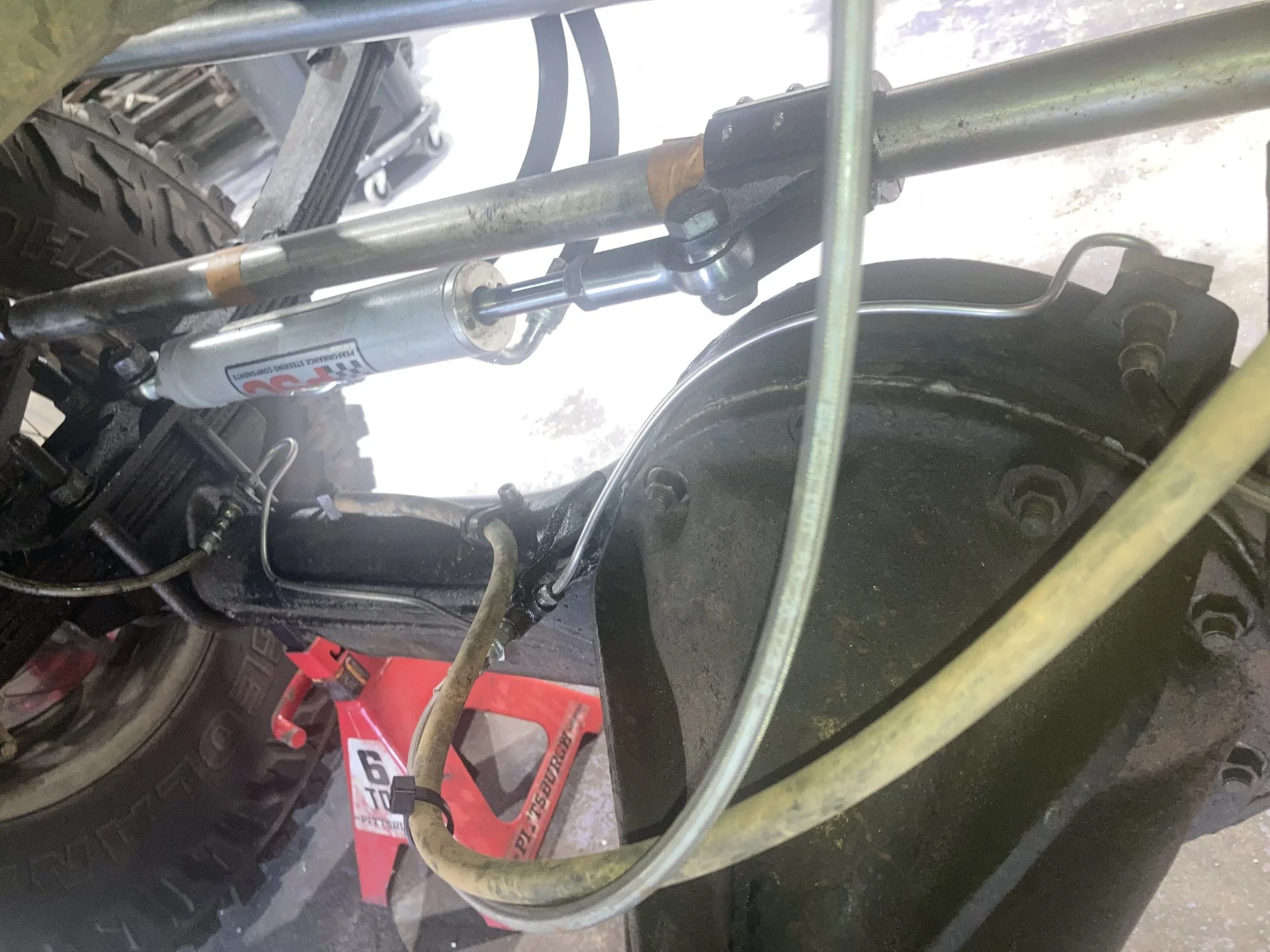

Still haven’t gotten to the FROR arms, but did spend some a few weeks ago and gave my current heims some clearance with the grinder so I actually have my full left turning radius back which is so nice. Also re-routed the ram hoses, and found a I had a crushed brake line so re routed both front axle lines. Used an 80 series brake way I had and moved it a bit lower on the housing. Flipped the ram over and ran the hoses under the tie rod which gave them a much nicer flowyness.
Sorry these pics are awful.

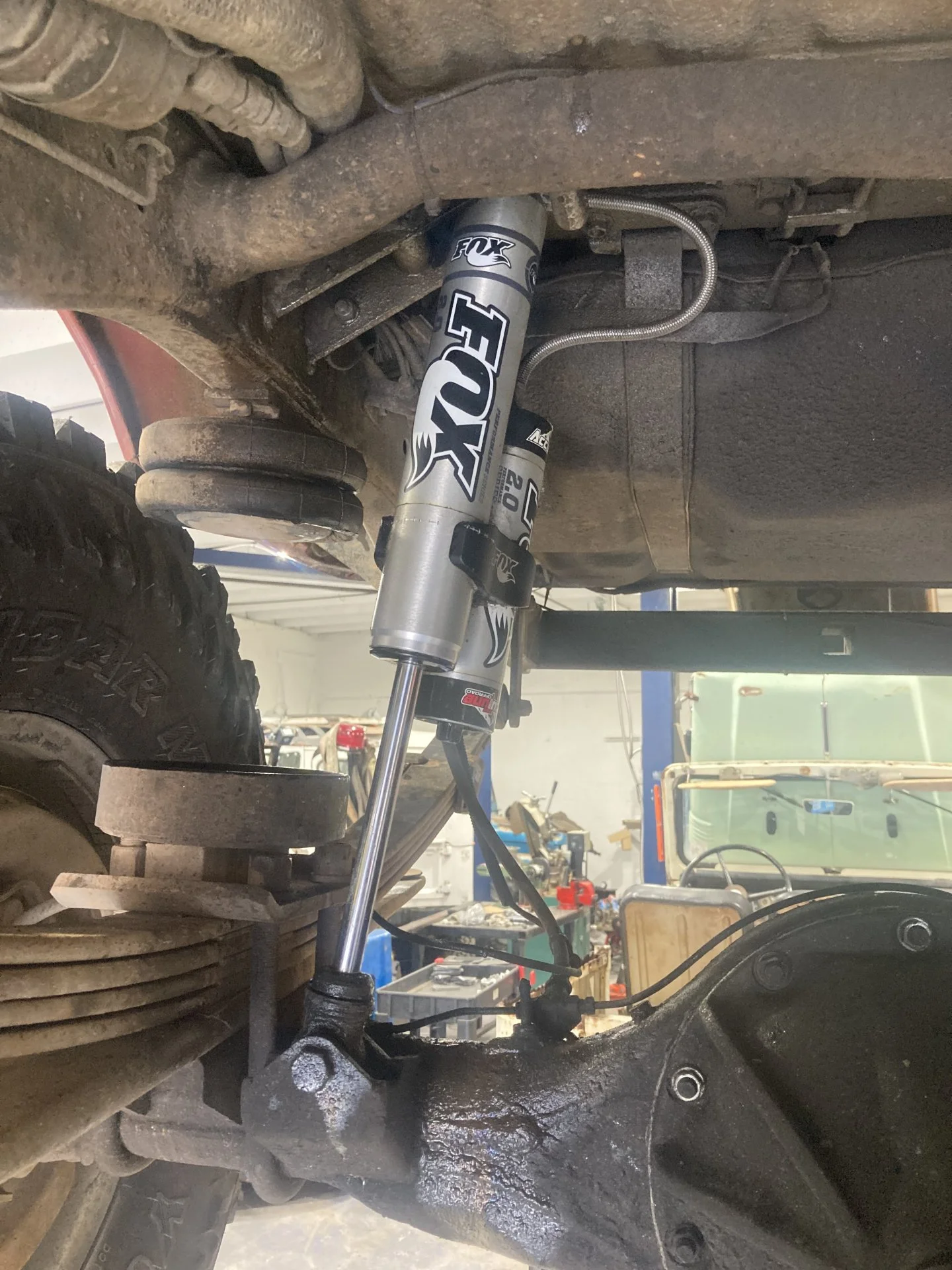

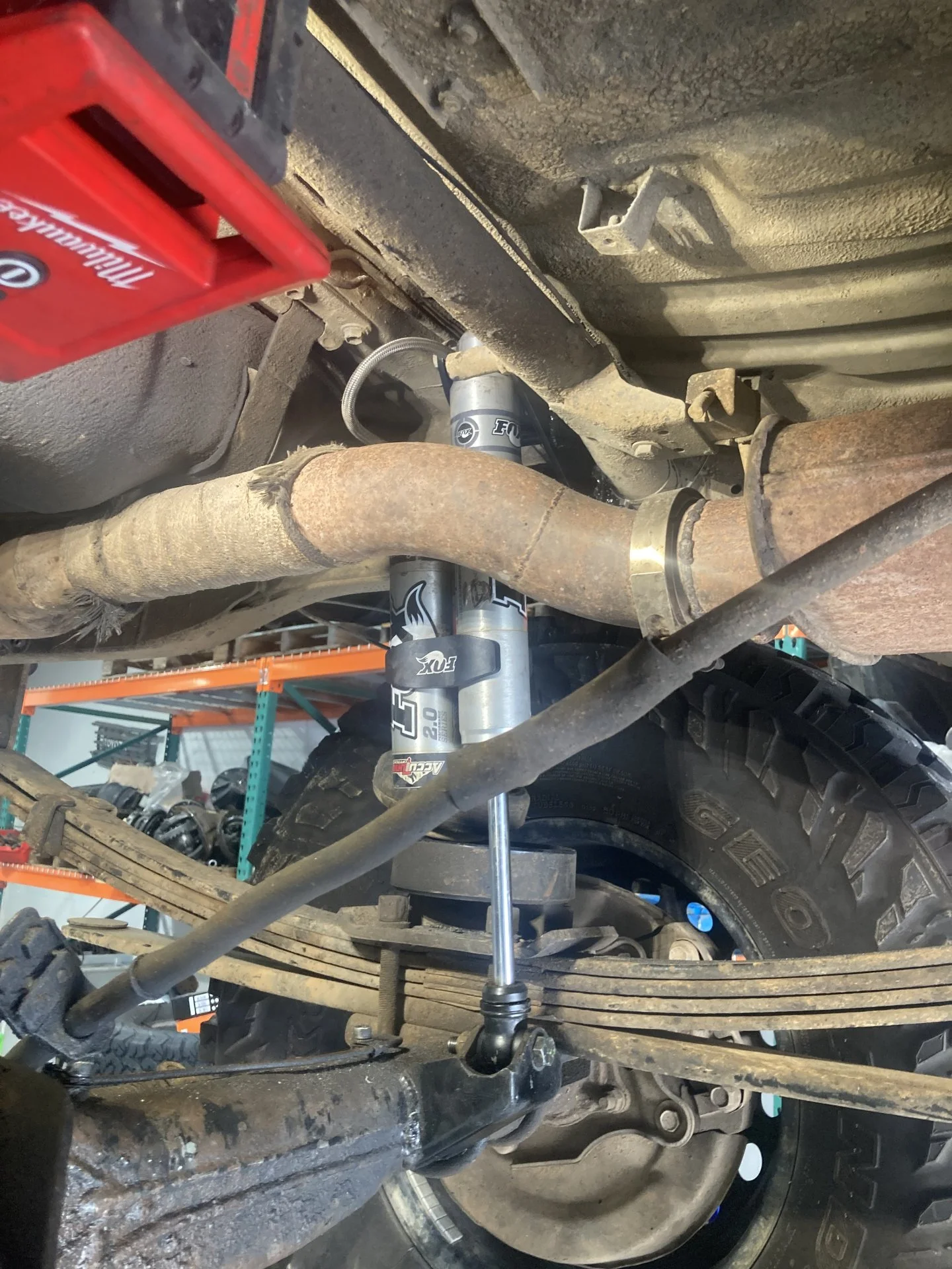

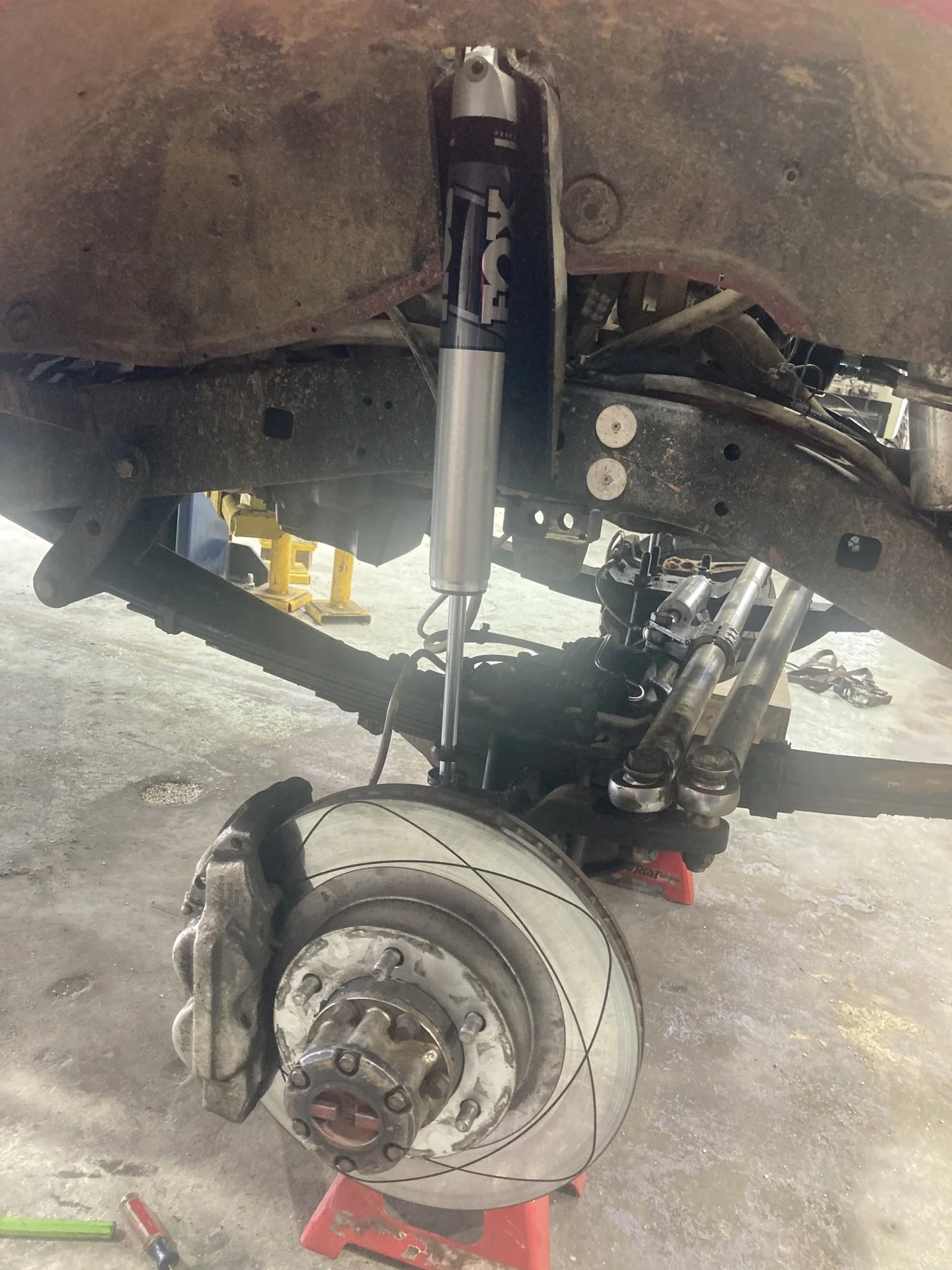

I got a good deal on a pair of 12” Foxes so I did get those swapped on up front over the weekend as well as finally fixing the other rear shock mount that finally let go last year.

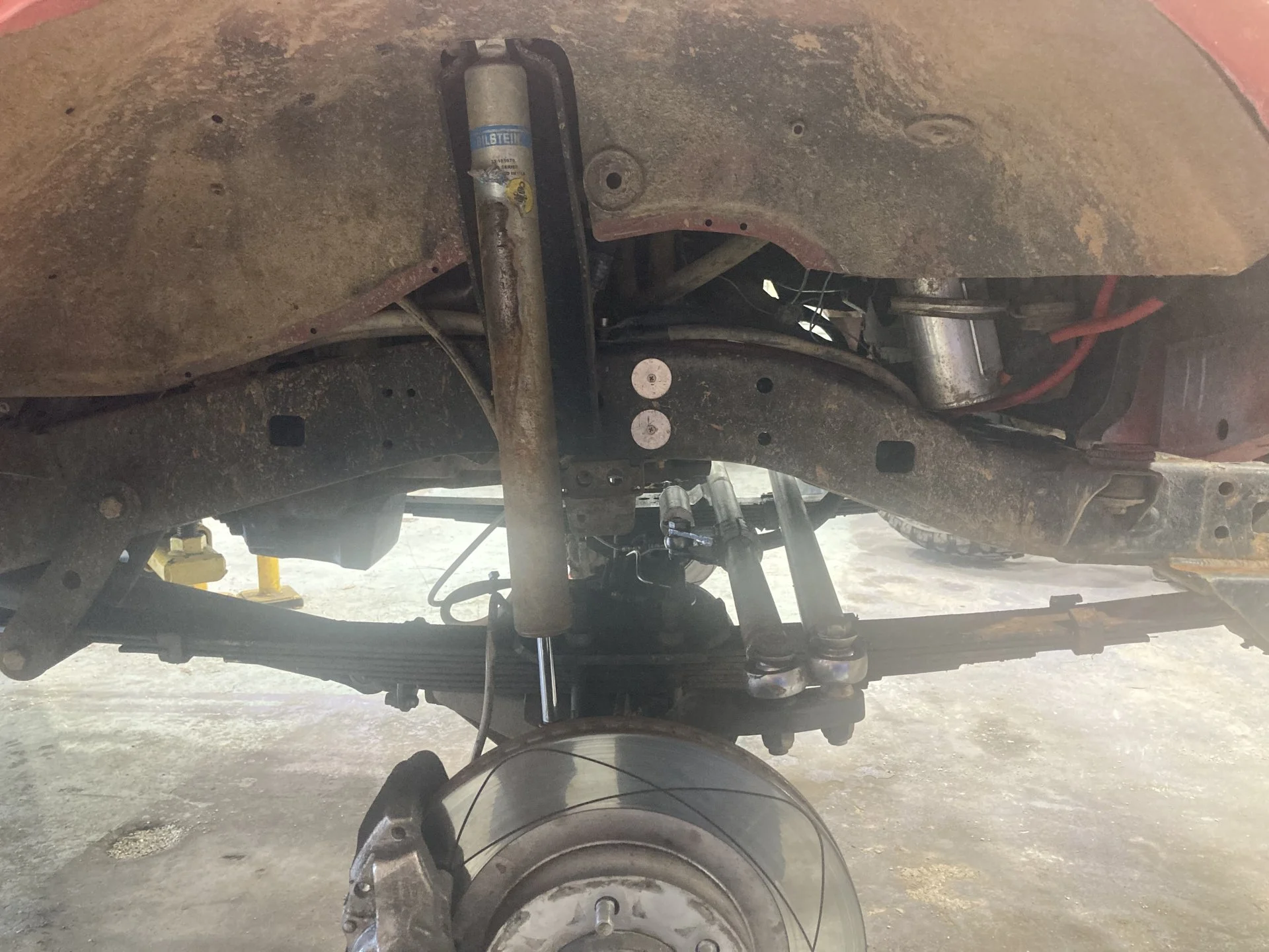

Old front shocks were 14” 5125’s with the regular 255/70. They were good for the first two years or so but after 60-70k miles and a lot of abuse they had gotten pretty soft.
Feels good to go from one good rear shock and two worn-out Bilsteins to four firm Fox’s. :lol:
At some point I would like to replace the front shock frame mounts with a new pair of the same F250 mounts but cut them and angle the upper bolt in about 2”, my tires will occasionally rub the shocks at full flex as they are now

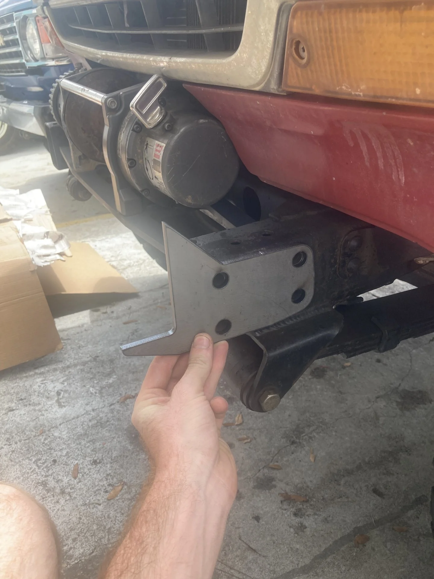

I have a few other fun odds and ends to do, I got a complete set of new JL speakers as most of mine are blown out, I lasered new tabs for my front bumper so I will finally
get that rebuild, going to re wire the winch, lights, a lot of stuff that was really slapped together for the 2020 West trip
