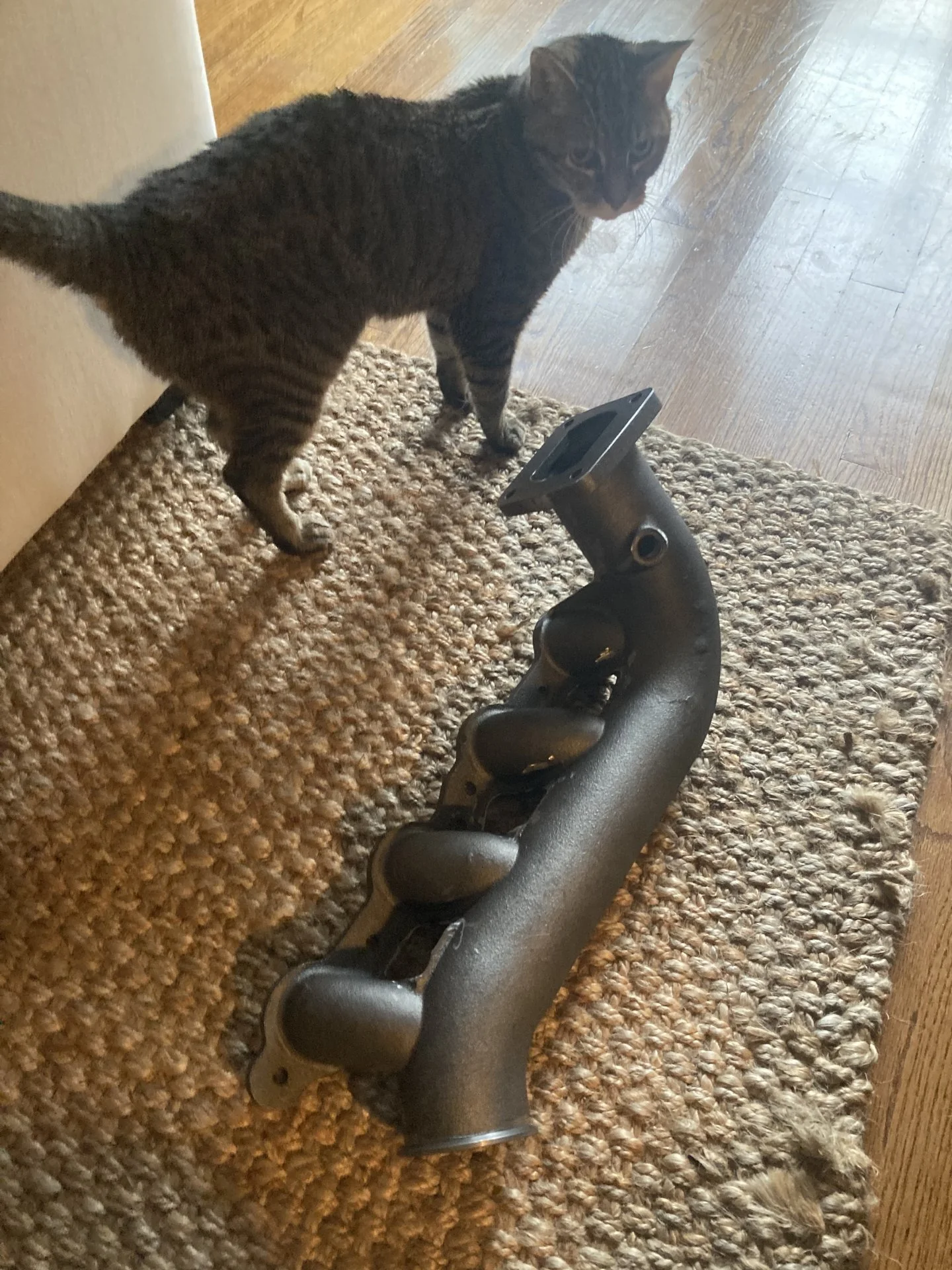

Turbo’s here. It’s a VS cast wheel 78/75 but i choose the smaller turbine housing hoping for a little faster spool up. Also easier to package 3” exhaust then 4”, still going to be tricky to do cleanly though
It’s also going to be going on my $2k Challenge 4.8/Th400 BMW temporarily, currently have the same turbo on that but with the bigger 1.25ar turbine housing. That turbo needs to go back to another project so this one will be a placeholder until i decide my next plans for the car

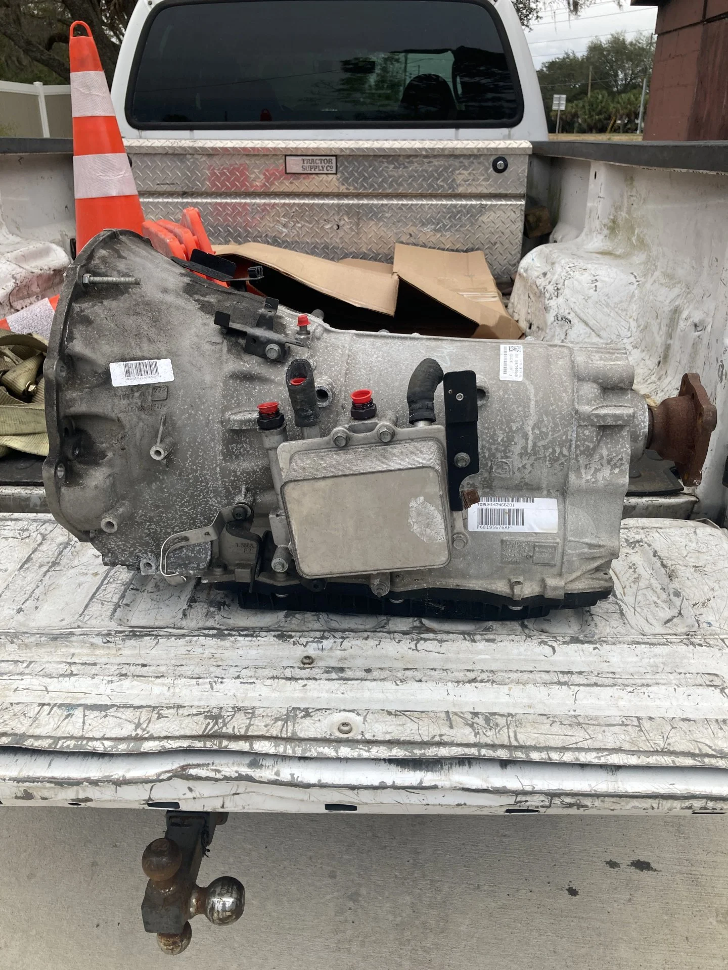

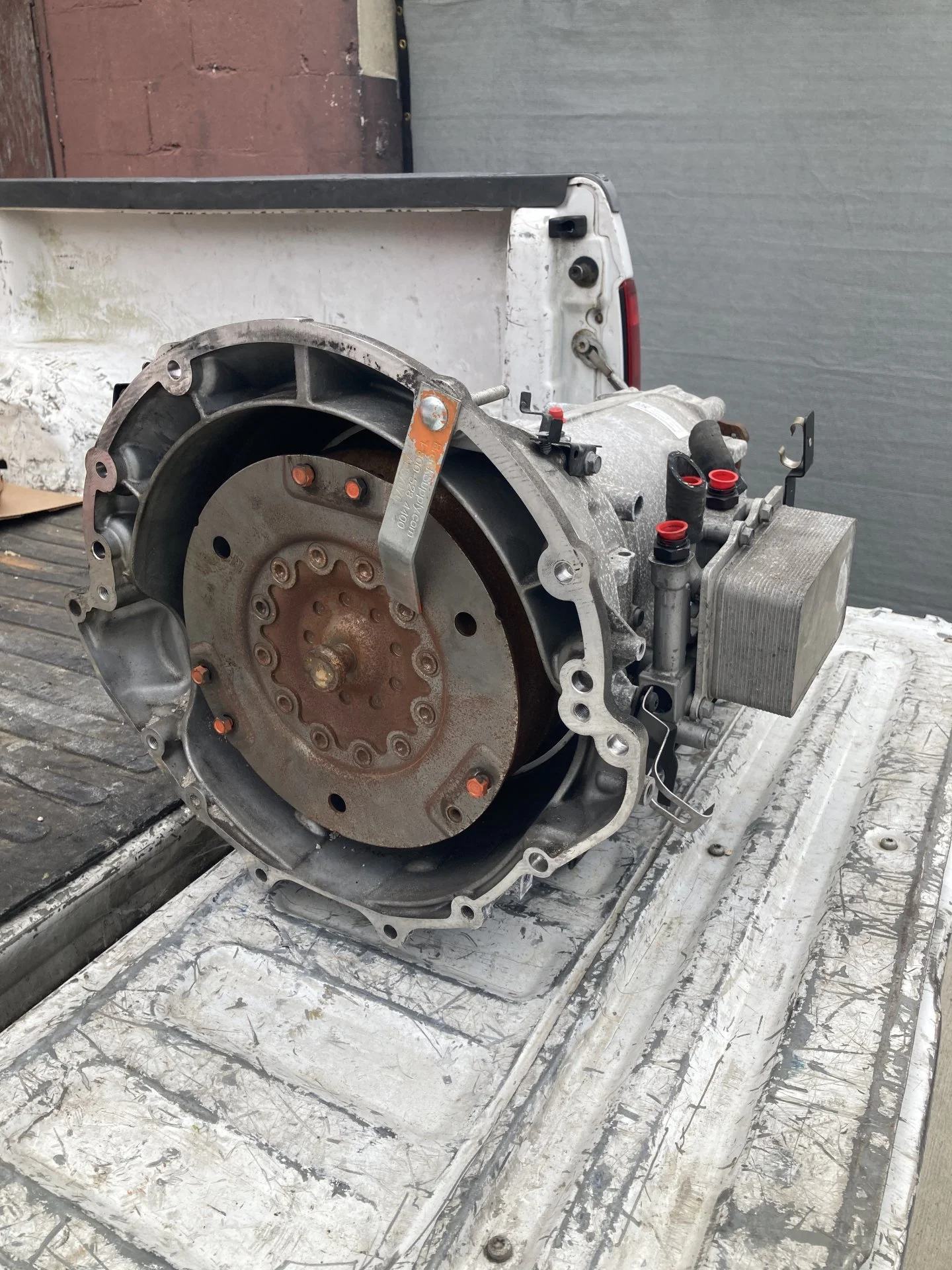

no one even asks what the hell the transmission on the tailgate is :lol:
I've been trying to figure it out, but I'm failing. Allison?
Some 2wd version obviously.
That looks like a ZF logo. Gonna be some craziness going on if that's the case.
ZF 8HP craziness indeed
Yeah, it’s a ZF 8HP-70. Out of a 2016 2WD Ram.
I actually need the 4wd version to work with the Axis adapter. But this one was cheap enough to just buy to check out and get a feel for. I also want to see how the Hellcat converter compares dimensionally and if it will fit.
Maybe I’ll try to convert this one to 4WD, I swore I’d quit doing stuff like that though.
