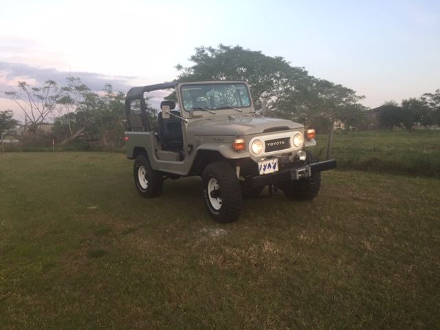

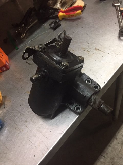

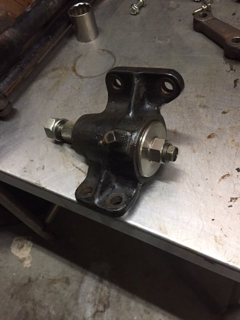

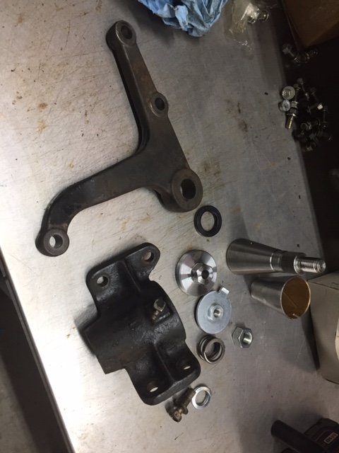

Eric's FJ40 came in with loose steering, leaky box, poor brakes, and desperately needed some engine bay cleanup. All new 555 tie-rods, drag link, relay rod, center arm rebuild, steering box reseal, new rag joint, alignment.. and 4-degree caster shims to correct the negative caster from the long shackles o_O. Needless to say the handling is much improved. Also rebuilt the leaking rear drums, new brake master, booster, front pads, etc. I did a knuckle job on this truck last year too. Tidied up some vacuum lines and fixed a few leaks. It runs amazingly with a Jim C carb and recurved distributor, now steers and stops just as well.

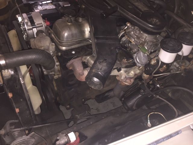

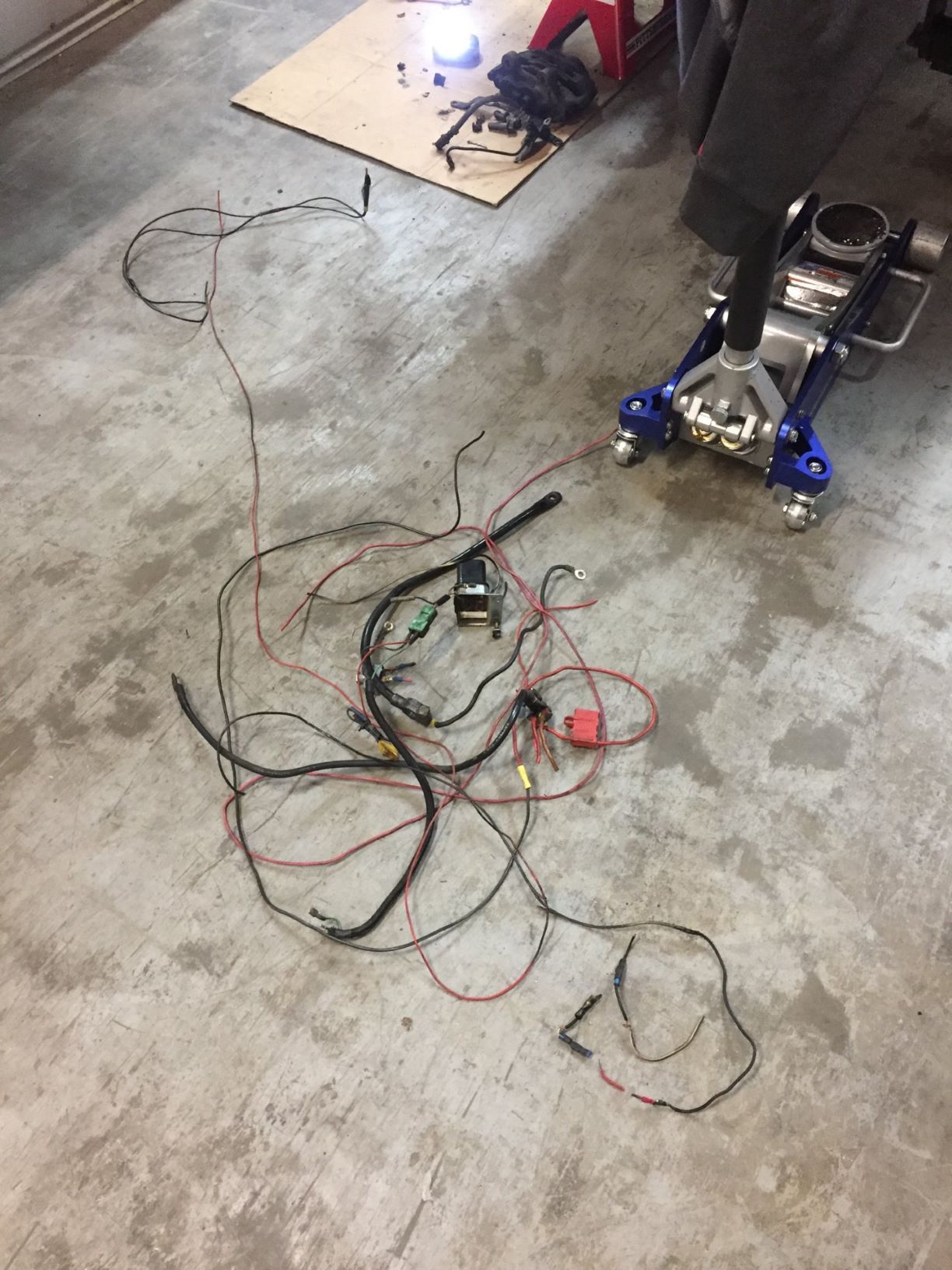

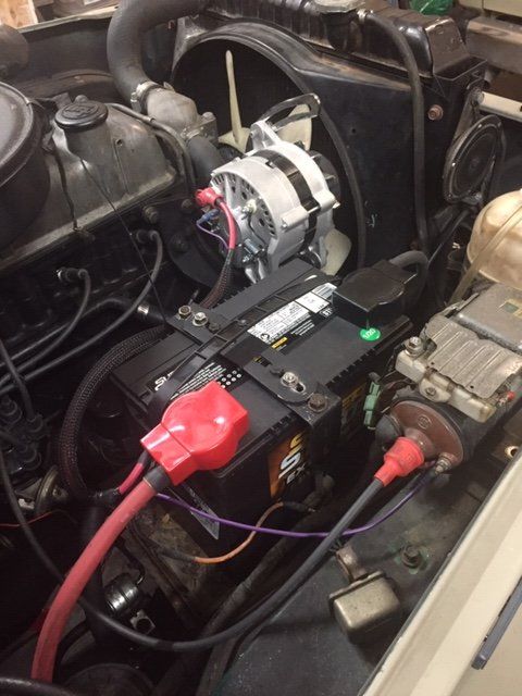

Also did on FJ60 alternator swap and new battery cables, and ripped out bunch of PO wiring.
Nice and tidy now.

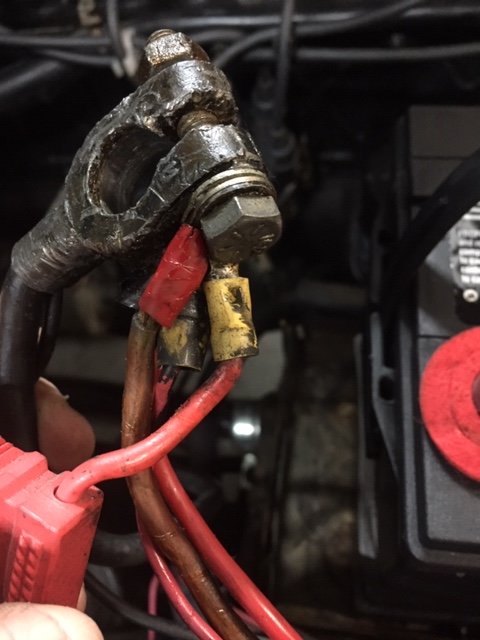

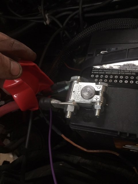

I really like using these mil-spec battery terminals. The majority of electrical issues I see on older Cruisers stem from poor connections at the battery.

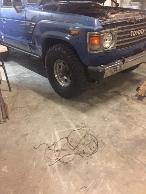

How it looked before o_O

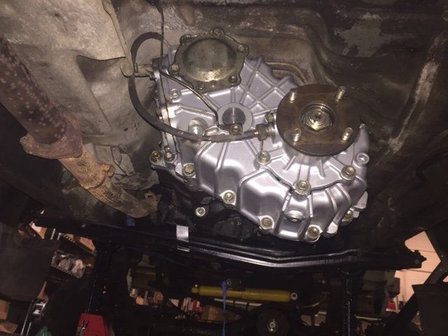

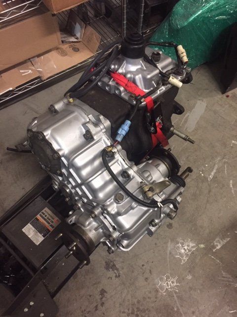

Transmission/transfer reseal, new clutch flywheel resurface, rear main, on Curtis' FJ60 @CurtB

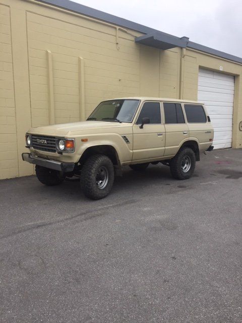

Got this 60 in now for some general fix-up.. fixing some typical PO farm repairs
I usually start by ripping wires out. :)

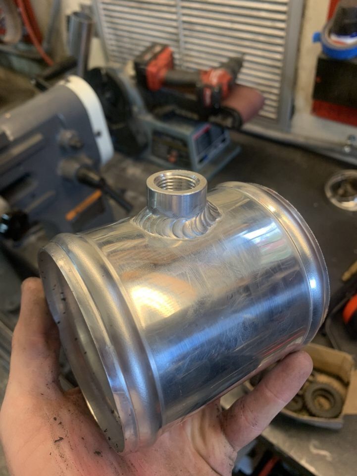

Quick Cruiser break to whip up a intake tube section for my friend's LS1 swapped 240z
Bead-rolled and welded in-house ;)

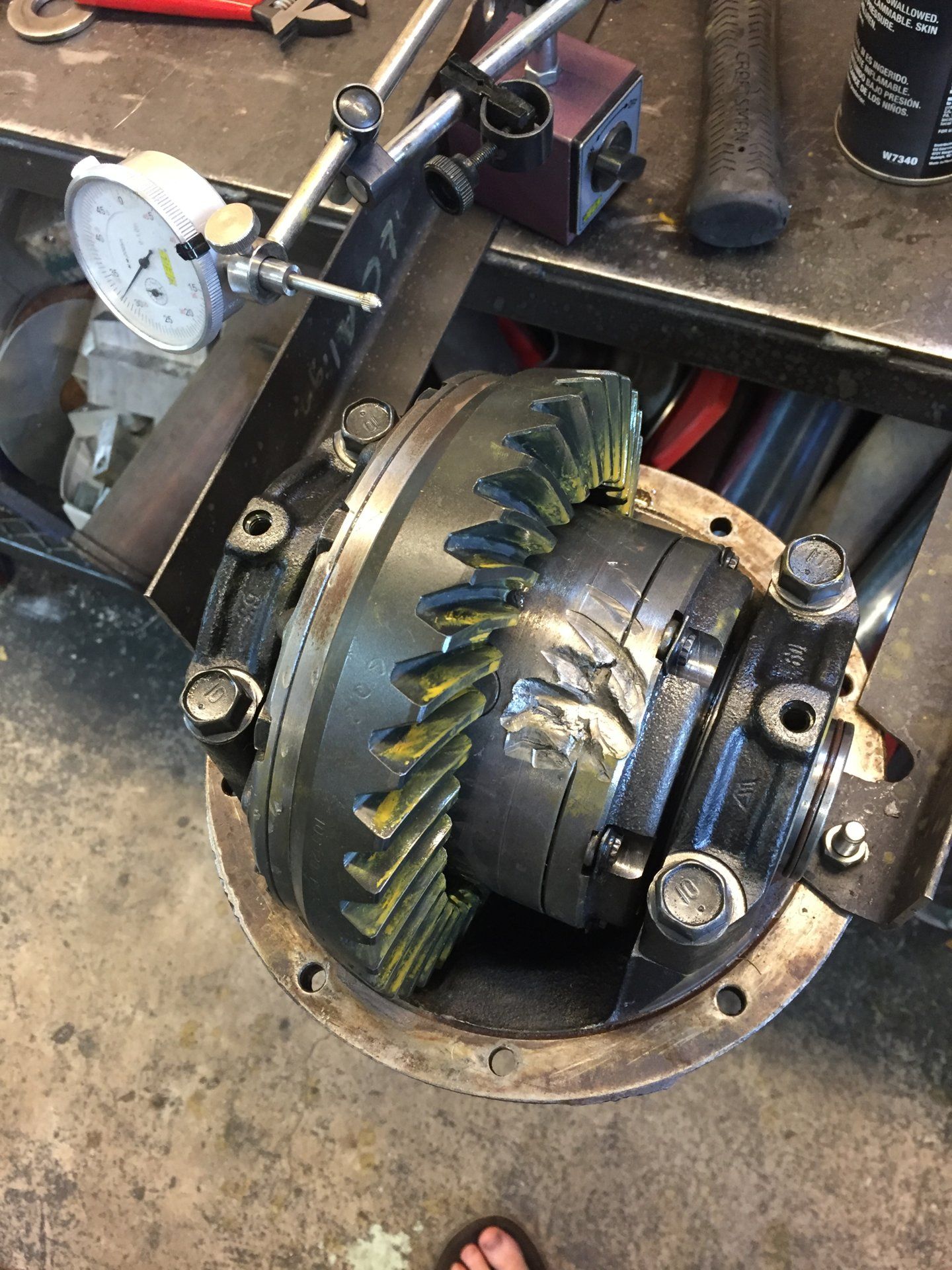

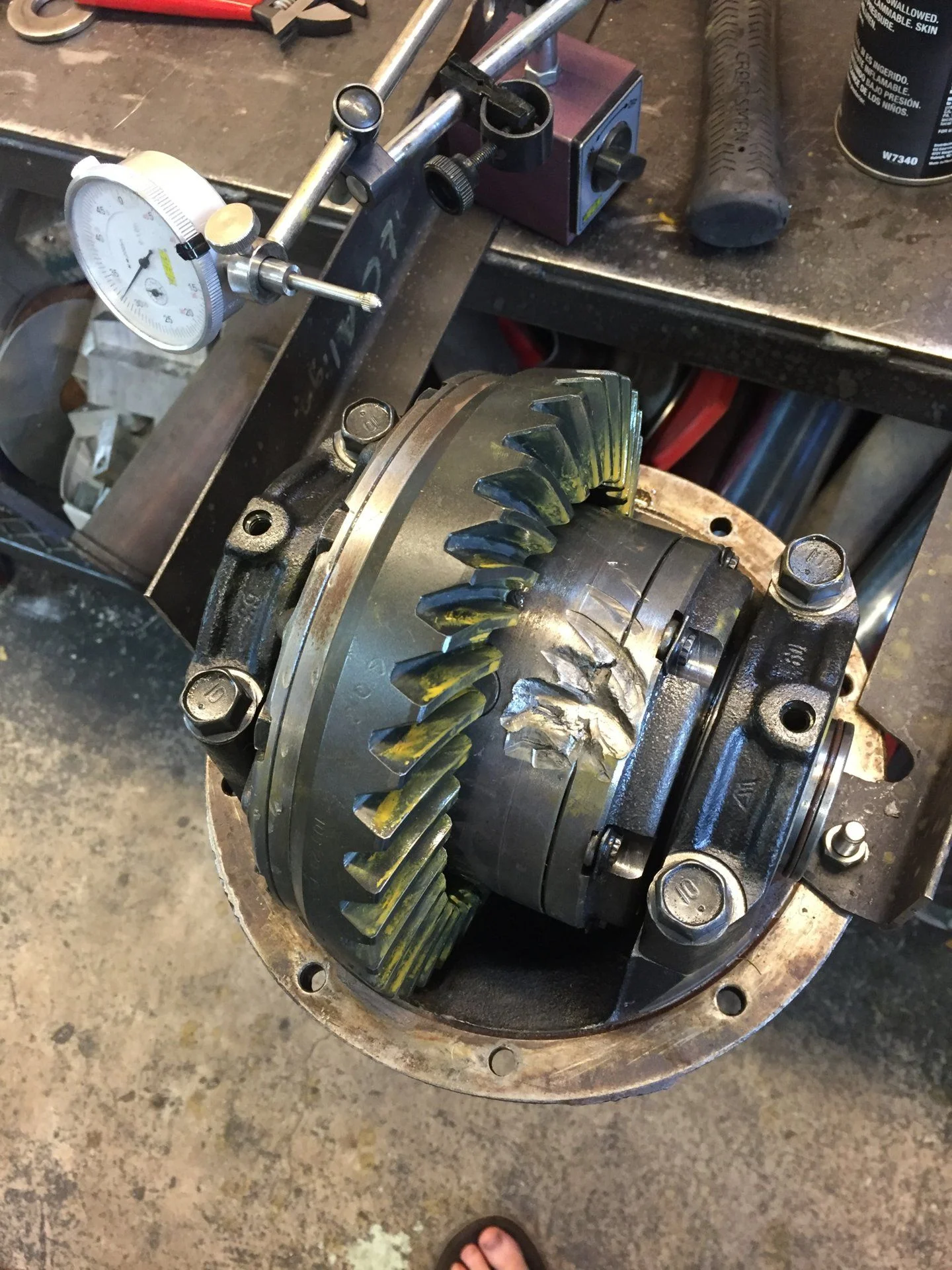

New front 5.29’s for @Oscar Witte after he grenaded them pulling my friend’s Jeep out of a mud hole. For everyone else don’t pull in reverse with an 80.. bad for front hi-pinion diffs. Check out the chunk in the ARB, it still works too!
