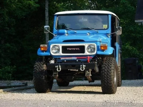

This makes me feel better about my final decision. I went with a set of BFG KM2's after doing a lot of back and forth with the pros and cons. Ultimately this is still my daily driver (wife, two-year-old and twins on the way :)) and based on all of the great feedback/advice the swampers weren't going to be worth the trade-off in my case.
Well I can still run a set of big, nasty, bias ply swampers on the 40 that I own in my mind :D.
I almost forgot. The tires are expected to arrive tomorrow. Of course, I will post some pics when I get them mounted.
