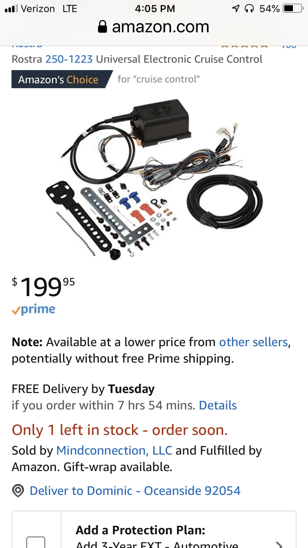

Rostra Global Cruise
#250-1223
Universal add-on electronic cruise control system by Rostra

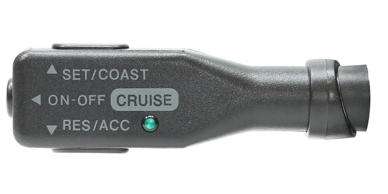

Rostra switch #250-3742

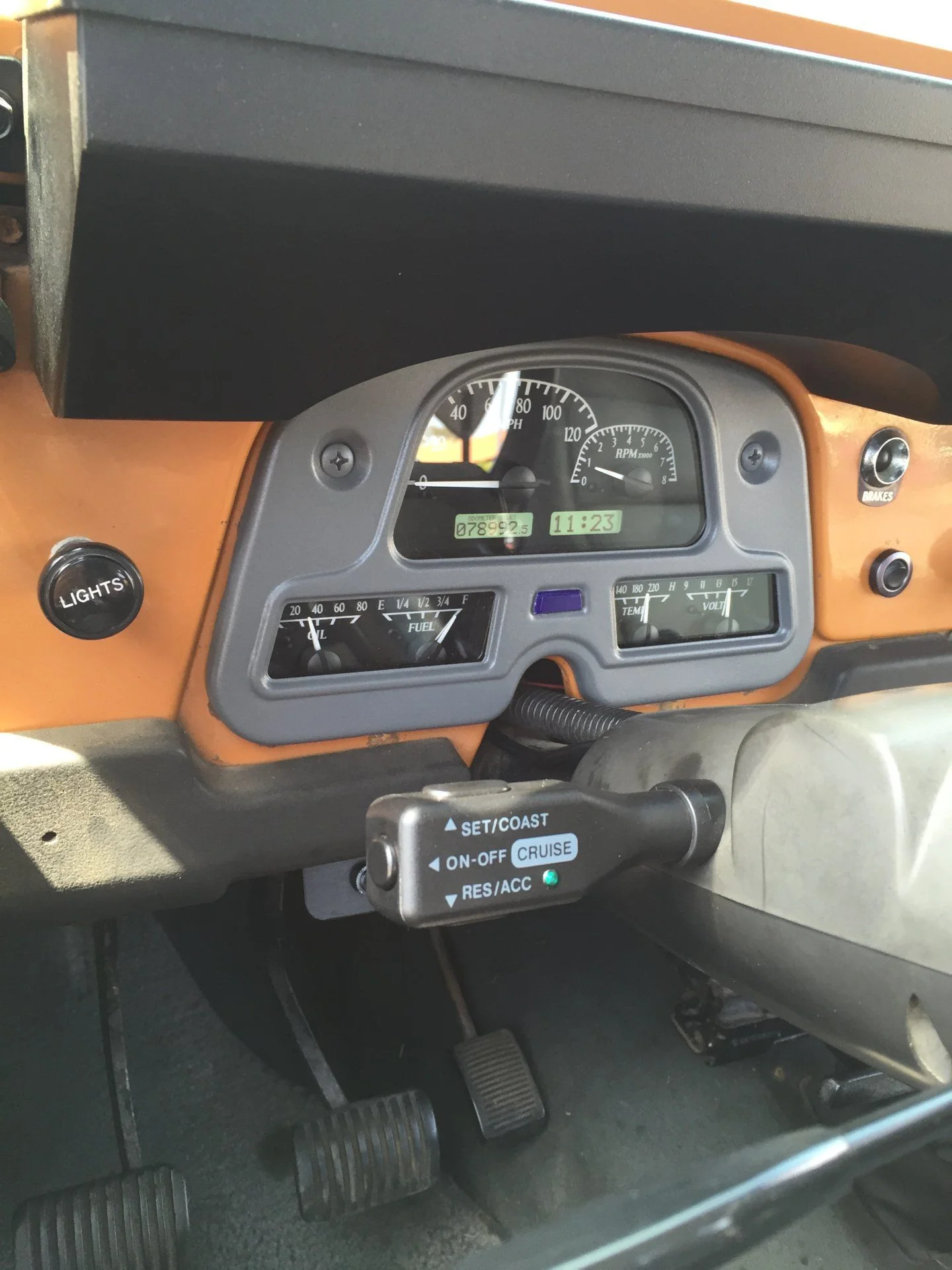

Pretty simple setup. You have to set some small PINS to dial it in. I got pretty close to perfect but it will drop out now and again. If I had more time I would close the loop on that. For the amount of time I use it it hasn’t made it to the top of the list.
I’ll dig up a few pics.
Switch installed. I removed the column cover and drilled a small hole. Wires run up along the wiper switch wiring on the top of the column...

I ordered everything from Amazon.
Do you remember about how much the whole system cost ya ?

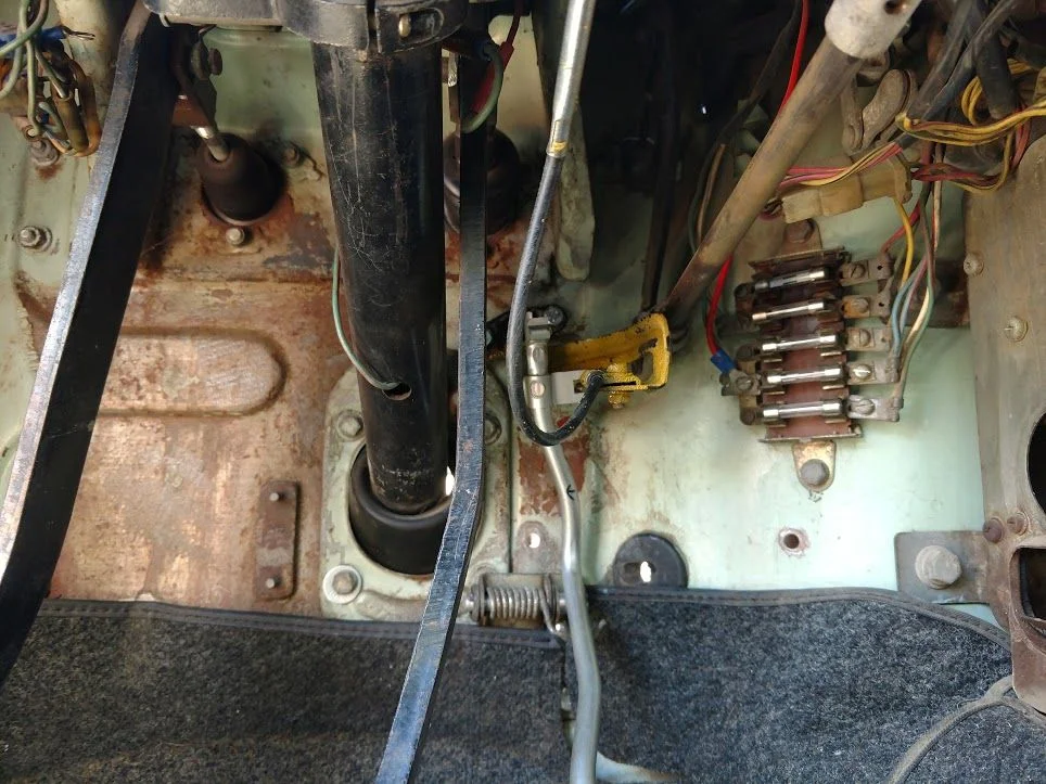

My 1967 FJ45 for last years Road Trip from Calif to Minnesota worked great through the flat States LOL
I have what Rob has on my 45 now. It worked ok with the original motor and mechanical linkage with worn out springs. As soon as I put the 3FE in the throttle springs have way more resistance. I even pulled the spring from the pedal because the pedal resistance is uncomfortable. The hand throttle won’t stay pulled out against the throttle setup I have now.

Here’s what I bought. Be sure it fits your application. There are left and right stalk switches of various types.
