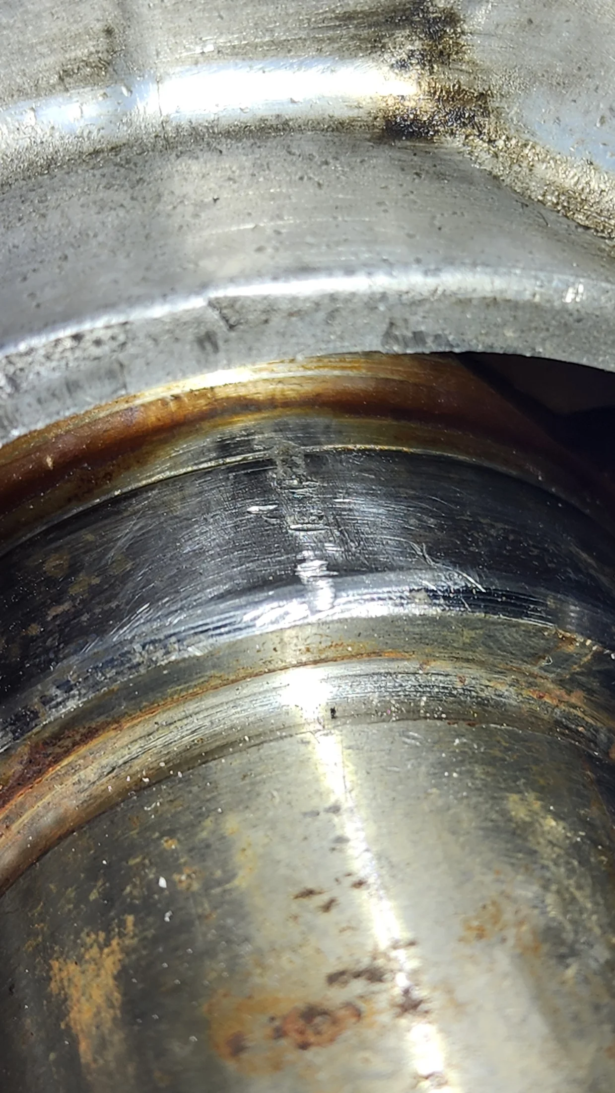

So I did the one thing you should never do, and scratched the crankshaft where the crank seal mates on the front. I was doing the timing belt water pump job and figured I'd replace the seal while I was in there. Dug into it when the screw slipped and hit the crankshaft.
Any suggestions? Too deep to polish out? Take it to a machine shop? Just play it safe and have Mr. T throw in a new crankshaft?

I can't comprehend how a screw "slipping" could cause that damage. but that said, It kinda looks like where the lip rides has the least damage.
You could clean it up best you can making sure to get any burrs that rise above the surface and try it.

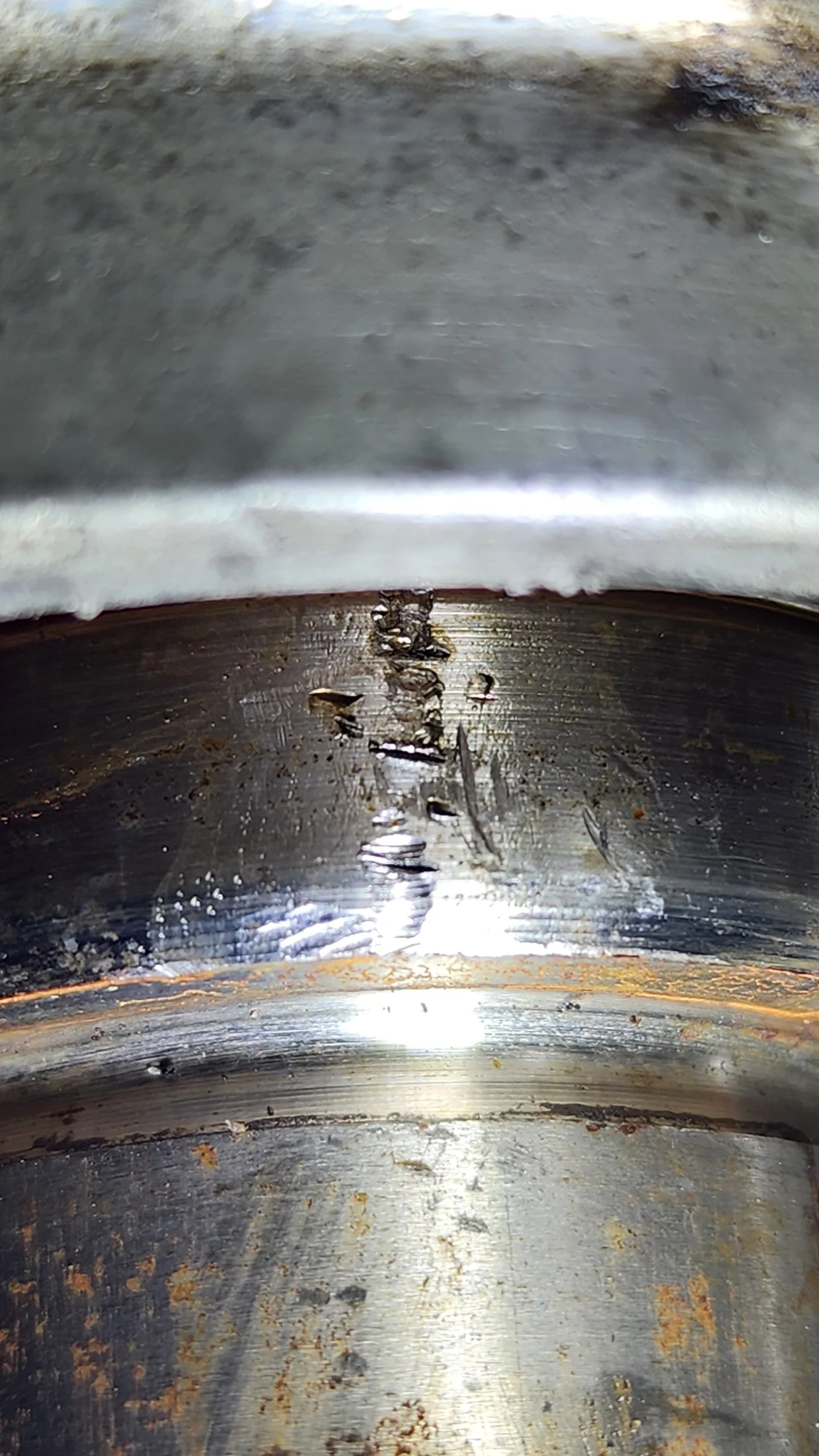

Above photo is a better look at the scratches that I created.

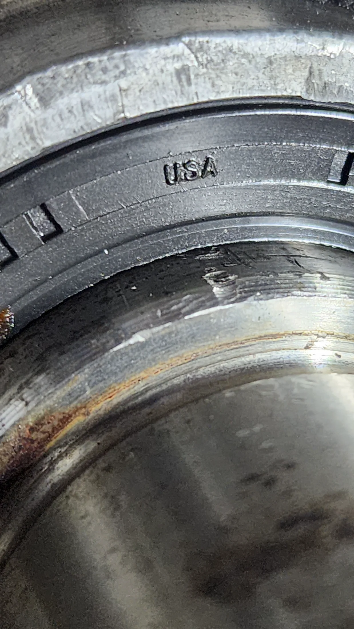

Below is after using emery cloth to make sure no high spots and smoother.
Plan on installing the sleeve when it arrives Monday.

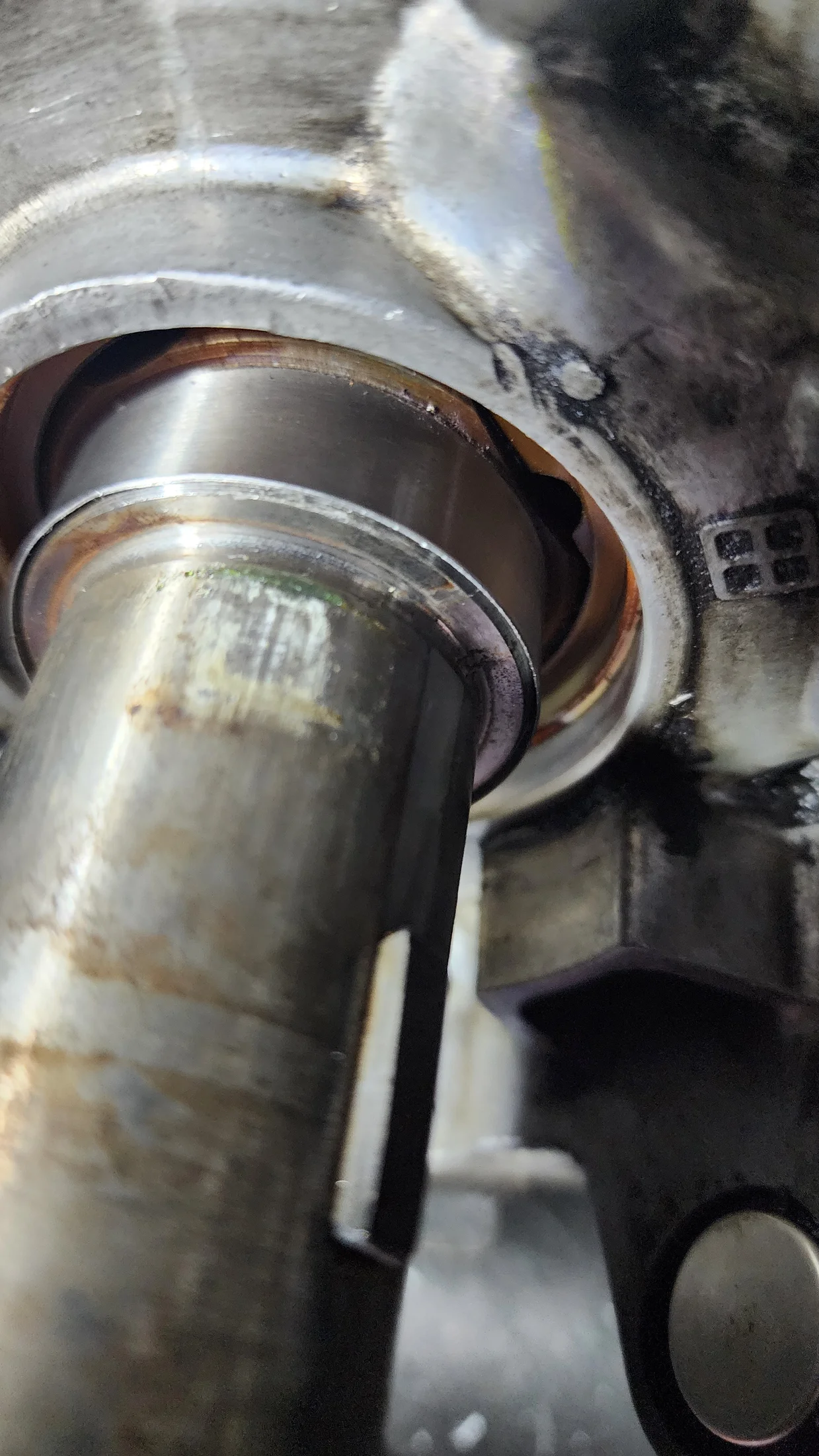

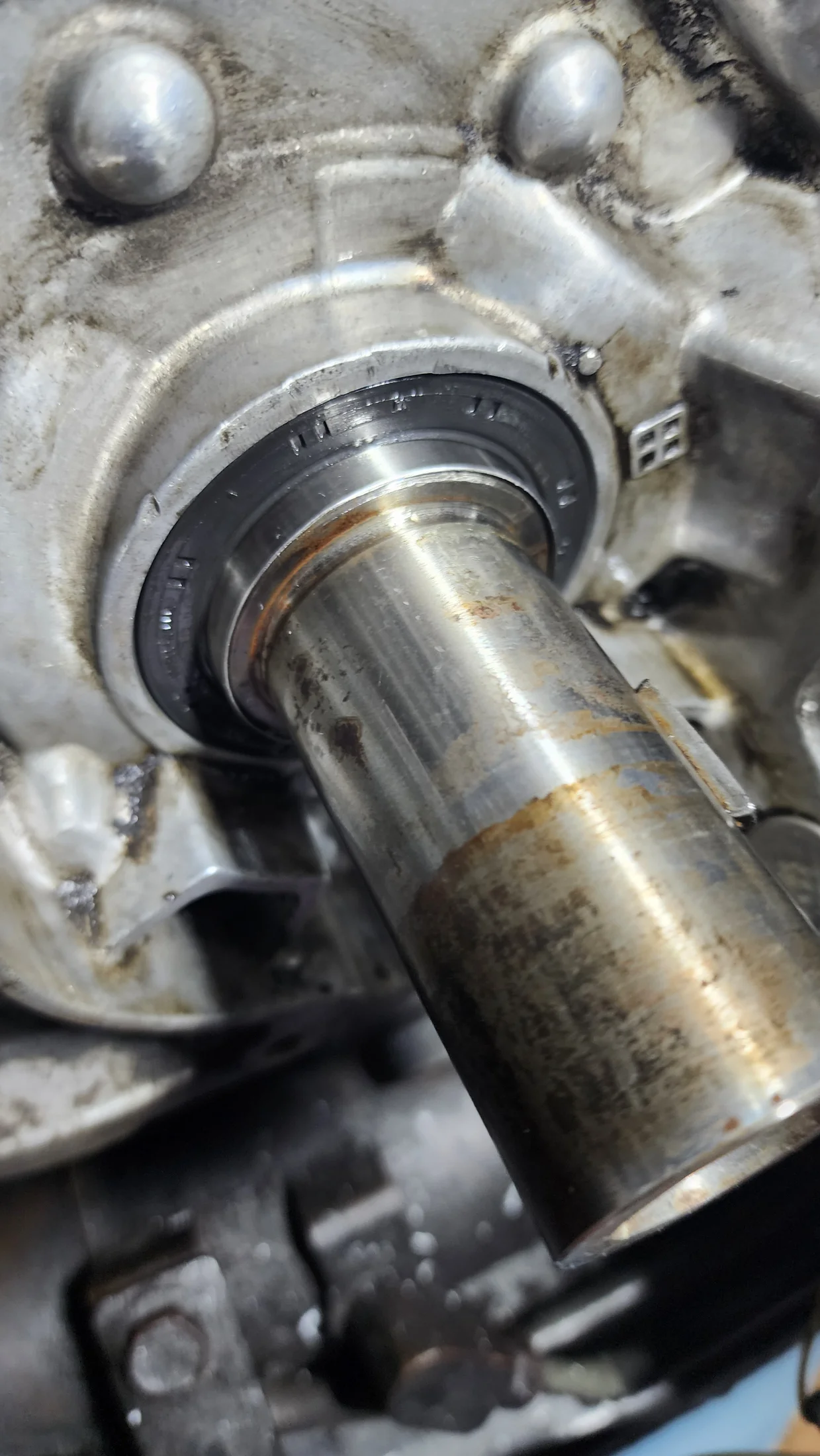

Sleeve installed
Had to use double timing gear to get it on
Seal was a little tight getting on but no issues
