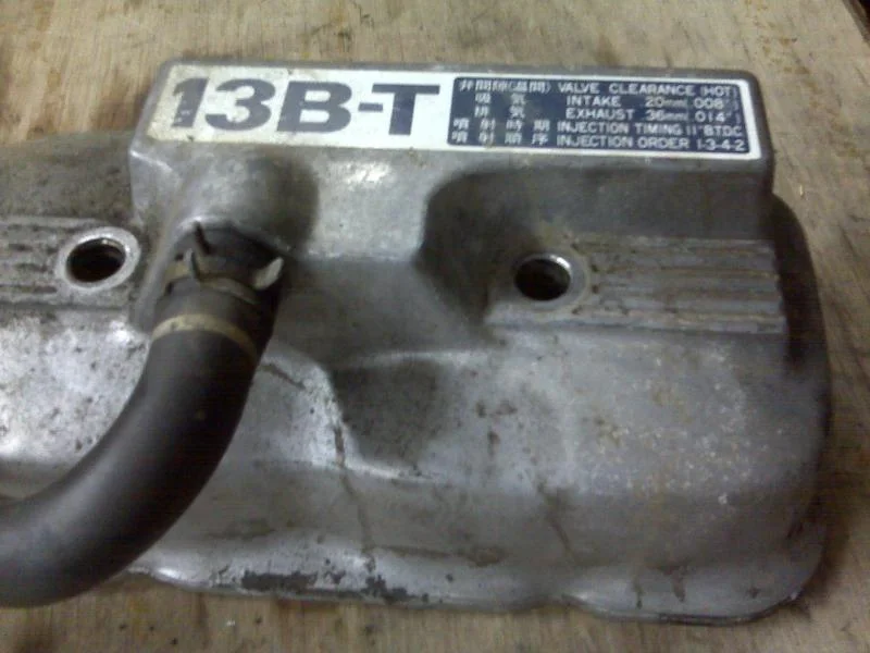

Oh, I forgot the later versions of the 2H also have the same arrangement. See the small tube directly from the valve cover to the venturi. Lots of negative pressure there, I'd imagine:
Here's the vent location for the 13BT:
