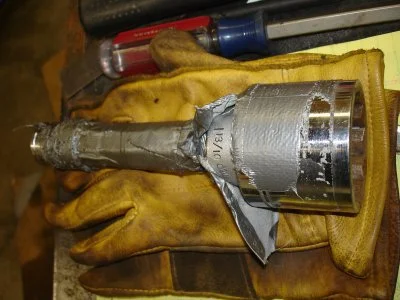

has a 1/2 inch drive socket banging around, size 22, took measurements down to a local hawk shop and picked up a 1 13/16 in one inch drive. fitted a steel shank between the 22 mm and the 1 onch drive with the grinder. put them together and have used it for about 18 years now on f engine crank pully nuts. the 2f nut should be the same as the f engine, but i am not sure, measure it or just buy the 42mm as suggested.
