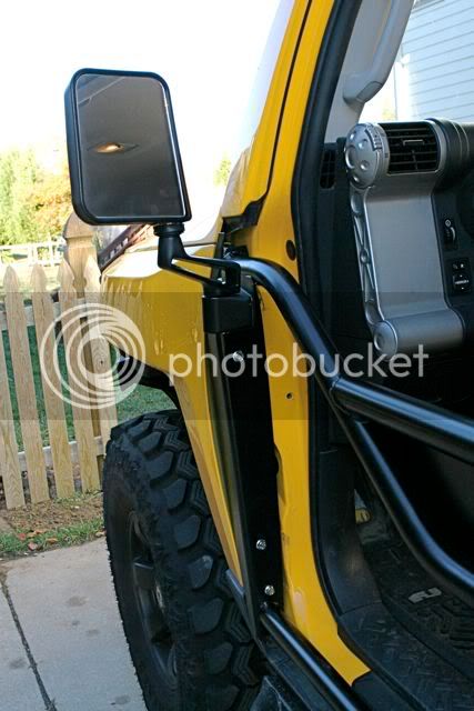

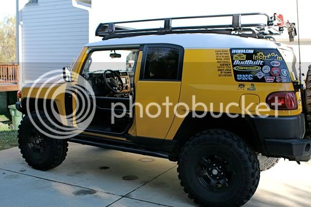

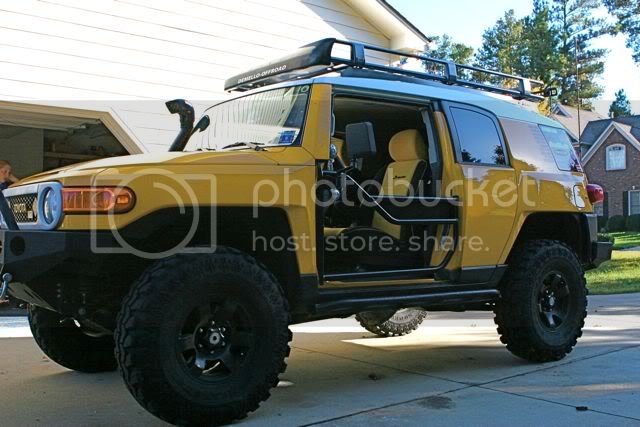

MetalTech had these on display this past summer at the FJ Cruiser Summit II in Ouray CO. They looked to be well built and an easy enough design to be a relatively easy swap back and forth. Well, they had their first run completed and somehow got in on it. They arrived yesterday and couldn't help myself to throw them on this morning. Sure was fun running around town today and I just hope the weather holds long enough so I can run them at URE for the Dec 6-7th event.

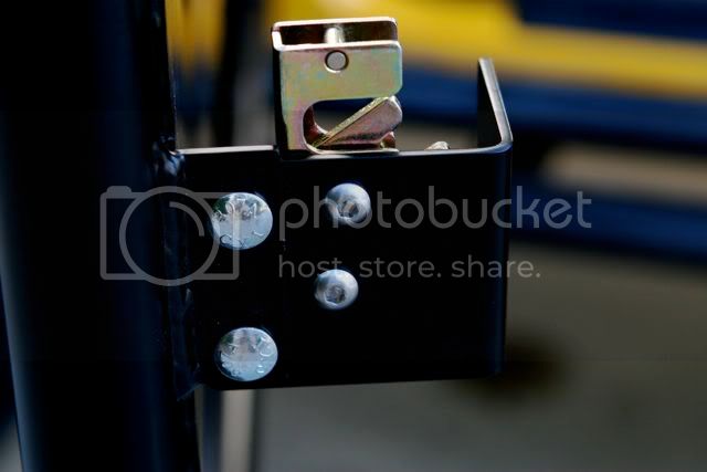

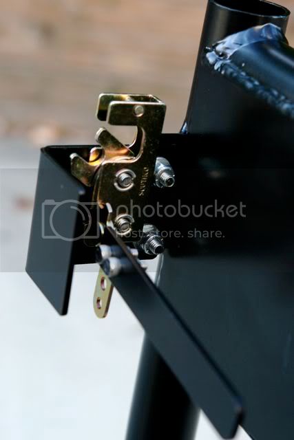

Really easy install, just snap off a couple pieces of plastic to get access to the connectors for the door. Four bolts for the hinges, one for limit "strap" and 2 "torx" screws for the door latch on each side and the stock doors are off. Once I installed all the latch hardware to the tube doors, just bolt up the hinge bolts, screw a striker into one of the holes from the vacant door latch and all is done. Even the alarm still works, just can't lock them.
Enough words, time for the pics...
